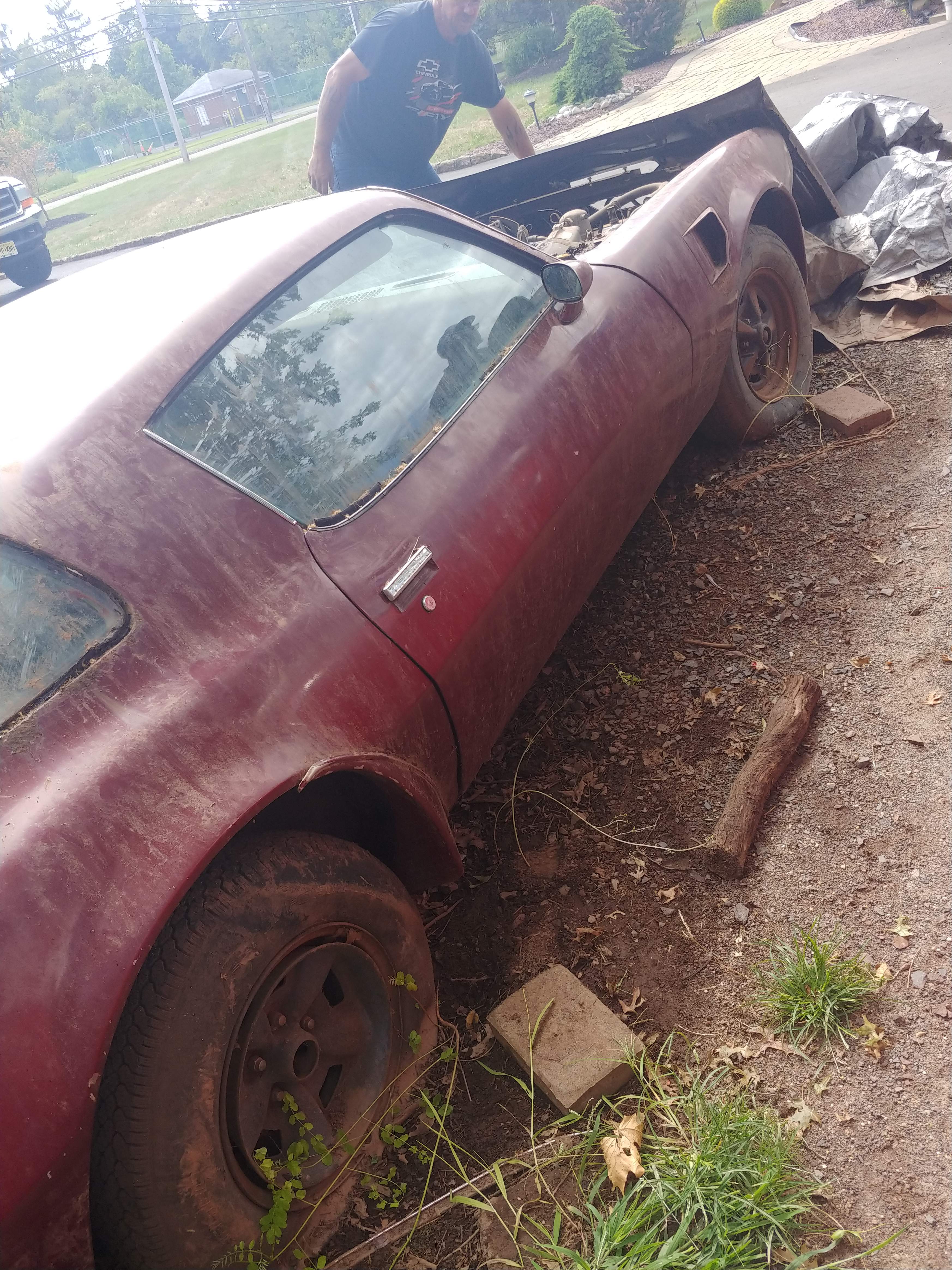

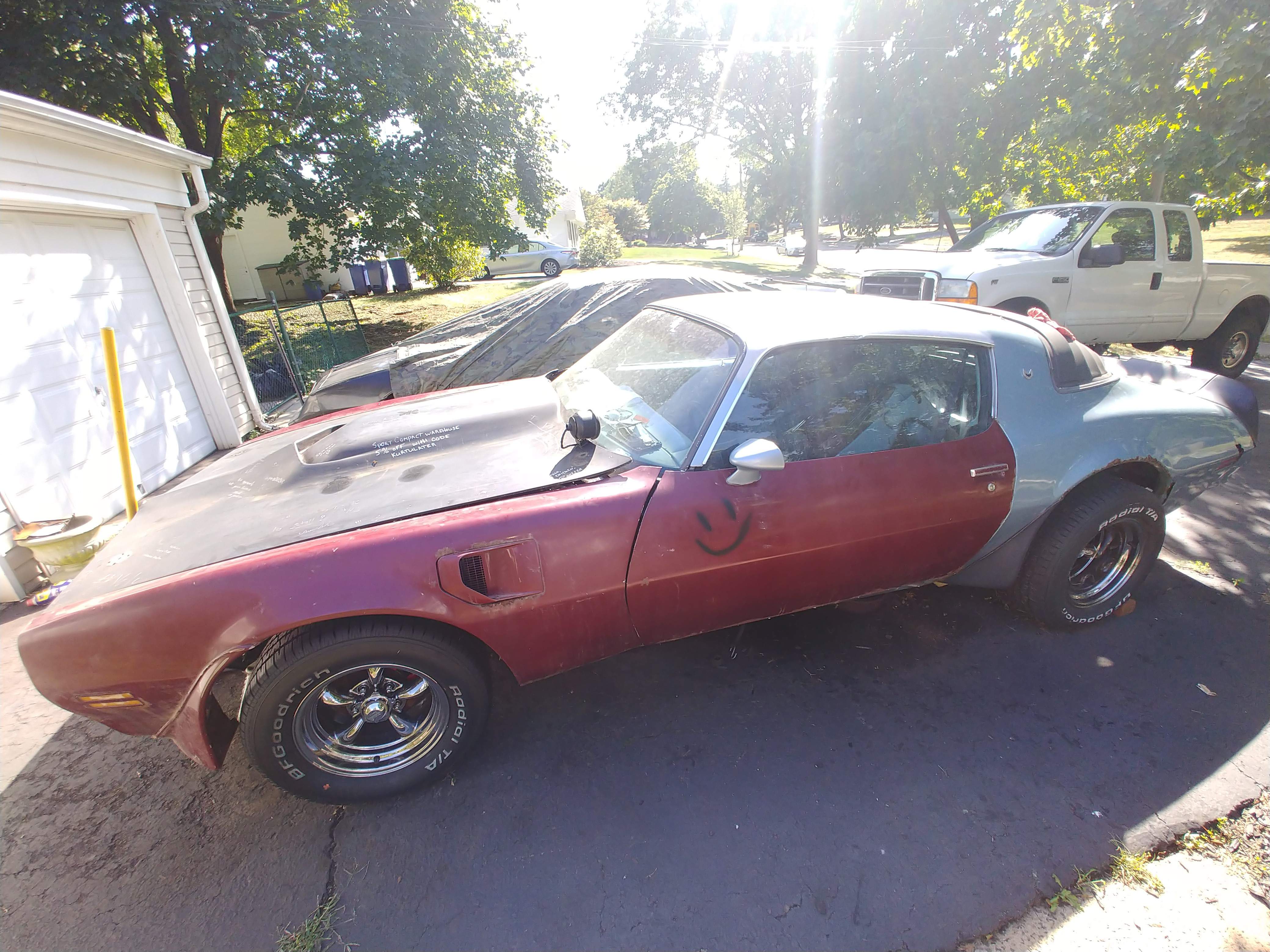

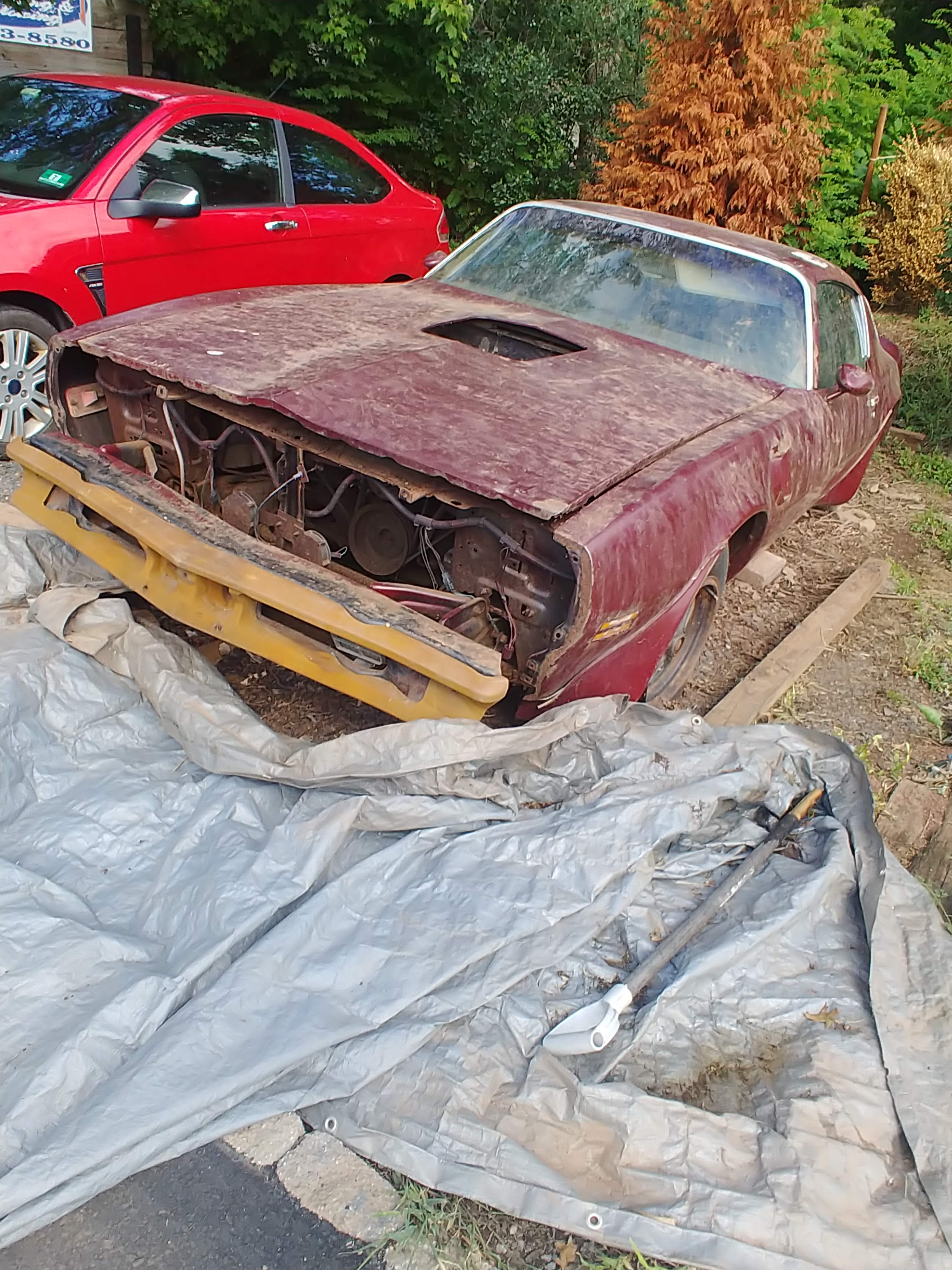

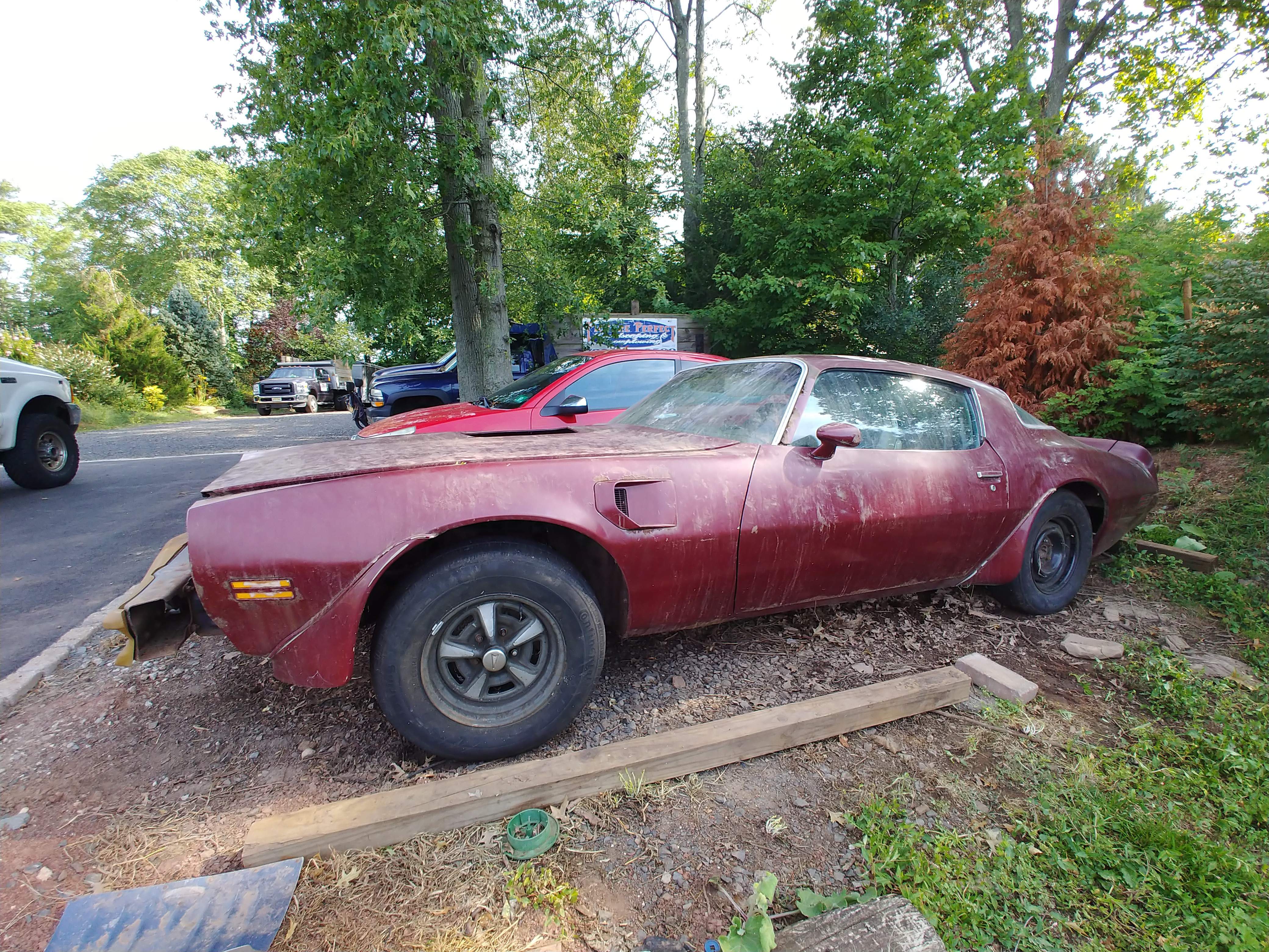

ANYWHO we struck gold! $650 bucks later...
This car was sitting in a local landscaper's yard for 25 years as payment for a project that totalled 800 bucks. The roof is rotted and the original owner is long gone as well as the title. It's a true 1978 trans am and those fenders, doors and rear end will be perfect for 'Angry Bird.'
Well, now that the car is going to be multi colored, might as well call it 'Angry Parrot'
We've got parts!
No more will i manually pull up or push down my driver side window as this new(ish) door has a full window crank in there. Fenders are the saught after Trans am Fenders with vents and all, something i've always wanted but could never afford until now. We couldn't use the Rear since it was an open dif and 2.41 which was odd, but that was the case.
 I can now comfortably move onto the engine!
