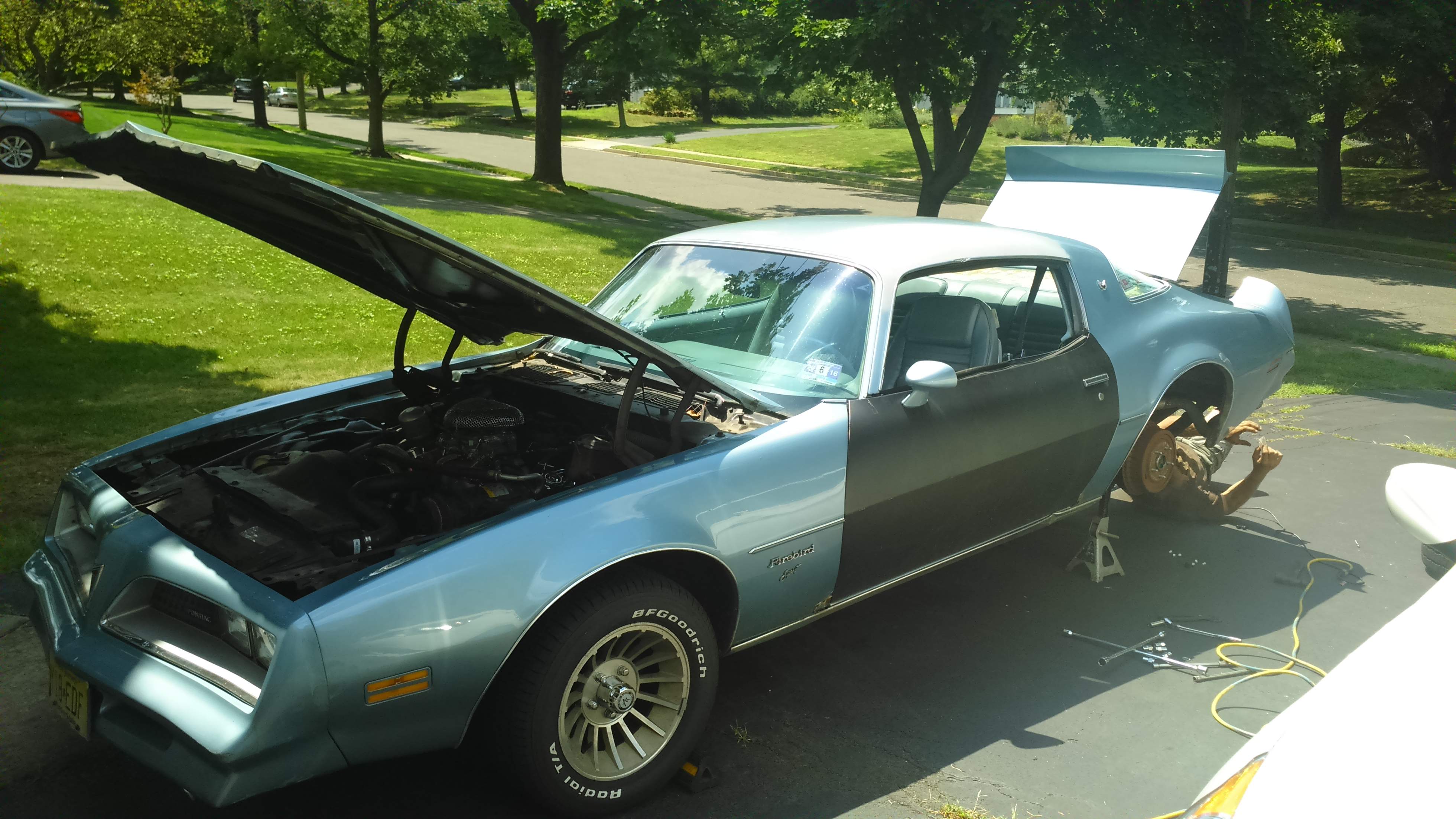

I found a problem already though, at 15-25 mph i have a weird side to side wobble out the rear end. I have no idea what can cause this since all its done is sit for 2 months. The only thing i can thing about, is the one wheel with 3 lug nuts holding it on. Hmmmmmm.
I'll also be posting on instagram if anyone wants to see more of the bird's current state. Just find kurk_kurk
Check your tires. See if you have a flat spot on tires or worse, maybe one of your tires has had a steel belt separate. You are looking for a visible blemish in the tire.
I had this happen once on a my '80 Buick Regal. It was my daily driver at the time and it would wobble at low speed and stop at higher speeds. I bad a broken steel belt and I had to replace the tire. In my case it was my right rear tire.
Well, i don't have a flat spot. but one of my tires is like, making a U shape. Pretty sure that might be the problem then.
Aside form this, the driver side wheel sticks out an entire 1" more than the passenger side rear wheel. I don't remember if it's always been like that, but if i can't fix that, i guess i could use some spacers to even it out.
Weather has been pretty shite so i haven't had a chance to strip the parts off. Still waiting...
Sounds like one tire needs replacing for sure.
As for the driver side being wider than the passenger side, what are the tire measurements on both sides? If the tire sizes are the same, then I'm guess the back spacing between the two rims is different and you need to get two consistent rims.

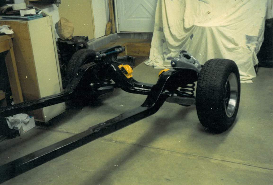

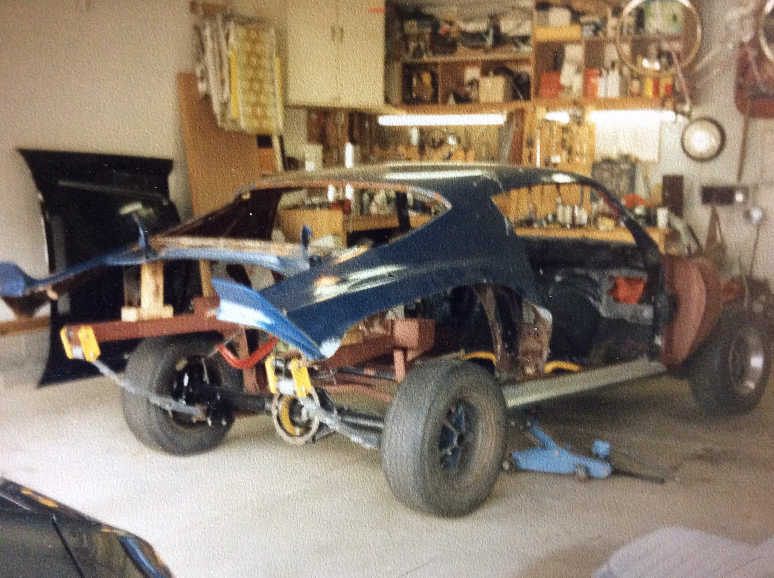

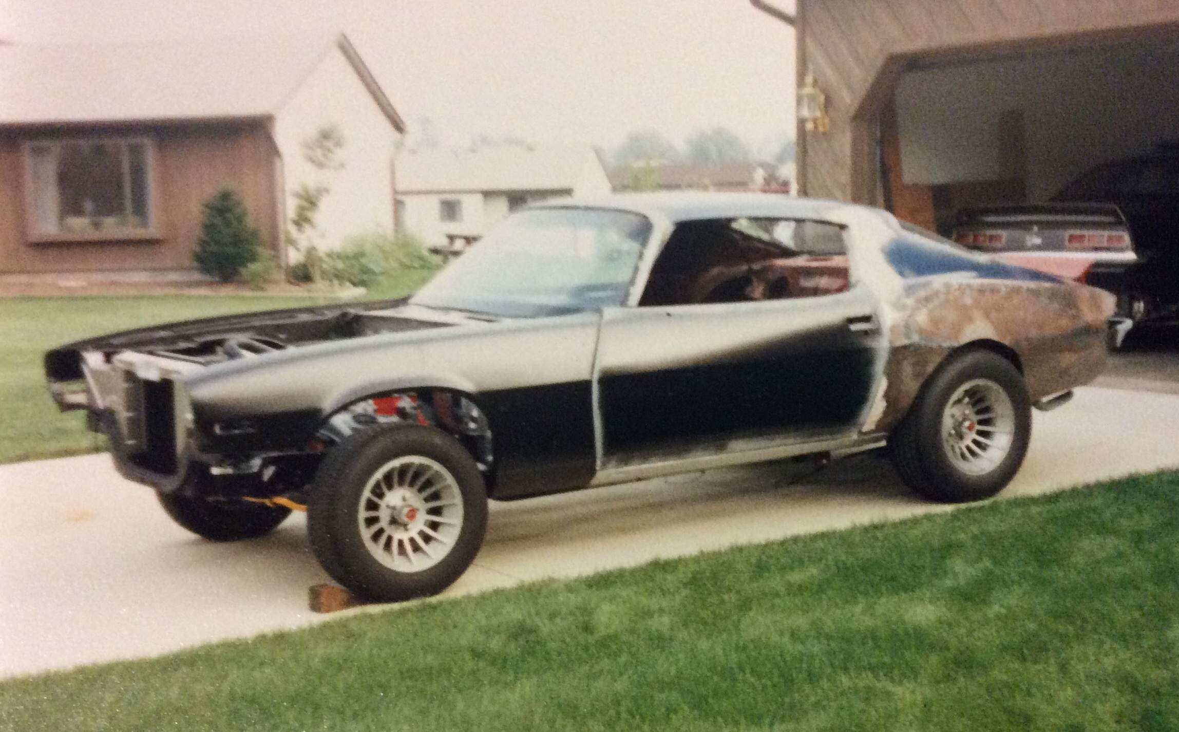

Let me first say this, if you effectively stiffen the chassis of that year bird you will be amazed at the handling performance! That said as an overal choice, frame connectors are last on the list!
The back third of the car is just sheet metal, even the portion that looks like frame. The true strength of the back portion of those and the first gen was in the floor, just after the spare tire to the connection of the horizontal floor. There are actually three layers of floor welded together with different angles to each piece and void space in between. The weak point is the unsupported floor from the forward spring perch to the subframe, which is the reason for the frame connectors.
You can weld the front portion to the subframe, but the back portion is connecting to thin sheet metal! No matter how you try to connect it or what you connect it to, the final stress point is thin sheet metal. I have seen more guys use frame connectors to stiffen that area and in the end after continued use it tears the adjoining sheet metal somewhere as a result of continued stress!

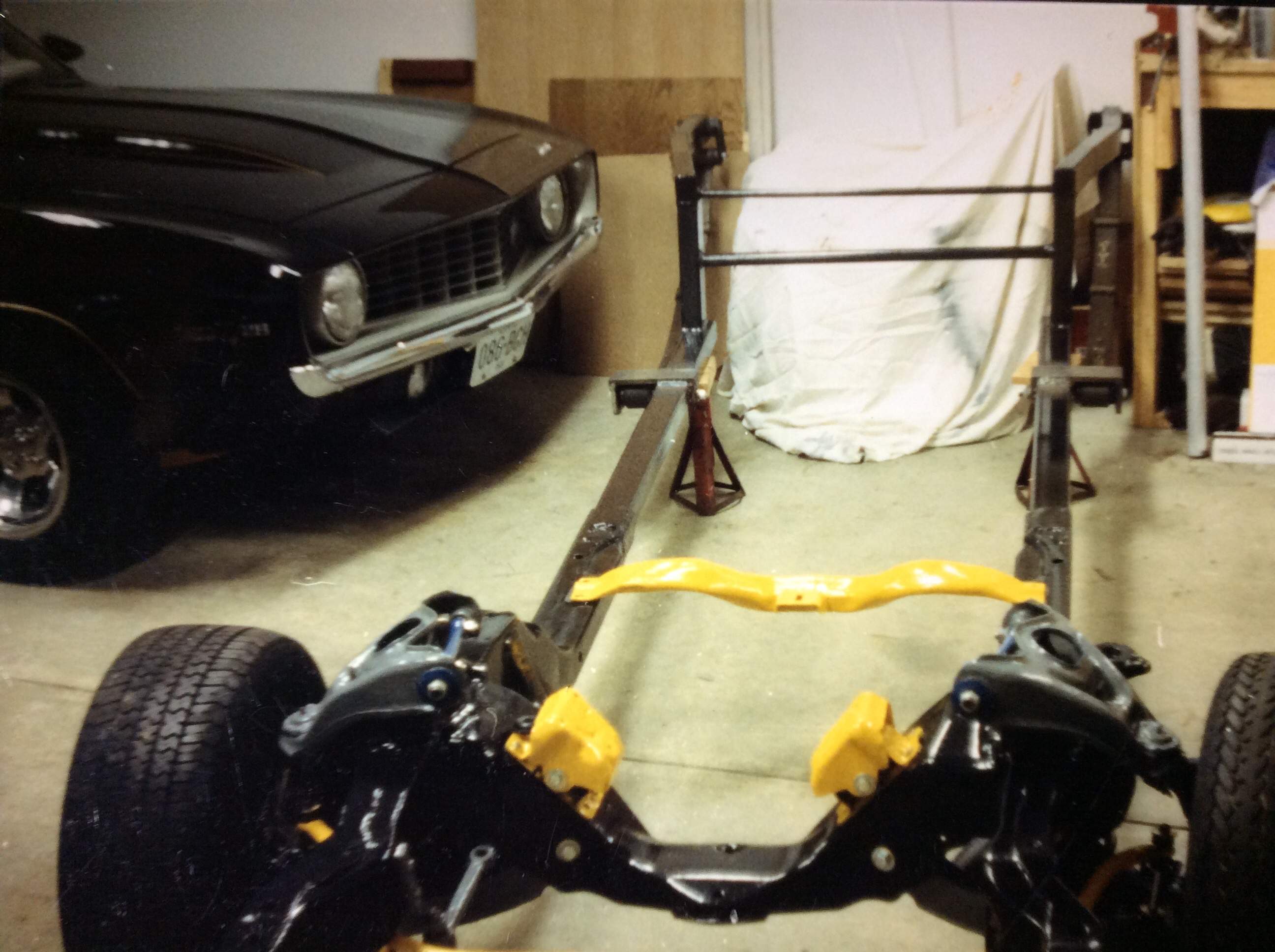

The only effective why is to build either a full frame or as I did three different times. Build a frame that runs from the front subframe to the back of the car, ending at the rear inside valance panel. Depending on what type of rear suspension you want will determine the frames configuration.

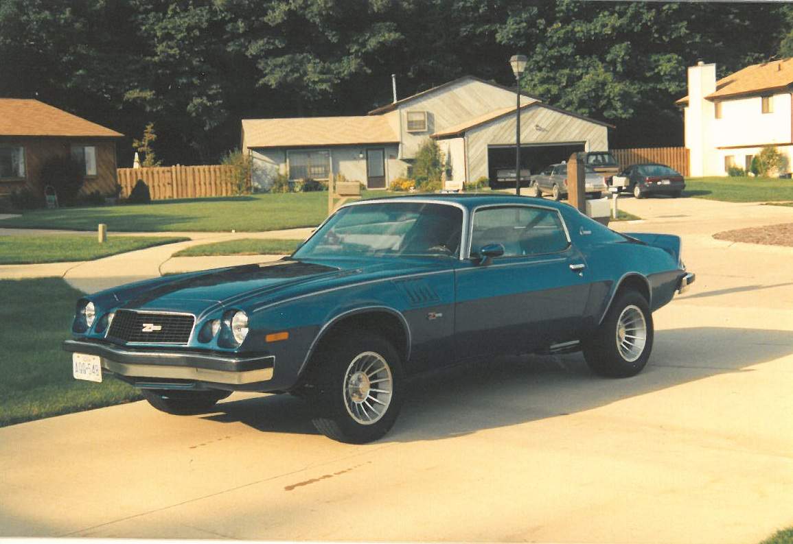

This first picture is of the 1969 Z/28 full frame it was a different configuration as it was built to race on road courses.

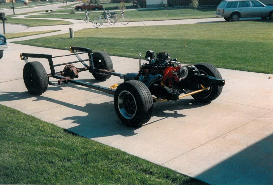

1974 Z full frame completed
Body being installed
shot of the 74 frame being built, 69 in the back
Continuation of the 74 body
74 finished
An other shot of 74 frame
74 finished

Thanks Two Lane! The “74”, which was the frame that was in the driveway and garage, was a fun car once the full frame went under it. It was my wife’s so I made it more docile. Still it was a really excellent handeling car. It was very quite because I used 1” square tube in a square pattern attached to the frame and made a double wall floor with foam in between. That particular “69” Z was my all time favorite car. The car would pull 1.25 g’s in a 300’ skid pad test, the CG was lowered 5” and RC was lowered 13” yet still rode quite nice. It was an 11 second quarter car and so much more. I use to explain it as, the car drove like it was an extension of me. Just plain fun!

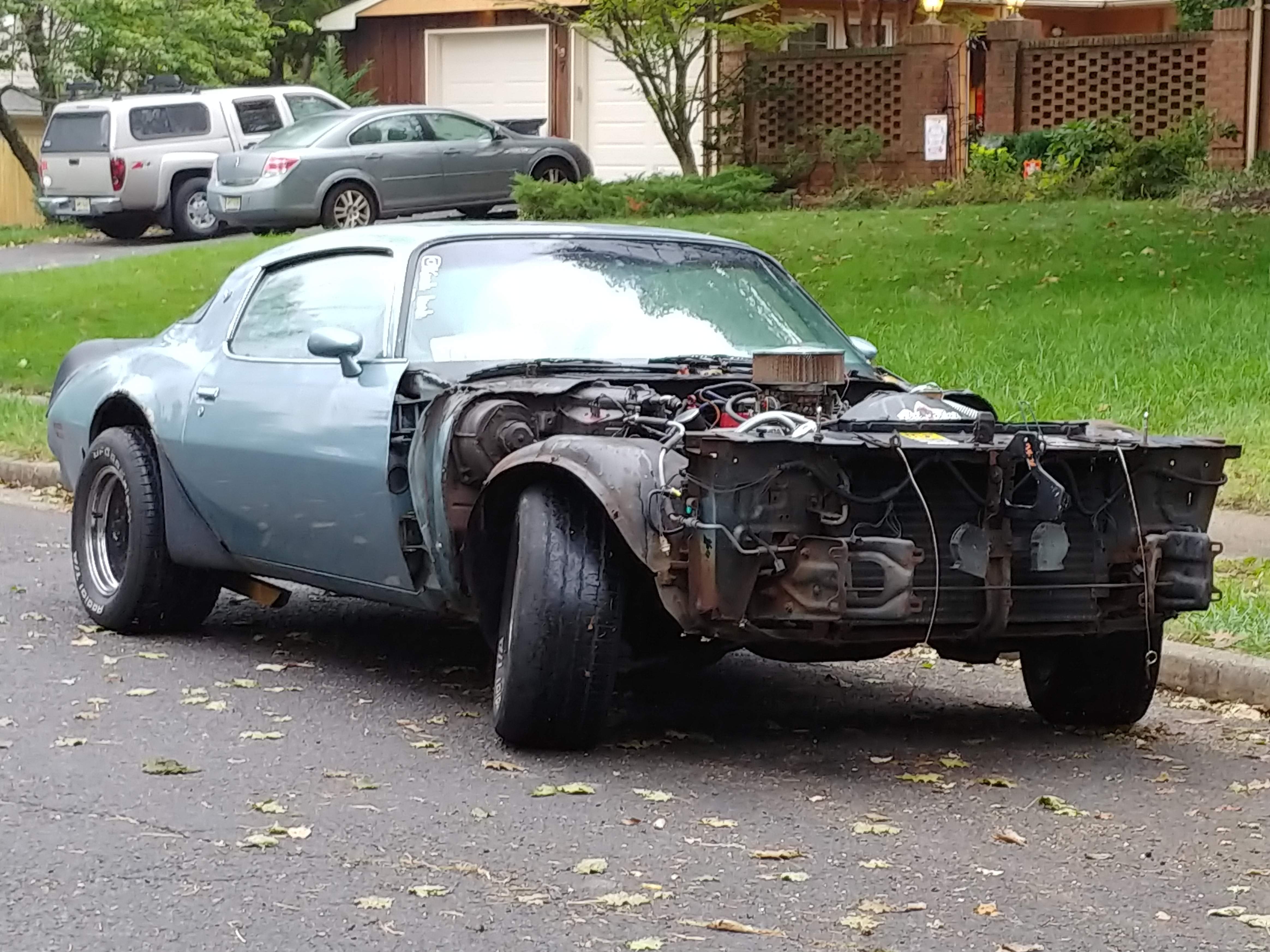

Alright, looks like i made some progress for phase 1 of the restoration. The whole front fenders, bumper and hood are all off and the guts are fully exposed. So much to the point where i can see how every. single. bushing. has been dry rotted and dusted out of place. The body mount bushings? they fell out finally, rotted away and feeling like a wet paper towel. Unfortunately, while trying to tackle the body mounts, on the first turns i felt the bold starting to 'rub' you know, the tell-tale sign that the rusted bolt is about to break. So now i wait for new bolts to come in before going any further with that. pretty sure i need to work one side of the frame and then the other, lifting the body up just enough and etc. fun times.
I can, however, go ahead with control arm bushing replacement since i think that's where the illusion of a 'bent body' is coming from. Not to mention how i now have all the room in the world to work on it. Little by little.
And i would love to have a full frame like you have there, but i simply have no idea how to do that. the most i'll end up doing, is cutting out the entire back seat and trunk out and turning that into a reinforced cage section since.. it's all sheet metal there anyway. I'll create a bunch of room back there to play around with. let my creative side out for a bit lol.

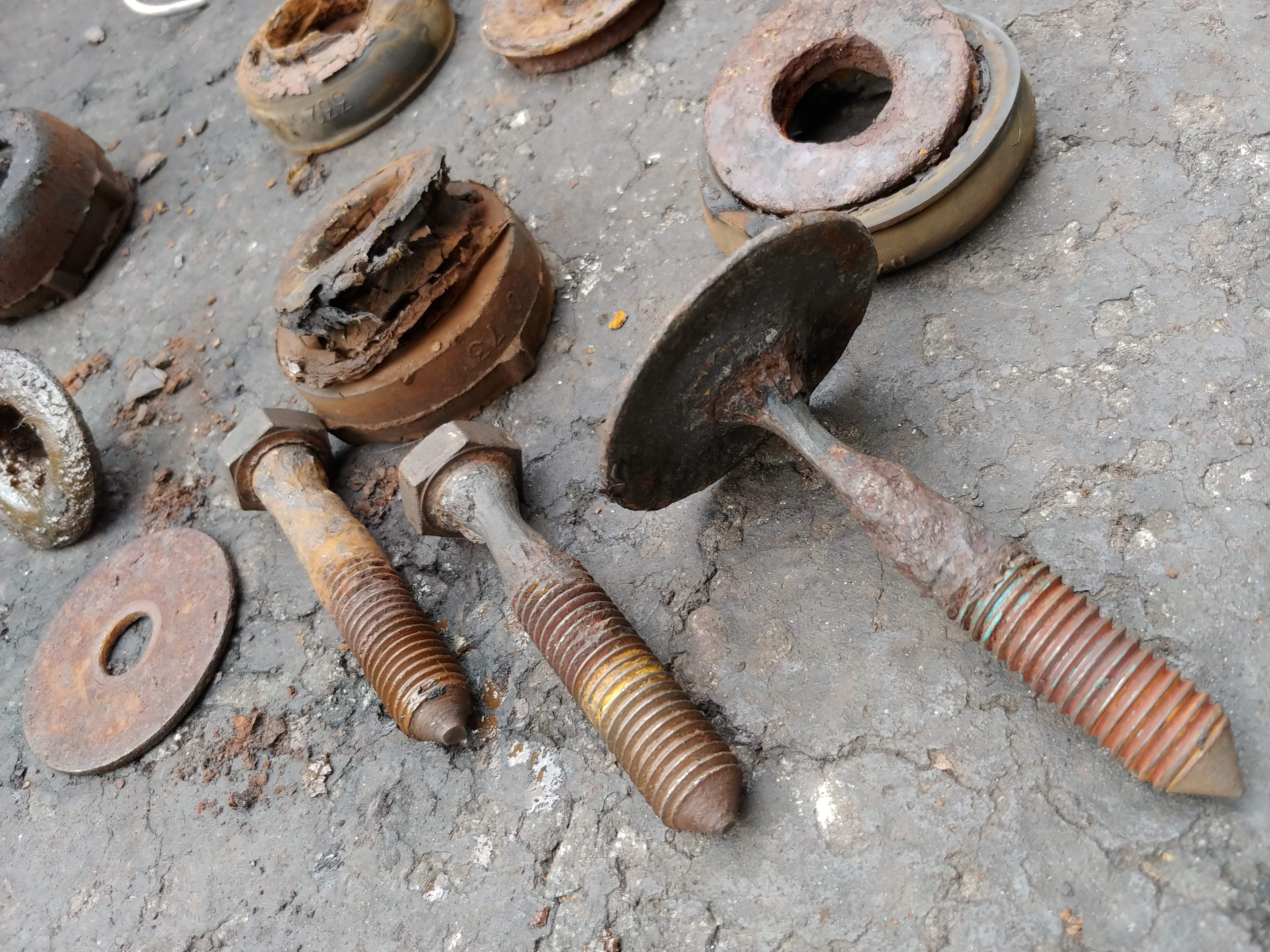

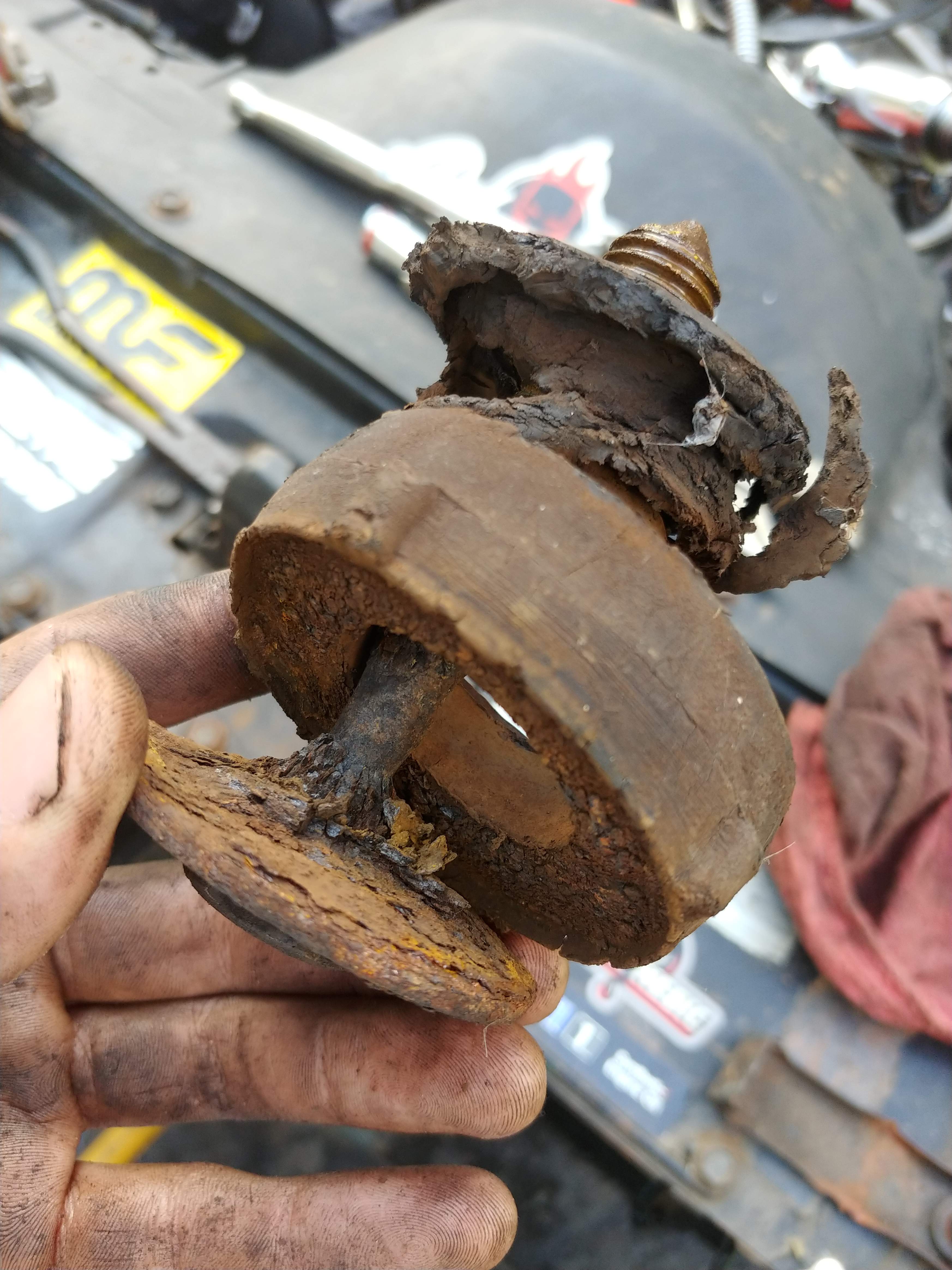

So this is actually a pretty big deal, we got the old body mount hardware and rubber all out for the replacements!
They have never been touched since their day they rolled off the factory assembly line, as with most of the parts on the car. This is a really big deal because one day when me and my Father had to replace the flywheel, we put the jack stand under the trans and pumped it up for engine alignment, the whole car would bend and creak from the firewall and forward. It was about to accordion itself, really, with how much it bent. that was because of these worn out bolts.

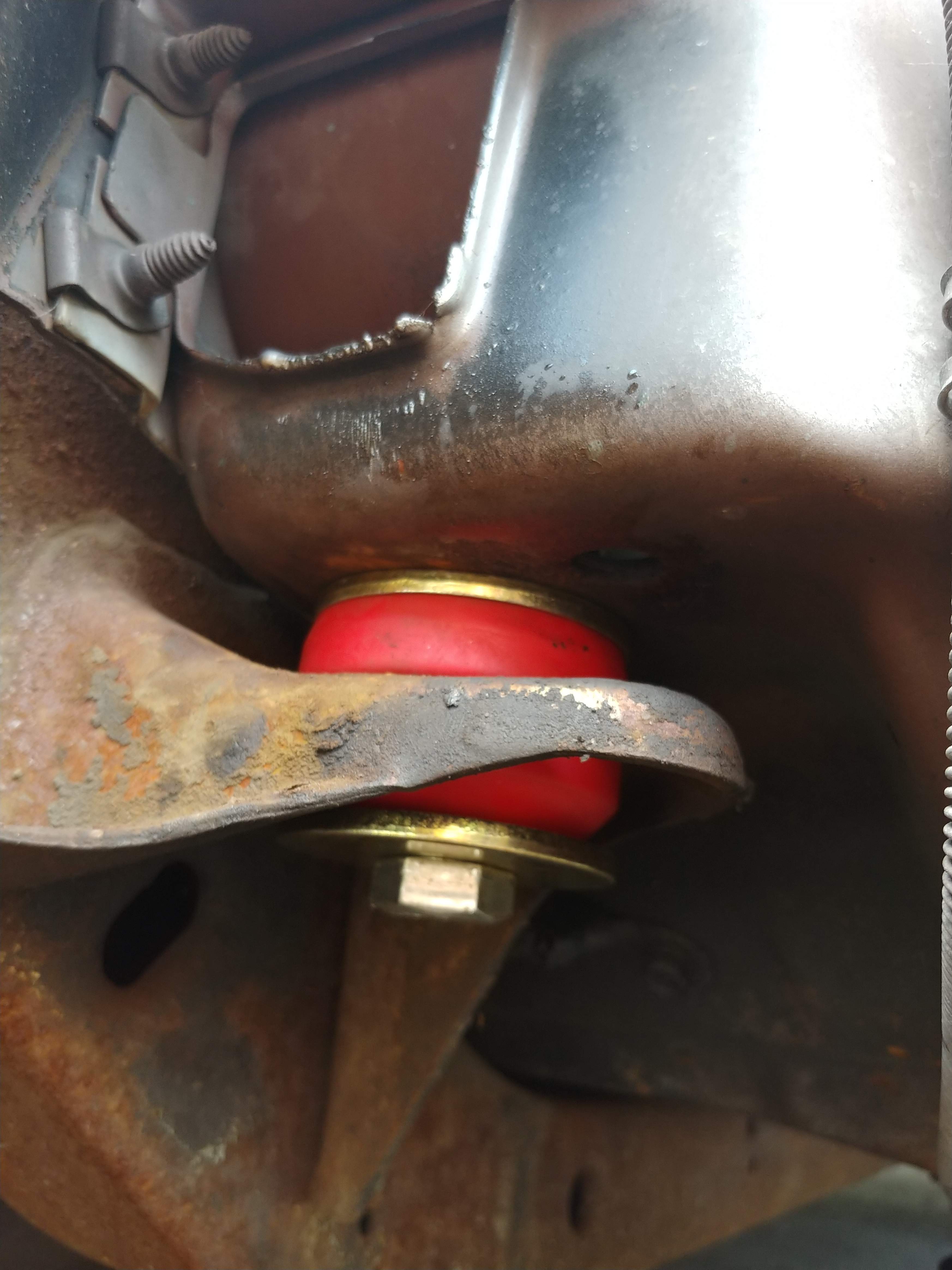

With the new Energy Suspension rubber bushings and hardware in place, the whole thing barely budges from it's position.Which gives me the whole 'i told you so' attitude because my father keeps telling me the car is 'unsaveable'
But seriously, look at how awful these bolts got. I drove around with these for about 4 years, yikes.
Don't kick yourself about the shape the body bushings are in. As I tell everyone - time, UV, dirt/grim, and chemicals are the bain of all rubber products on a vehicle. On a friend's '68 Impala, I saw nearly a half inch of shrinkage from the deteriorated stock bushing to the new replacement. That had a huge impact on door and fender alignment.
I am glad that you now understand the importance of replacing these components and what they will mean to tightening up the car as a whole, down the road.
