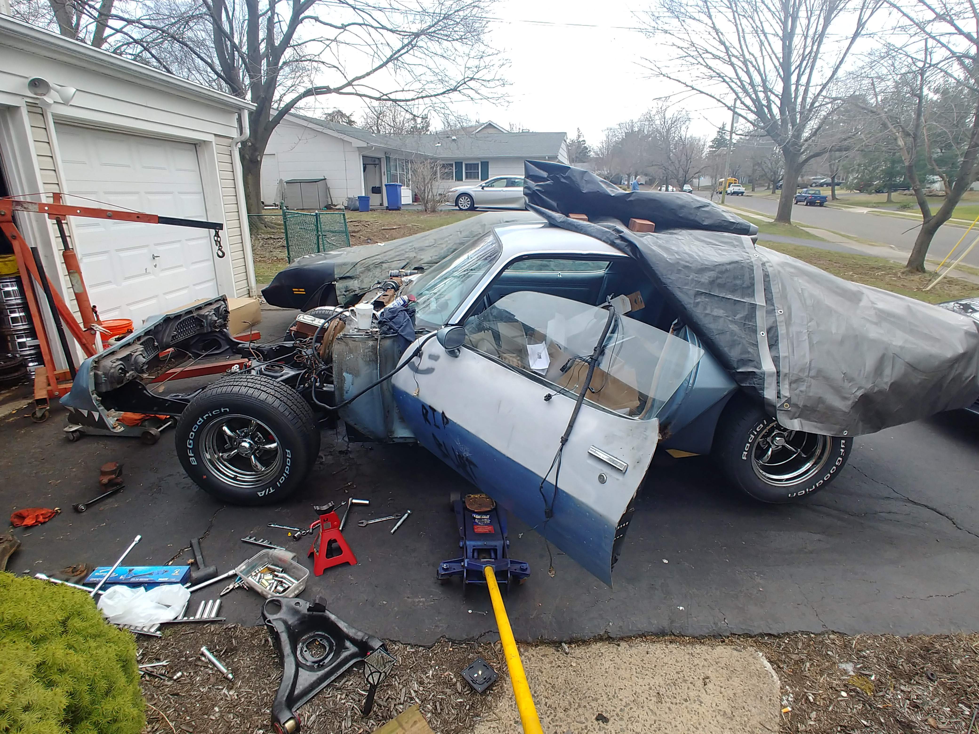

WOO warm weather means i can start working on the car again. Here we go,
This time on Project Blue Bird:

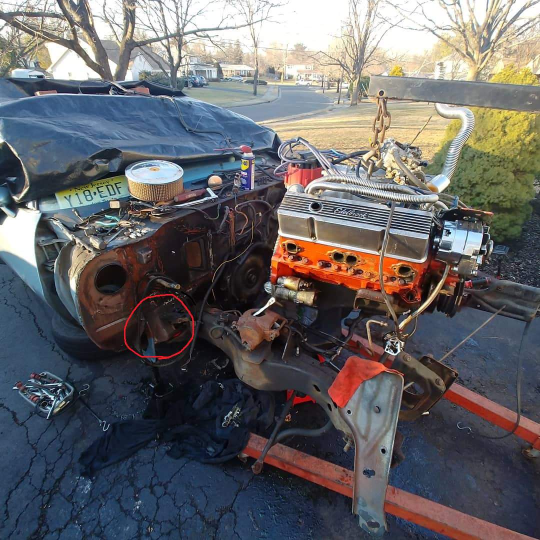

front radiator support and mounts have been removed, finally, for replacement. The actual radiator support itself is not bad so i'll be wire brushing it and painting it to make it look fresh. The mounts were not too bad but they were awful enough to merit replacement. While doing this, i noticed "Shredded Mozzarella" in my motor mounts, telling me i did too many burnouts. So, as anyone would to, i pulled the engine out for further prep work until parts come in.
This is where things got worse

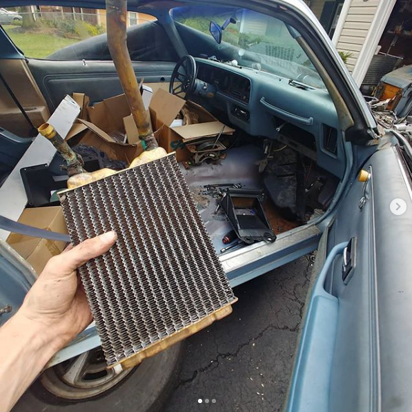

In the photo attached, i've circled the area that's been rotted out because of a bad Heater Core. At first, i saw the rotted out toe board which seemed to be an easy enough fix. Unfortunately i jinxed myself when i found that the Acidic Antifreeze ate through all three layers of steel by the toe board. If you look, you can see the red mount from the Energy Suspension Part going into that frame-body connection point. The structure point of the car i guess. I've drawn out what's happening with the metal with my handy MS paint skills below.
I have no idea how i'm going to fix this at all....

There is only one way to fix this and that is to cut in a replacement / patch panel. Luckily for you, National Parts Depot carries replacement firewall / toe board panels. So for $400 plus S&H, I think cutting up this new firewall panel will save you a lot of headaches of having to fab up all that wild sheetmetal.
https://www.npdlink.com/product/panel-firewall-front-lower-incl-toe-boards-and/197317?backurl=search%2Fproducts%3Fsearch_terms%3Dfirewall%2B%2526%2Bcowl%2Bassy%26top_parent%3D9%26year%3D1978&year=1978
Also if the floor rot continues past the toe board into the floor board, you have replacement panels for that too.
Curtis, to expound on what Frosty said. For all the work it appears you will need to put in, I would suggest you replace everything you can with new good sheet metal. Whatever you can take apart at a seam, do so and spot weld. Any upset angle of new sheet metal you can include, do so. This would include the floor if need be.
Your sheet metal rot is not from an antifreeze leak. Antifreeze corrosion when spilled or leaked, even when hot, corrodes very little. One of the highest corrosion rates of antifreeze on a metal is aluminum, but that is under a circulating coolant system.

Didn't think my only option was to buy the whole firewall, then again, i guess that's good because my dad's 1979 trans-am that he's building alongside mine is going to need firewall pieces too. (yes im in a 'race' with the old man.) I'm just hoping that that when the discription says "Incl Frame Cushion Brackets" that means those triangle torque box things are on there too. There's not a whole lot of photos :/ And the rot did make it to the floor board, but my dad has some left over floor board pieces that will fit in there.
As for the lifespan of my bird, it was kept in a garage...on a carpet that retained moisture from rainy days in the salt belt of america. It was also driven regularly throught the 40+ years on the road. The two rear frame rails are also rotted out because of this and they need welding too.
Well it's comforting to know that virtually every piece of the Firebird is available in the aftermarket. Only the F-Body and A-body owners can really say that (up to a point). The big car guys (B and C cars) are out of luck on a lot of other stuff like replacement sheet metal and such.

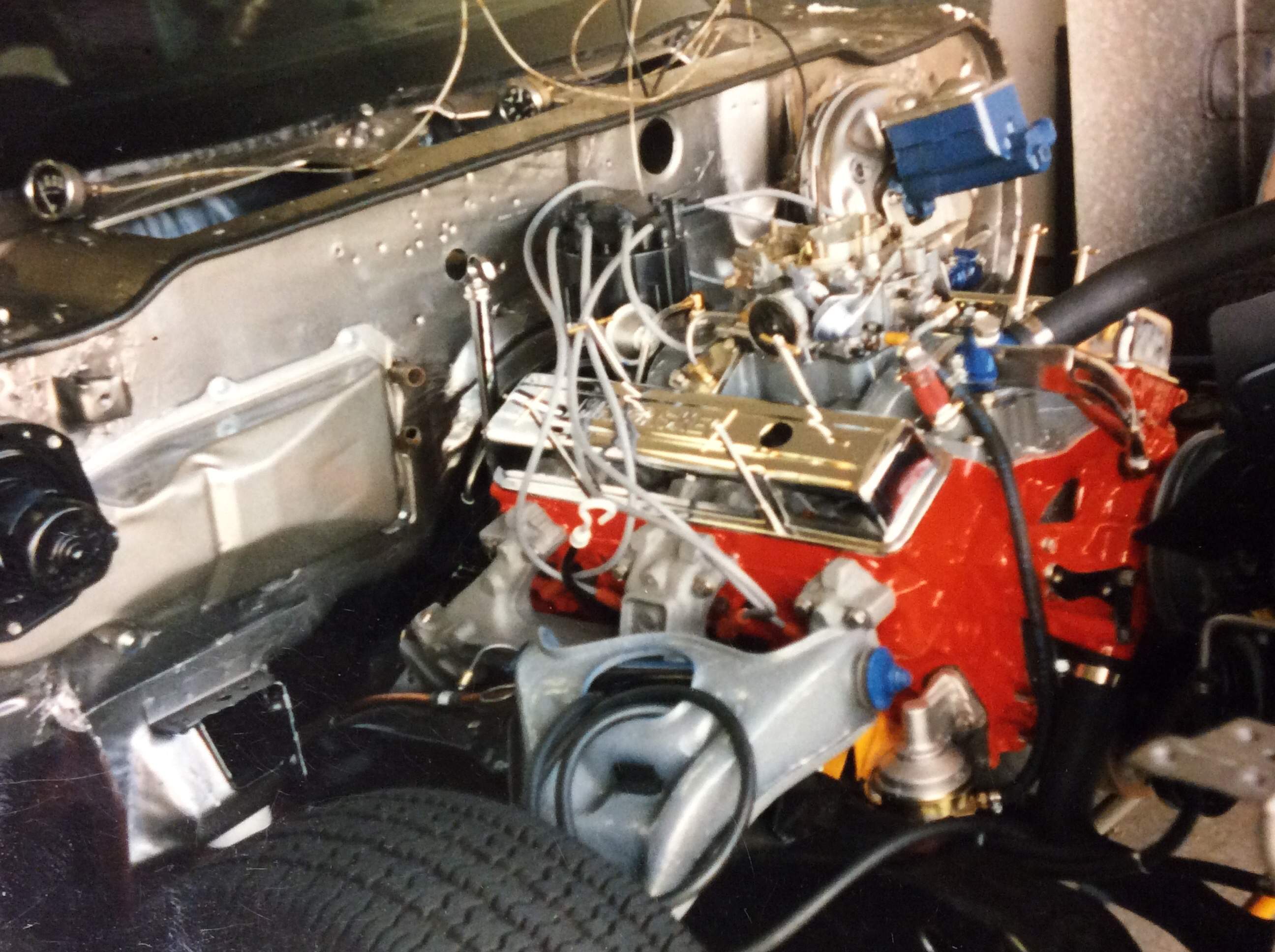

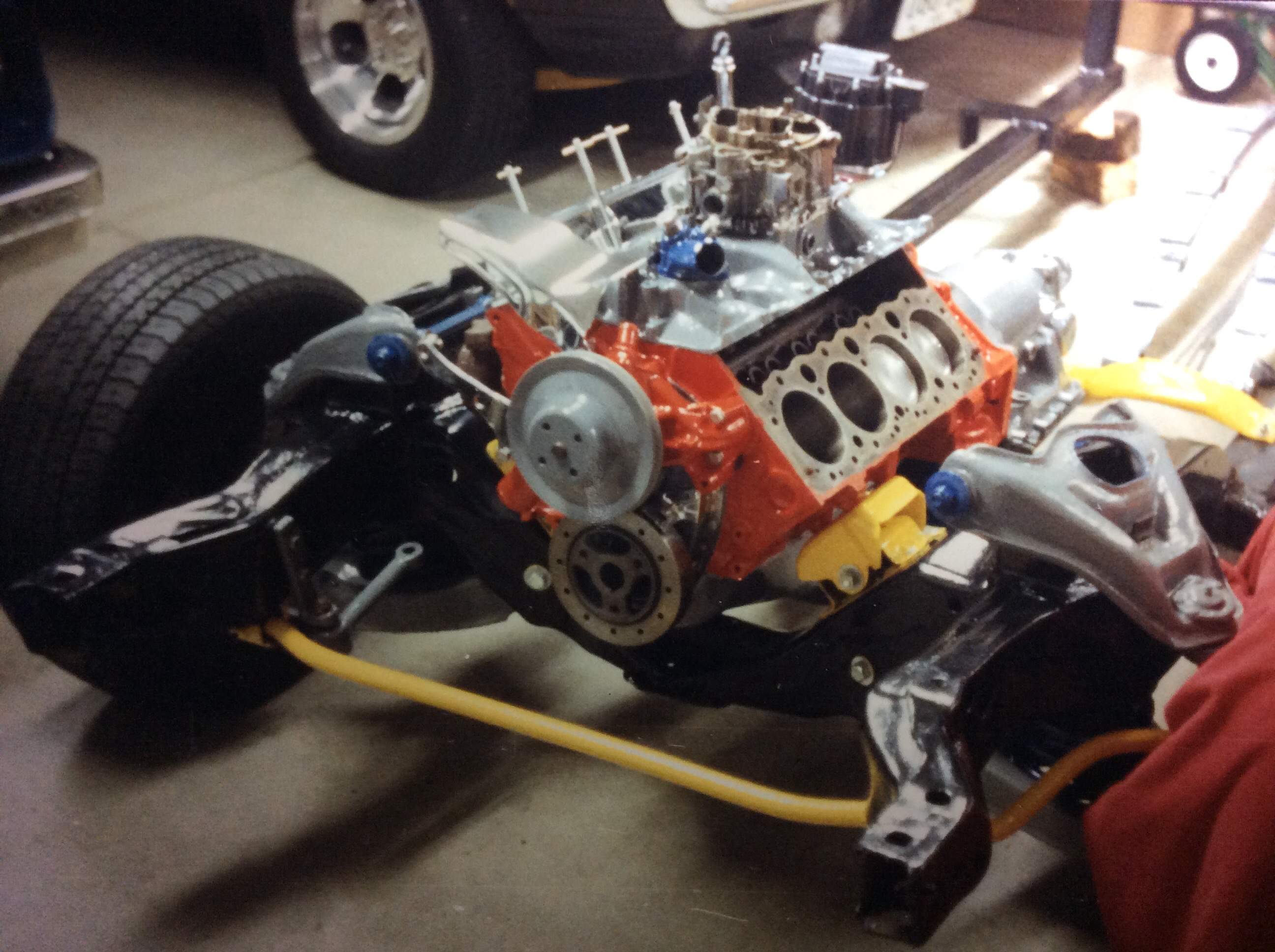

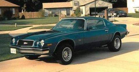

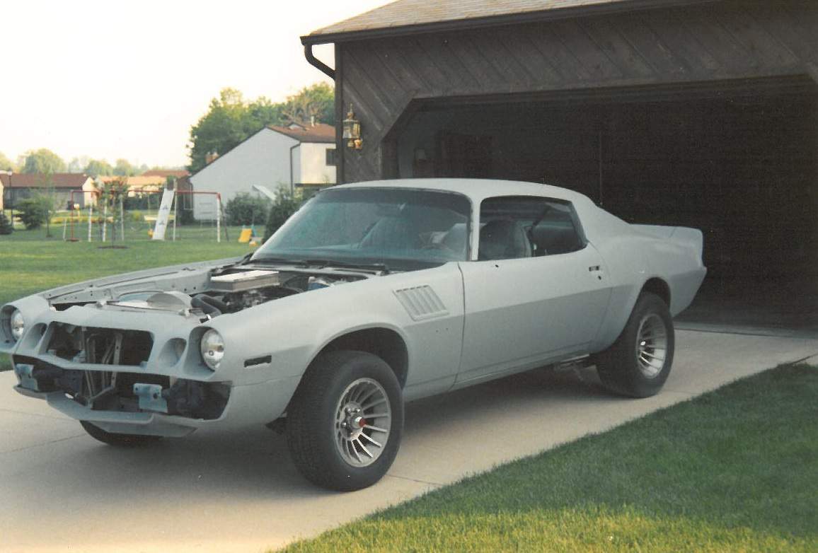

One other avenue you could consider if you can find a good candidate, maybe from the south! Is to cutout the firewall lock stock and barrel, as I did with my wife’s “74” Z.
The whole firewall from the pillar post to the floor was replaced using a wrecked “81Firebird as the donor. In this case the firewall was welded in at the pillar post, mid point, & then the rockers. As the the entire car was redone.
Edited by Last Indian

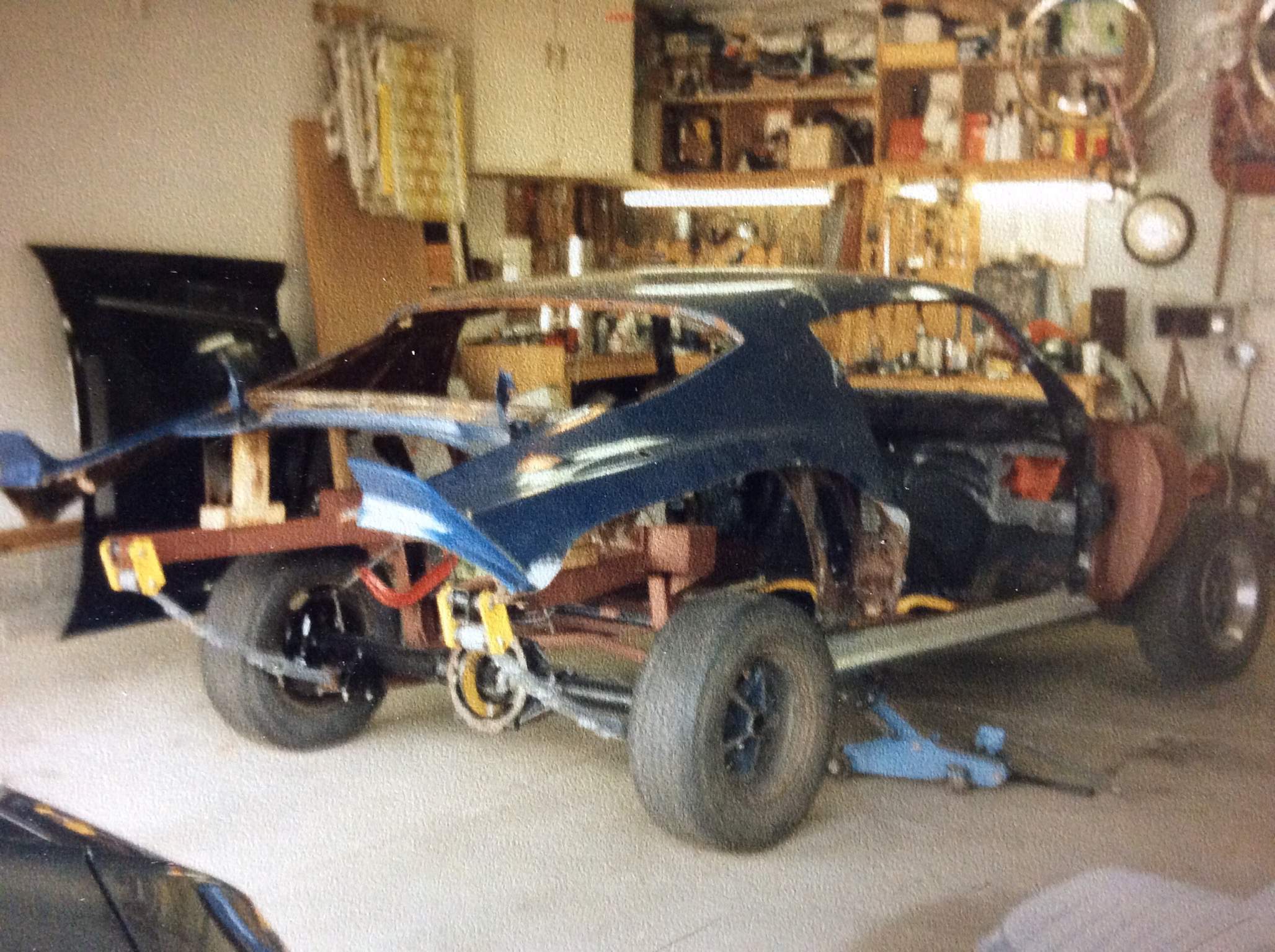

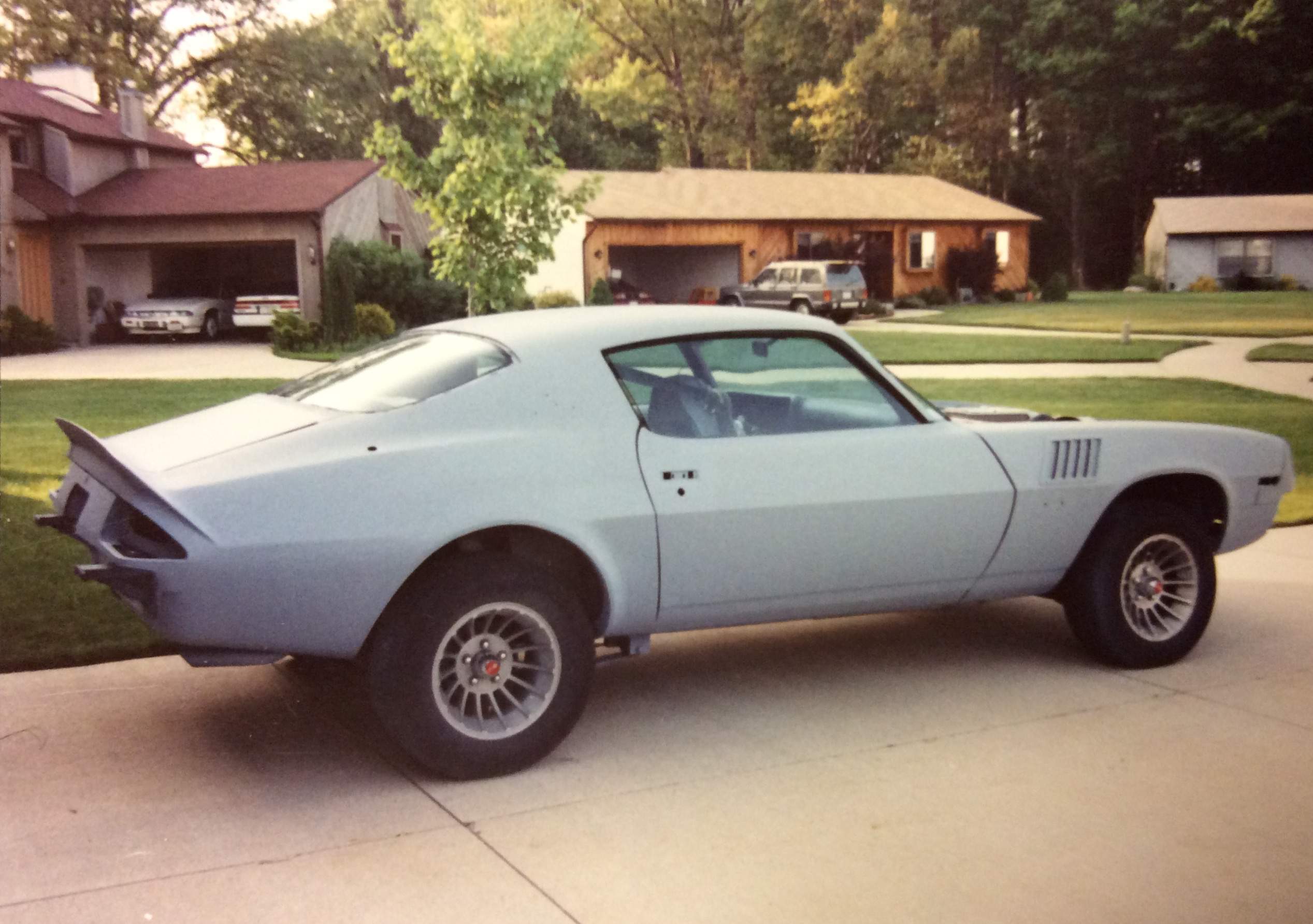

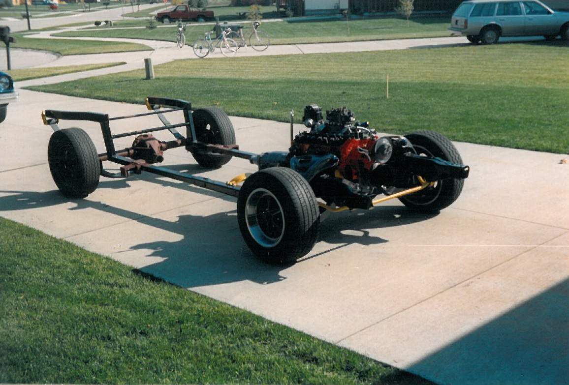

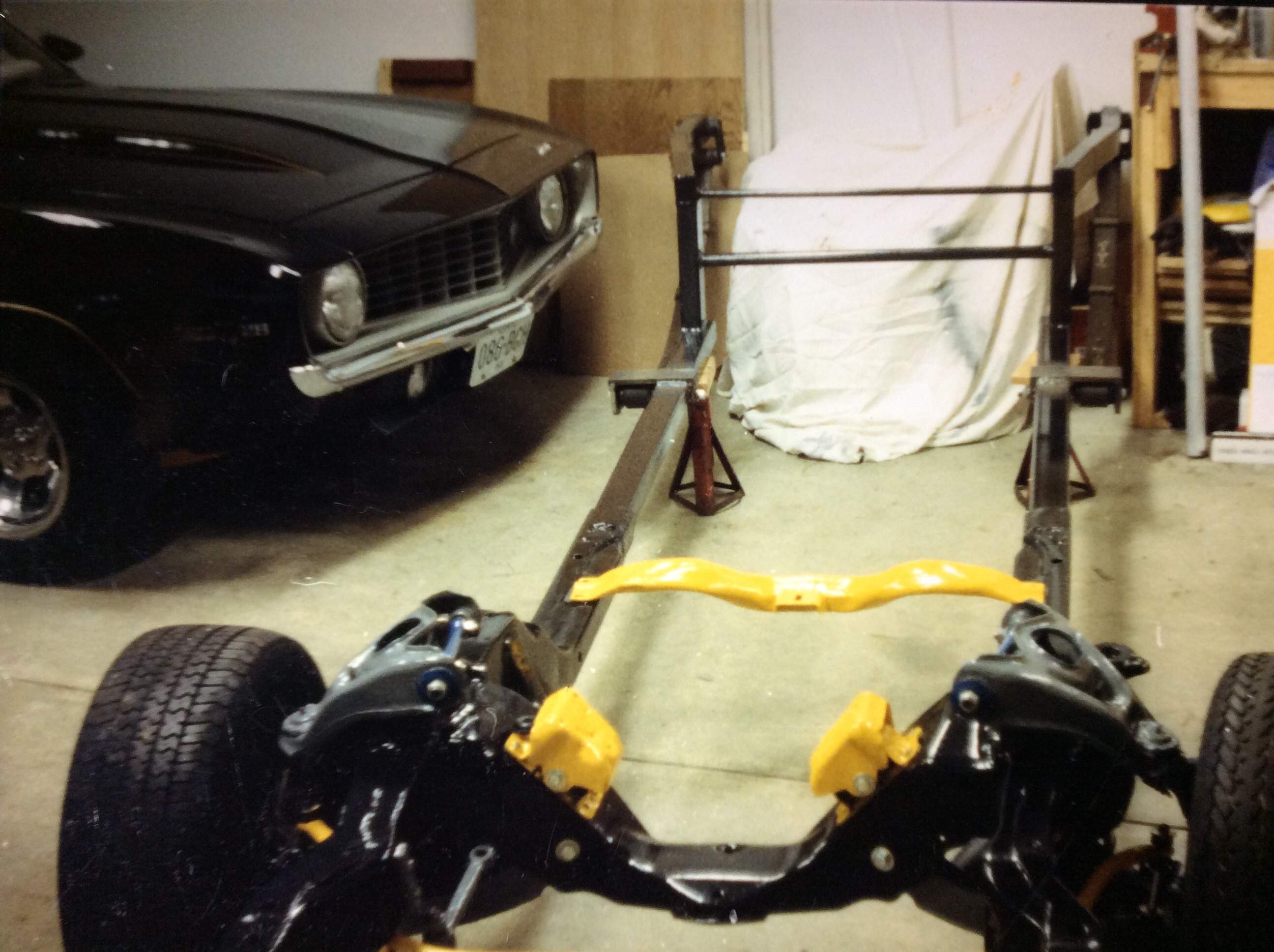

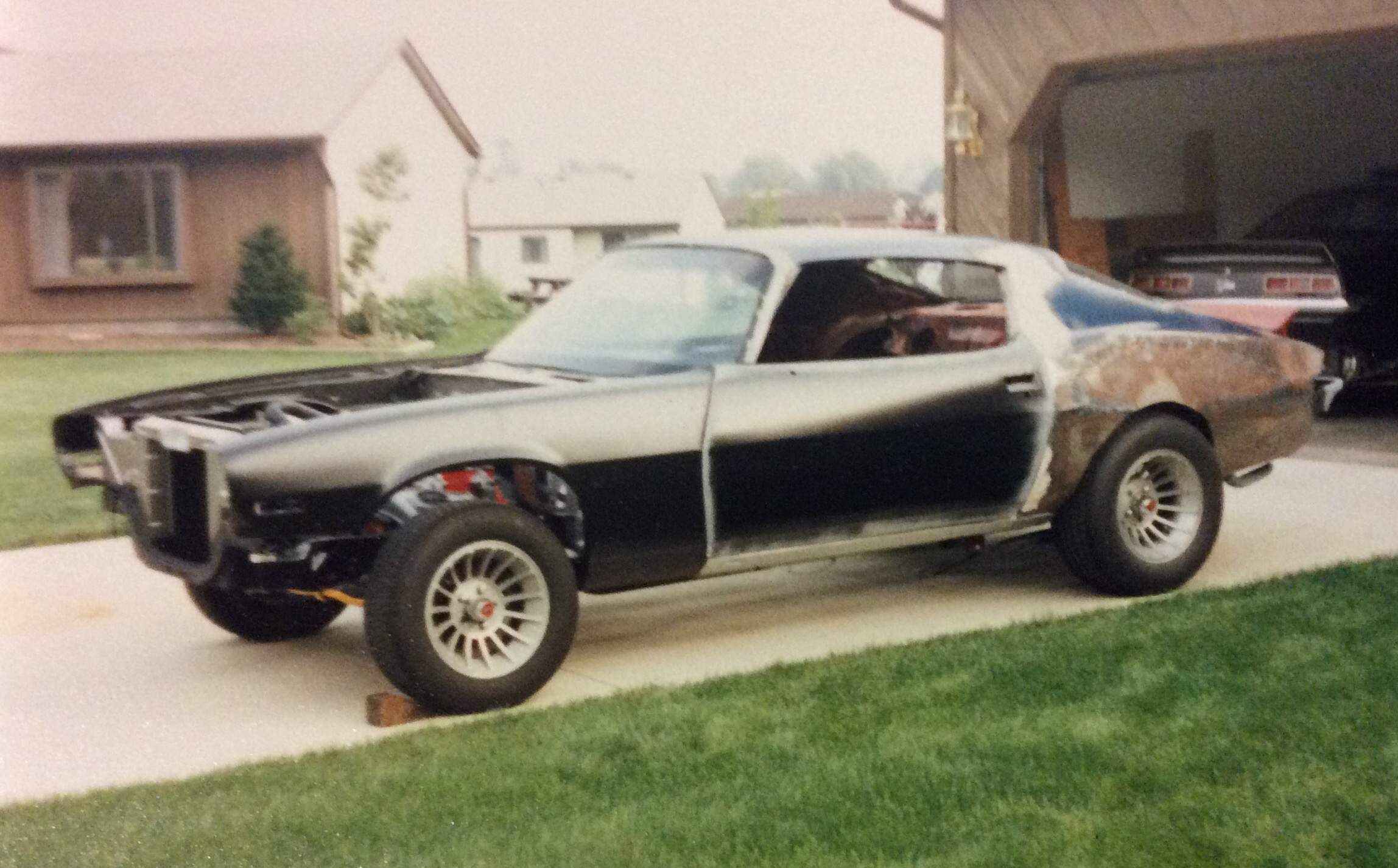

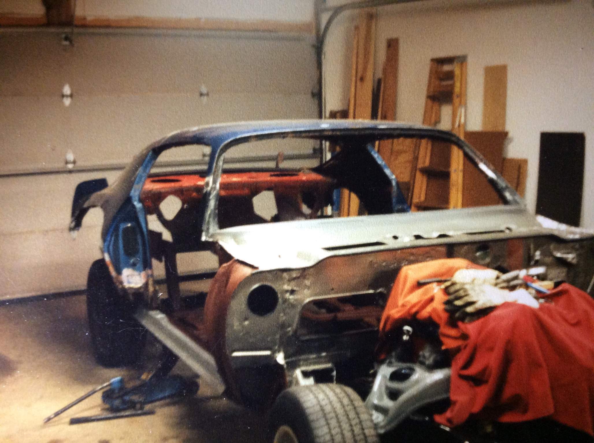

Curtis, well yes and no. Depending on what, where and how you cut, sheet metal will warp or it won’t! In the case of my wife’s “74” all I really used was the roof, tops of the rear quarters and half of the upper pillar post. Would it have been cheaper to find a new car? Maybe, but it would not have had a full frame and all the geometrical weight shifts I made to allow this car to handle.
If you look, all the upset edges, double layers sheet metal, and back window structure were left in place. This held the rear quarters together. The front pillar posts are a triple structured arch with an inner roof panel to hold that whole structure together. When I put the pillar post halves together I inserted a ½ SS rod about 12” long into the hollow channel that exists, then welded them together. In this way any collision that might occur would never be able to compromise the welds of thin sheet metal. The most damaged part of this car was basically the lower firewall/frame mount area and front floor, similar to what you have found.
Here are a few more pics to give you an idea of how it progressed.

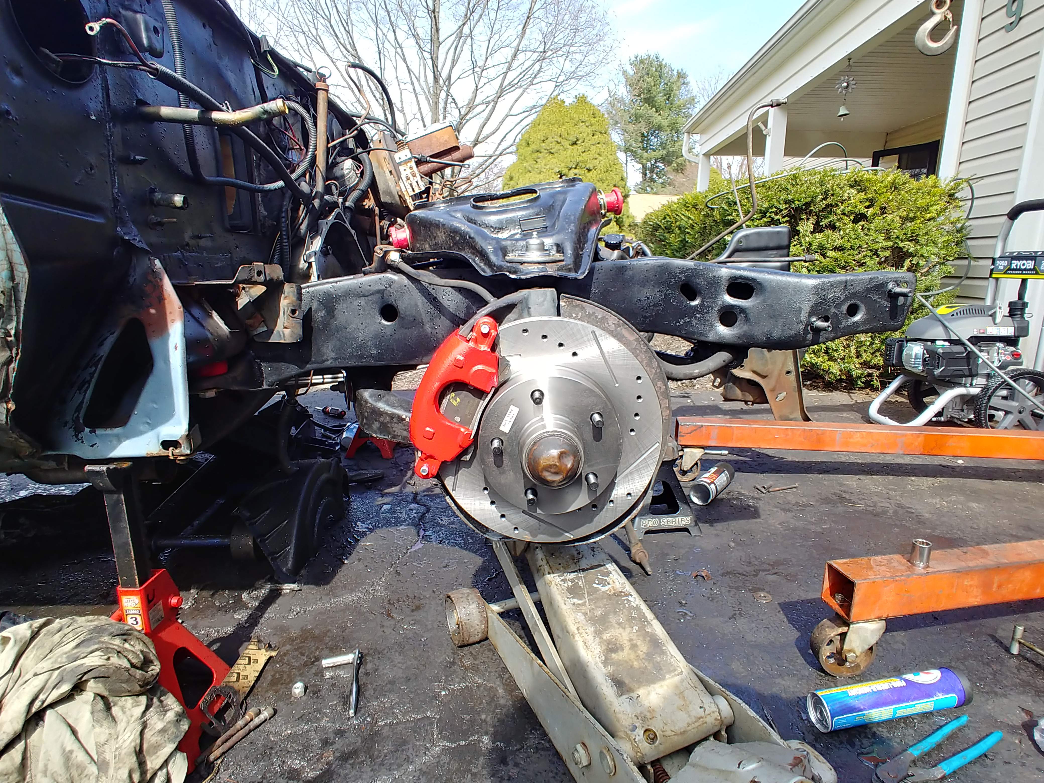

BIG progress made, in my opinion.

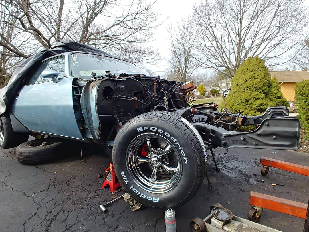

got one whole wheel installed finally on passenger side. Driver side didn't go so well as the lower control arm i purchased has a screwed up lower ball joint insert or seating area or whatever. The hole where it goes into to press fit (hammer into) was too wide so it didn't seat. So that's halted some of the progress for the time being. Good thing i kept my old control arms, currently getting the old one sandblasted and painted to look all nice.
Frame has been painted, calipers were powder coated, slotted and drilled rotors too. Coilovers need to be adjusted still, right now it's super low but i can't change that until i get a full load on them.

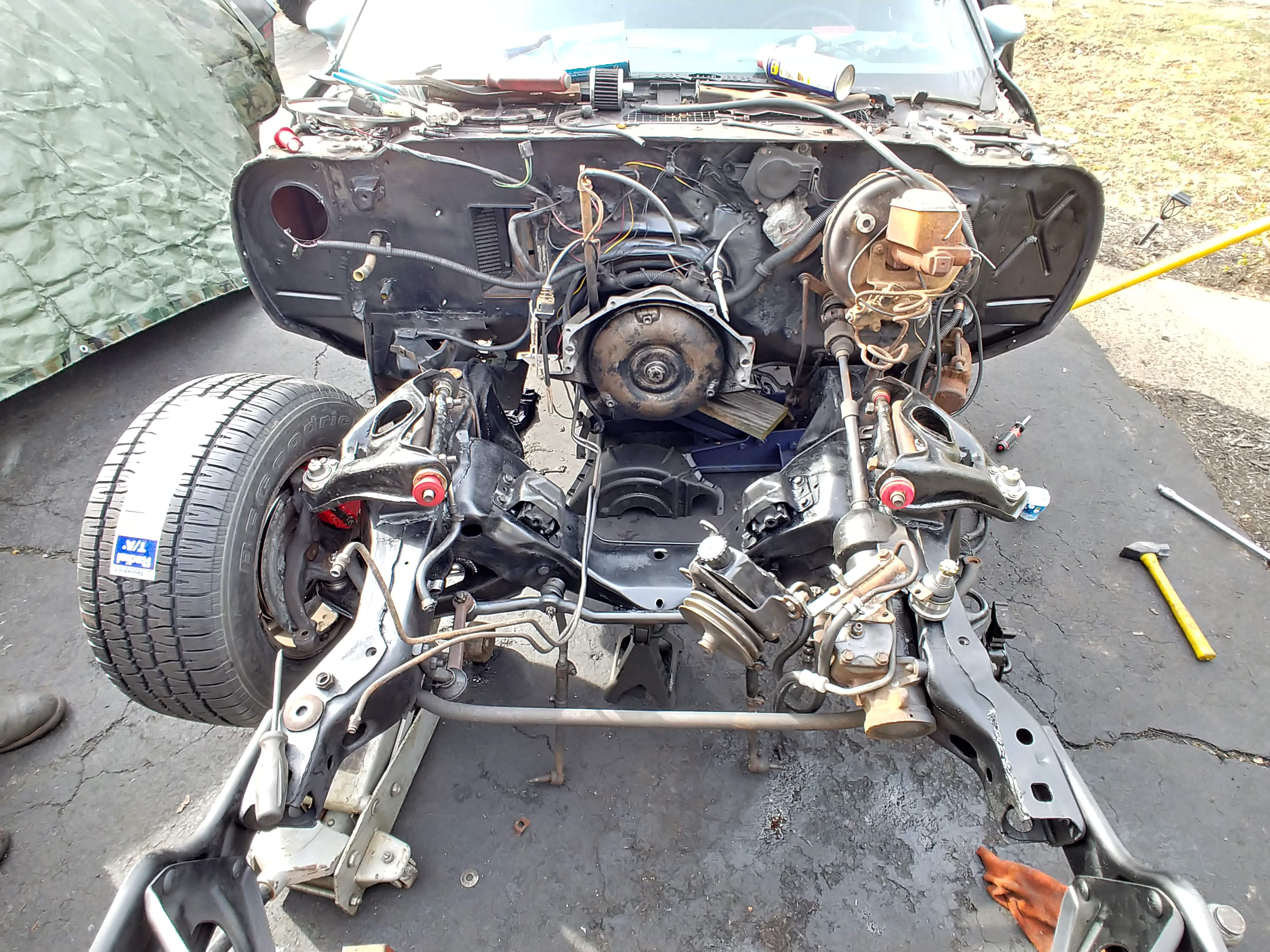

She's standing on her own two front feet now after an entire winter. All that's left for the front suspension is to grease all the fittings and replace the steering tie rods. Afterwards, it will be time to throw in the new radiator core support AND the new aluminum radiator. Welding is in the distant future at this point, as we're still trying to gather materials. A roll cage is still further along the way.
As for the wheel wells, i want to throw out the stocks and cut my own to go in there. I think i could clean up the engine bay with sleeker looks of smooth sheet metal rather than the bulbous wheel wells that protrude through the engine bay. Look up 'BFG Tire Bird' and you'll see what i'm talking about. Lots of smooth space for those +5hp stickers

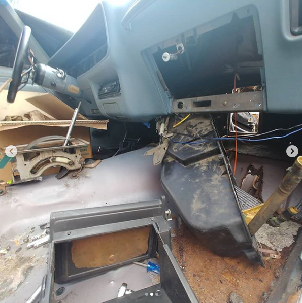

Definitely worthy of an update, Heater core removed and installed without removing the entire dashboard. Ha, take that pops.
my father did it by the book when he was my age and building his '78 Camaro which called for him to remove the entire dashboard. took him a whole day where me, and my trusty brain, managed in only an hour.

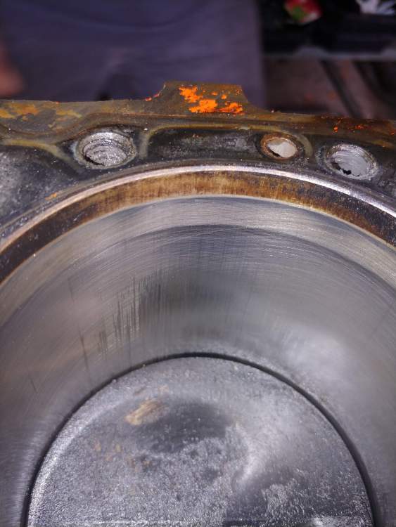

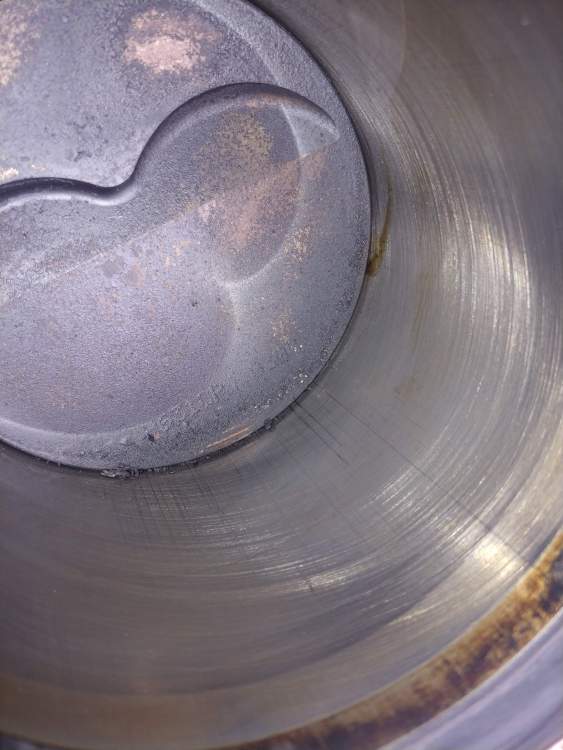

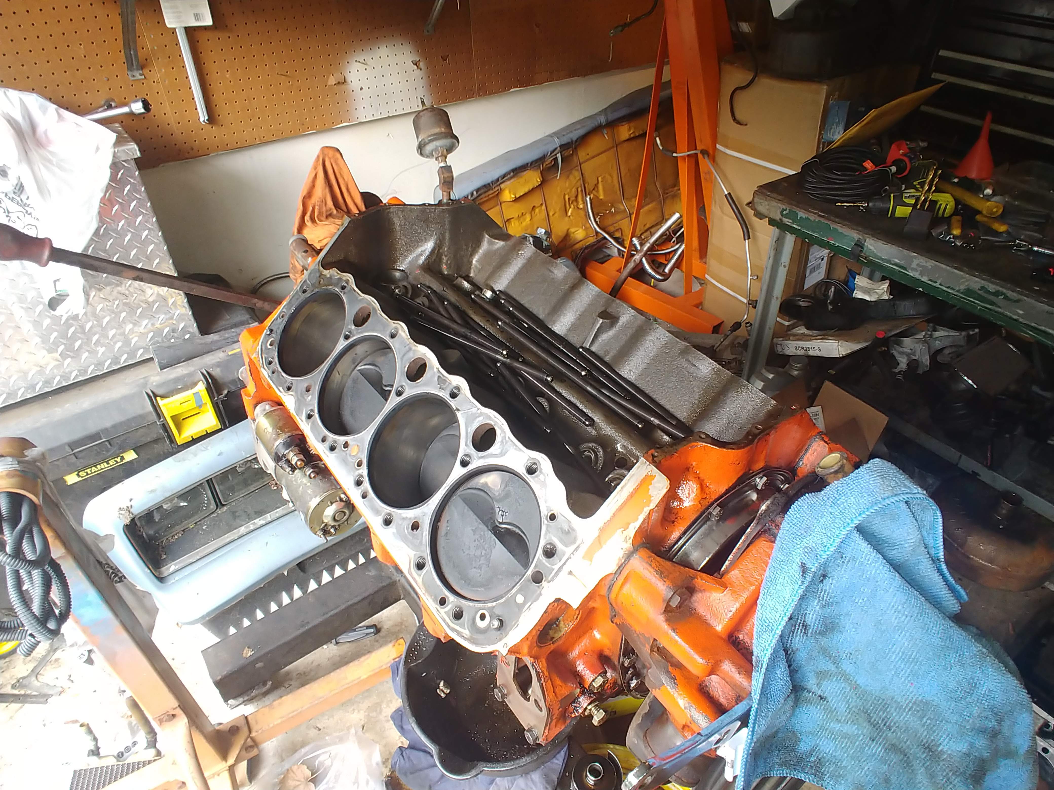

While working on the car, buttoning up loose bolts, prepping areas for paints and general placements, he wanted to take a look at the engine, which was sitting on the Engine stand and flipped over. He looked around, asking about the crankshaft and what-not. pointing out a lean oil pickup tube too. It wasn't long before i wanted to show him how tall the engine was going to be with the new carb, intake and etc. So when i rotated the engine to Right Side Up, oil poured out of cylinder 5 spark plug hole. That would explain why there was always a fouled plug and blue smoke behind me. So, new set of piston rings? Nope.

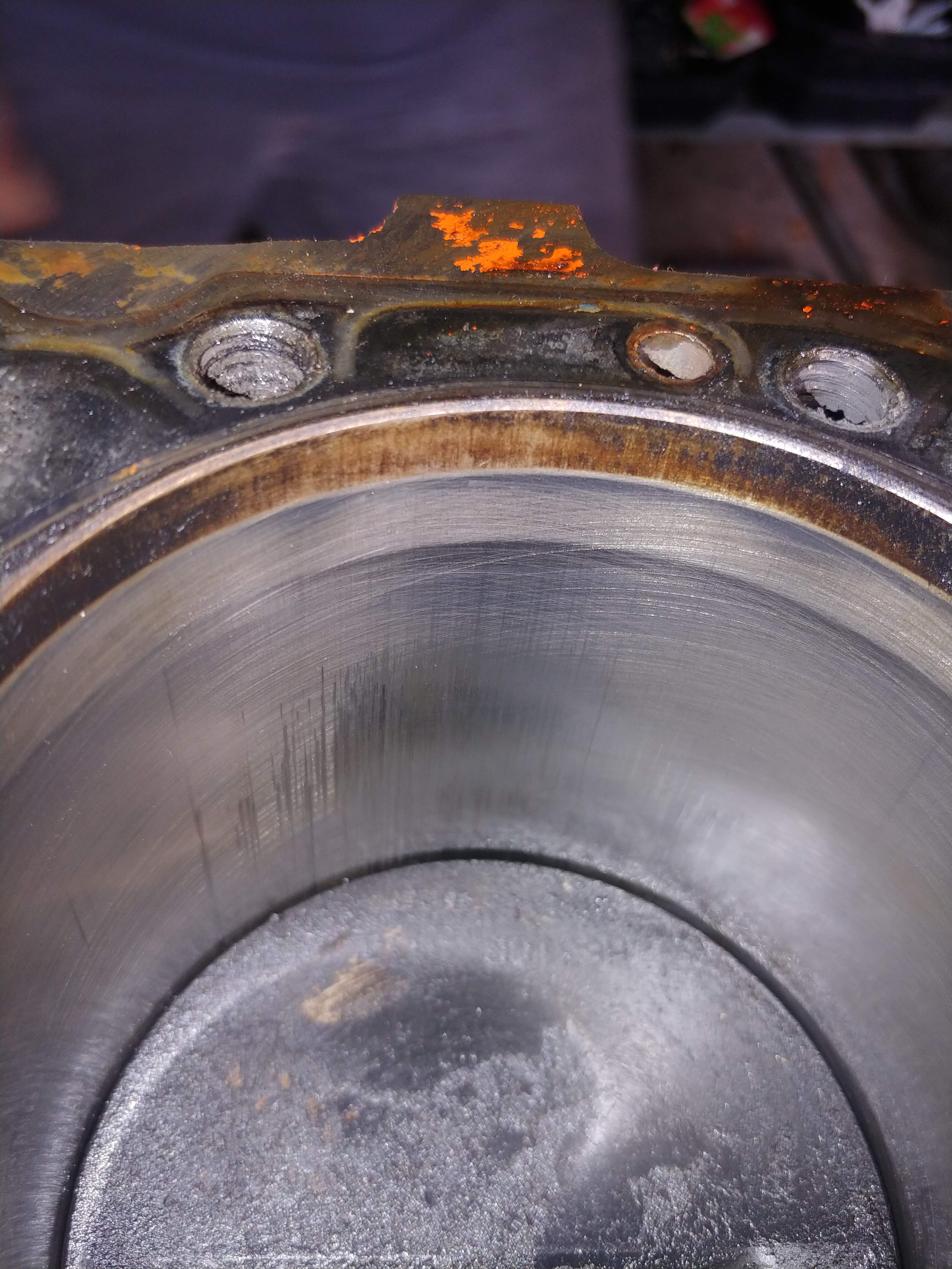

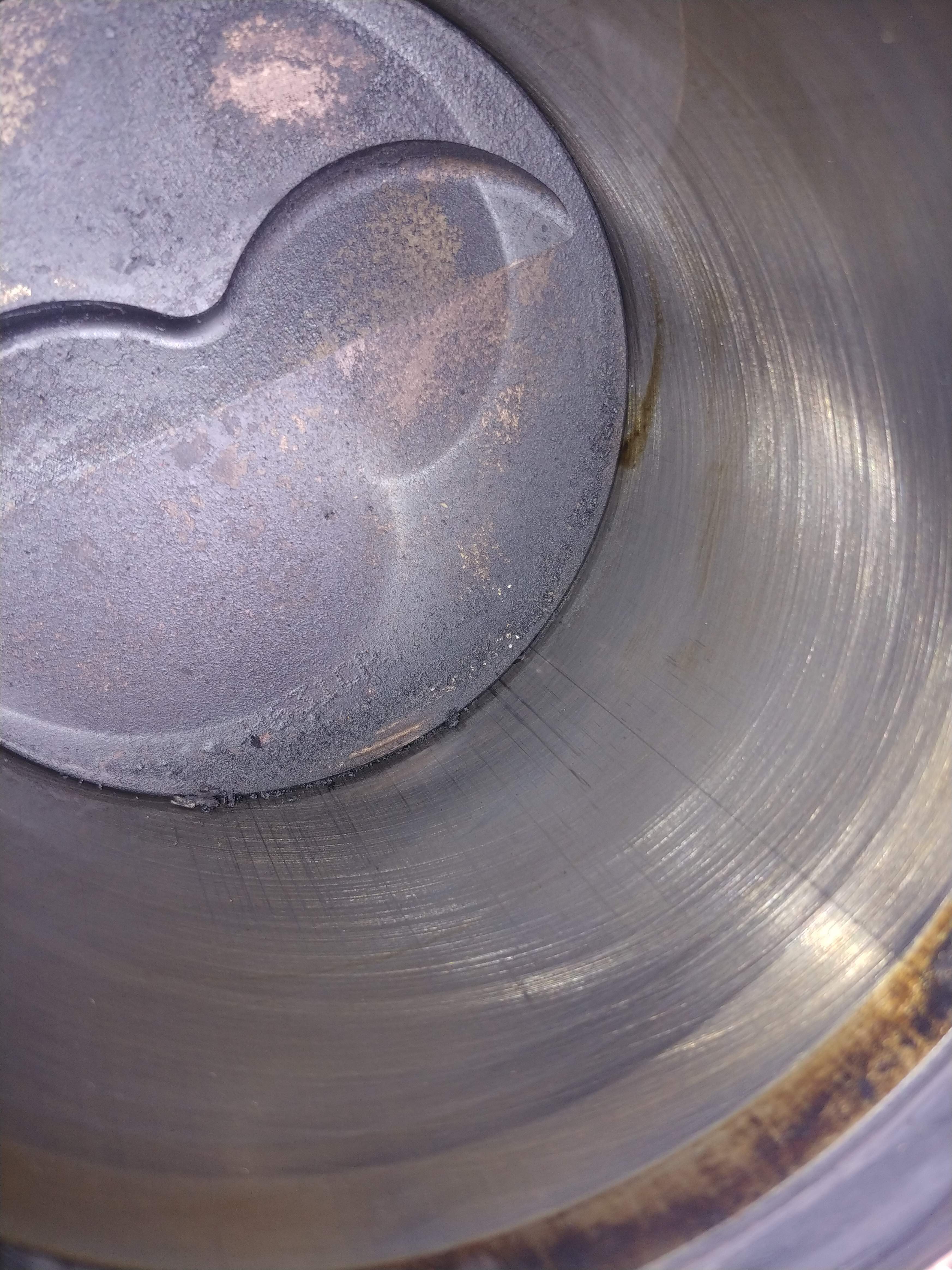

Unfortunately, it got worse once we took the cylinder heads off. We found scoring and deep scratches in cylinder walls all through the block. The culprit? the Damned Spectre Oil Pan. i think it's called a splash shield (?) that cracked and with the vibrations, the seam from the crack rubbed together creating metal flakes in the oil.
im praying that a simple honing could solve this, since buying new pistons for a new overbore, let alone get it to a machine shop, is not within my budget.

Curtis, just in case you’re unaware, you can buy oversized piston rings in incremental sizes, .003, .005 etc., but you’re going to have to dismantle the engine to hone it. In the end a bare block hauled to a shop and new pistons and rings may be the better choice. Honing can be tricky when it comes to true roundness and a straight bore! More often than not anything more than glaze busting will leave a block out of round and tapered.
Agreed. This is not the news you wanted to hear and it is a set back for sure. However, look at this as an opportunity to prepare and blueprint the bottom end correctly. You don't have to break the bank if you are building a strong street motor. Yes it will cost you more money and time than you currently planned for. However, once it's done you will say to yourself (and your friends) it was worth every penny.
Fix it right now and you will have a strong, enjoyable motor for years to come.
