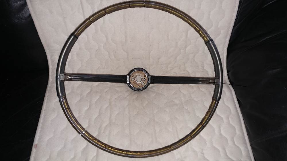

I am hoping there might be someone out there with info on the colors offered on the full sized Pontiac steering wheels. Particularly the ones with the chrome bar inside the clear urethane. I'll upload a pic. I'm having mine recast and is gray other than the clear part. The question is, could you order the wheel color to match your paint? or did the come in stock colors only. I'd like to change it but want to stick with factory offerings to stay with the restoration guidelines.1127171324.thumb.jpg.c29050c0eccbf428d94a8097d5978860.jpg
Unless there was an optional steering wheel (like the Trans Am Formula or the infamous wood grain steering wheels on the F and A bodies), the big car steering wheels were generally color matched to their interiors (or faux wood grain in later 70s and 80s). So if you had a red interior (even if it was a triple red), then you had a red steering wheel.
Now if the interior matched the paint, then I guess you've accomplished what you wanted. I suppose, back in the day, that some dealer would be willing to paint a steering wheel to match the color of the car to make a sale, but that was not a factory practice or option.

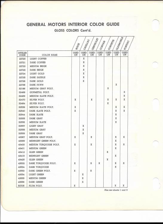

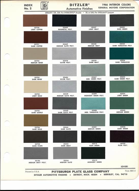

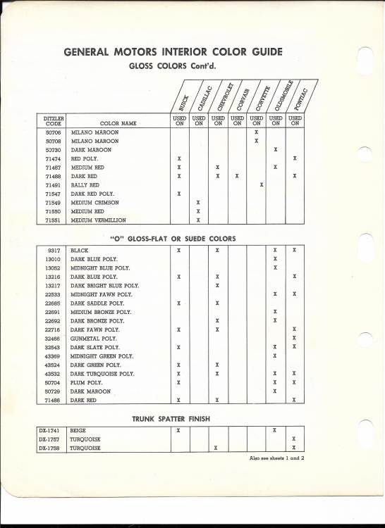

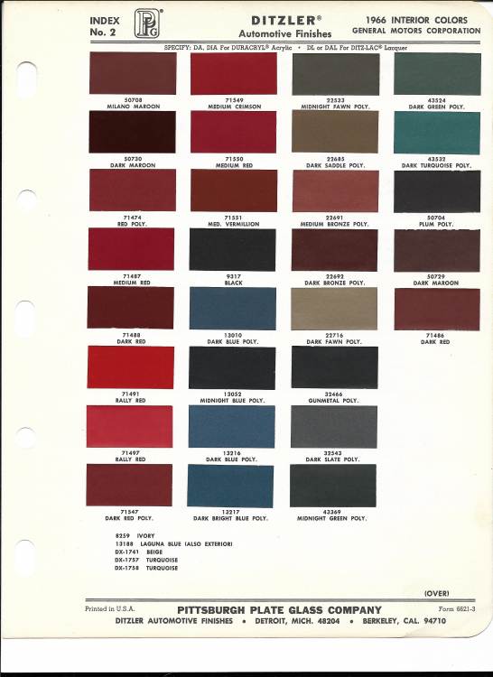

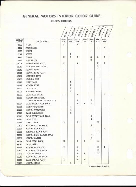

There was a wide range of interior color choices and all the Catalogs always had "Suggested" colors to accent your interior with the exterior color and the wheel was closely color matched to the interior but not always perfect due to the plastics and outside vendors limitations. So if one was wanting to change the color of the wheel I would think it would be based off one of the many interior choices in '66, So not far fetched but again not very likely.
  FWIW there were several paint suppliers for Pontiac. All working off the same palette. Here are the PPG/Ditzler  charts to give an idea of colors.
CHEERS
