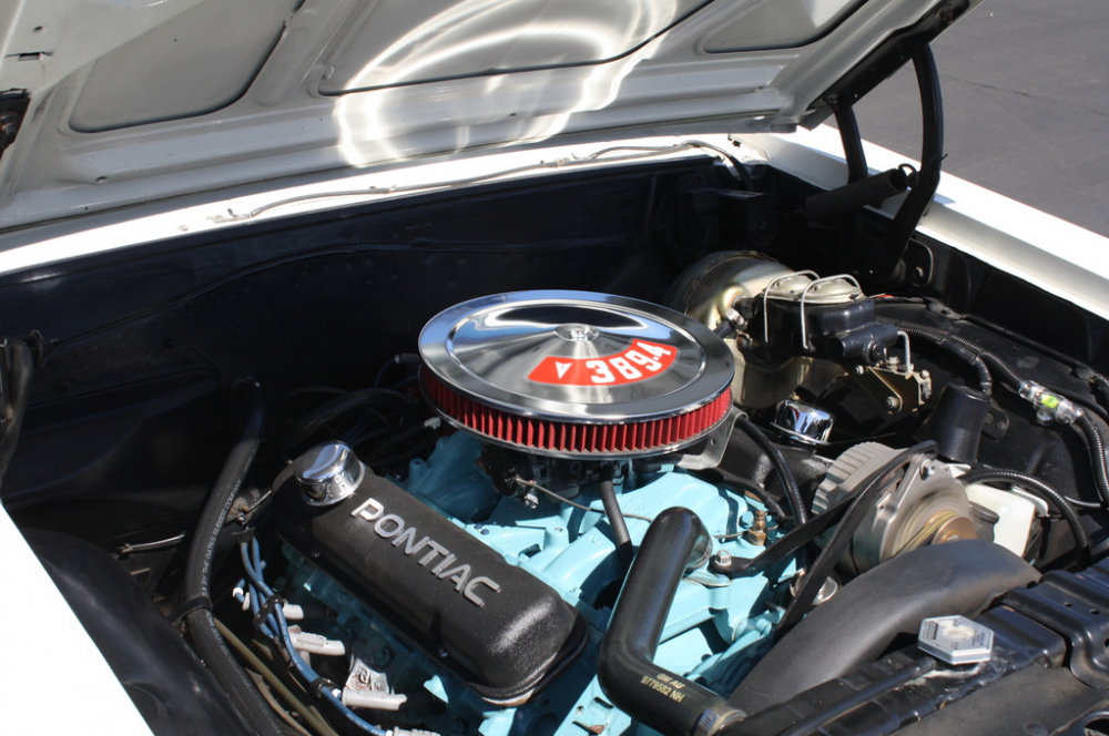

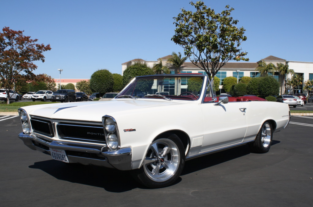

I recently bought a 65 LeMans convt that has a 389 and lots of options. Could you order a LeMans with a 389?5a1b2330481a7_ScreenShot2017-06-11at7_27_53PM.thumb.png.df1b1981bae5469867534a29e1c98101.png5a1b23393d807_ScreenShot2017-06-11at7_31_46PM.thumb.png.5f17c4a261925447e3f9fe0c1559c670.png
Yes you could but it was called the GTO option and would have been trimmed as such not as a Lemans.

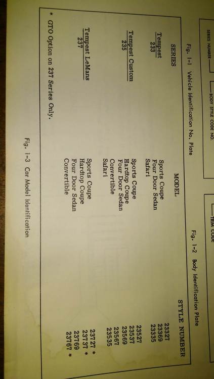

Agreed. The 64 and 65 GTOs were the highest optioned LeMans, as Sprint 6  stated with the GTO option added on top of the LeMans. So your VIN should decode as a LeMans, first three digits are 237. Then you need to look at the accessory codes on the data plate on the firewall and look at the fifth accessory code, it should be “N” for the GTO option. Then you should have a 389 otherwise you should have a 326.
This Car is definitely a LeMans with a 389 so I guess the 389 was added at sometime later. The engine was made a couple of months before the car and the car has many options so I thought maybe Pontiac was like Chev and if you knew the dealer you could get just about any combination. ( I worked at a Chev dealer back then) I don't have much information about the car, it was sold at the Mecum Anaheim auction Nov 16th 2012  and in Dec it went to Al & Eds Autosound in Hollywood for a very high end install which included Focal speakers, Alpine amps, Kenwood subs and a Rockford Fosgate processor along with dynamat throughout and a Clifford alarm system. Somebody spent a big wad on that install!  I would really like to know more about the cars history so if anyone out there knows the car please share the info. Thanks- Dave

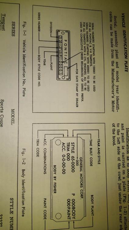

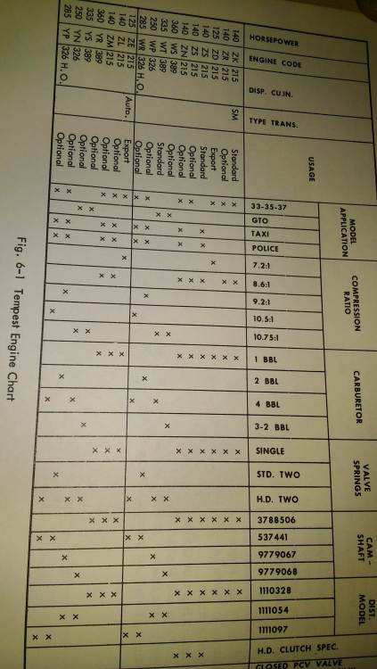

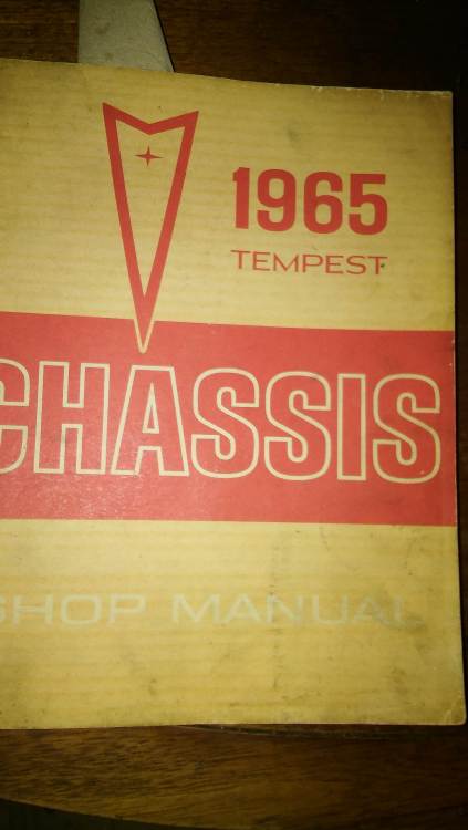

389 Only available with GTO option.....Hope these photos help....Nice car..Took pics with phone sorry they are sideways..... This is the actual manual put out by Pontiac division GM in 1965 not a reprint....
