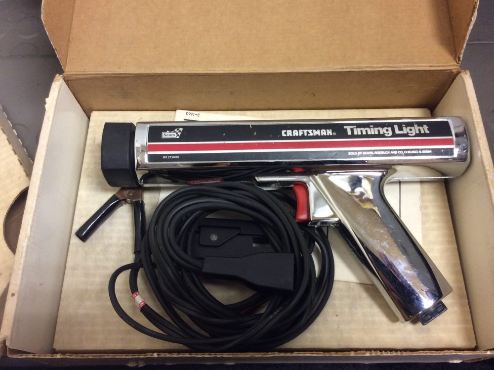

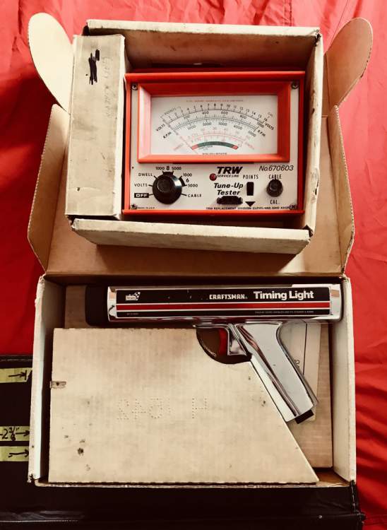

I got a box today that I wasn't expecting so soon, I opened the box to find not only a Craftsman timing gun but an added bonus that I've never held in my hands before or used but knew about and have been intrigued by how to properly use one. A dwell meter! Now most of you don't know this but may also have this newfound addiction....as I grow older, I find myself loving collecting old things like, car parts, signage, and OMG especially old tools! INDIAN? You've put a huge grin on my face and really made my weekend! I know its the simple things right? Now I am already geeked out by the timing gun but I'm over the moon with the original boxes and instruction manuals and patina on the items that you sent me. If anyone else is interested I'll post up pics of the Sears Roebuck box for the timing gun. Its all so very cool. I want to put it in glass display cases and put it on the wall!

I so glad you're pleased, I hope they work and serve you well as they did me. I cherish the memories that I made with them. All the years of racing, all the years of tuning some incredible machines. These are forever a part of me and I hope you make some great ones for you with them!

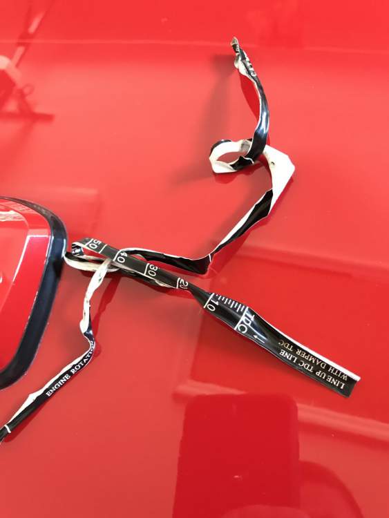

Oh and I guess they don't make timing tape like they used to. after about 20 minutes of the engine running while I was tuning the tape melted and came flying off in 2 pieces. lol.
Edited by 360Rocket
360, sounds good, fingers crossed for cold start. Never used the tape, but I can see it would be a problem!
