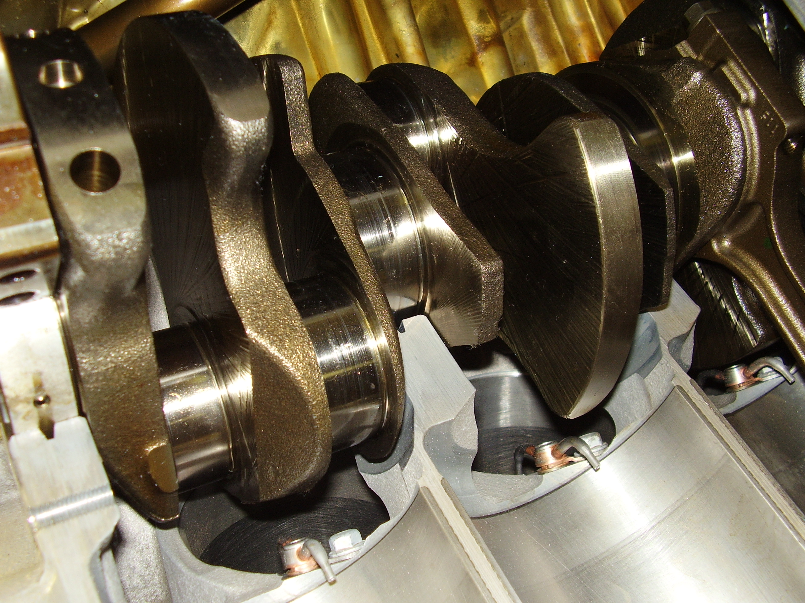

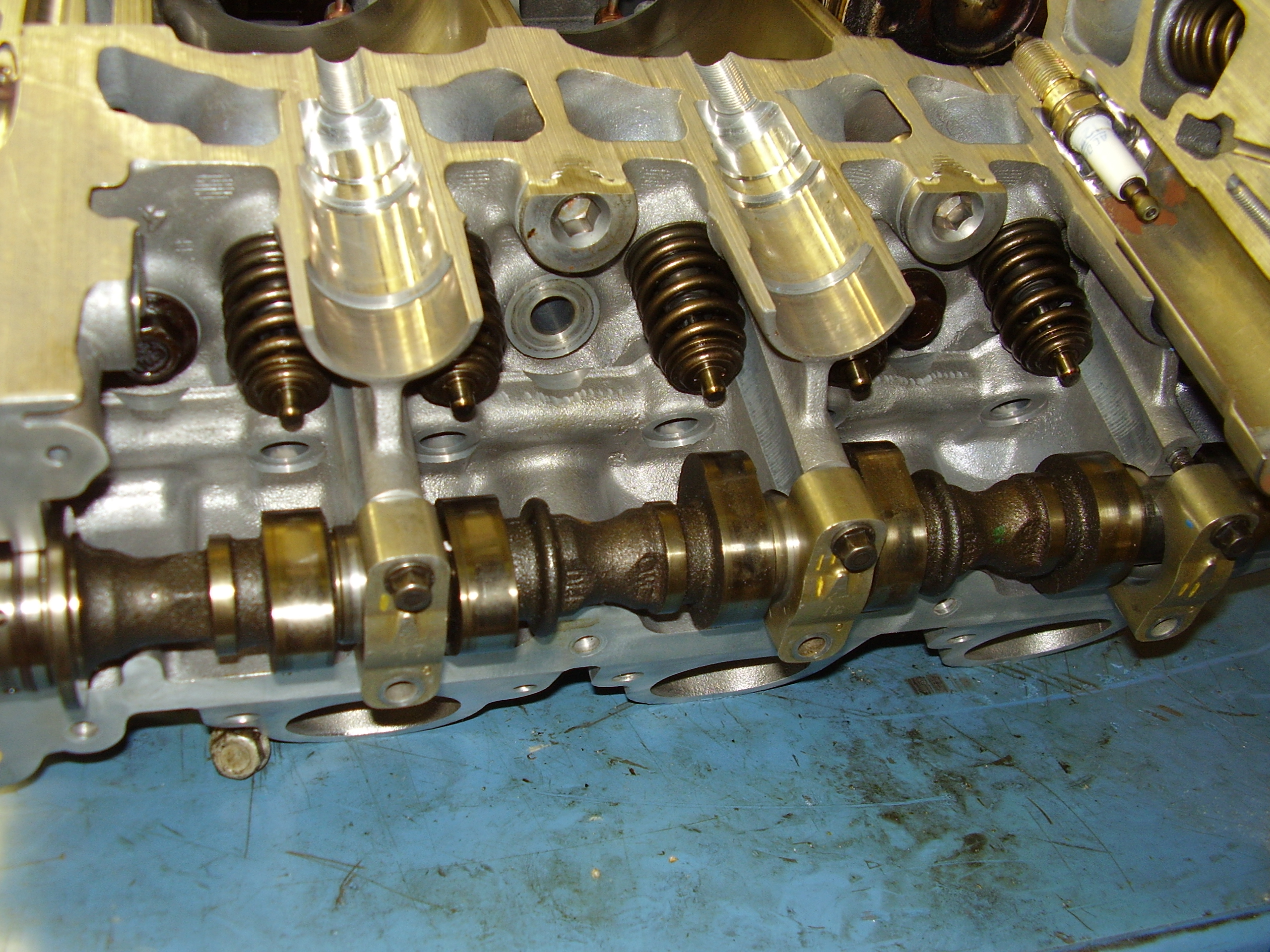

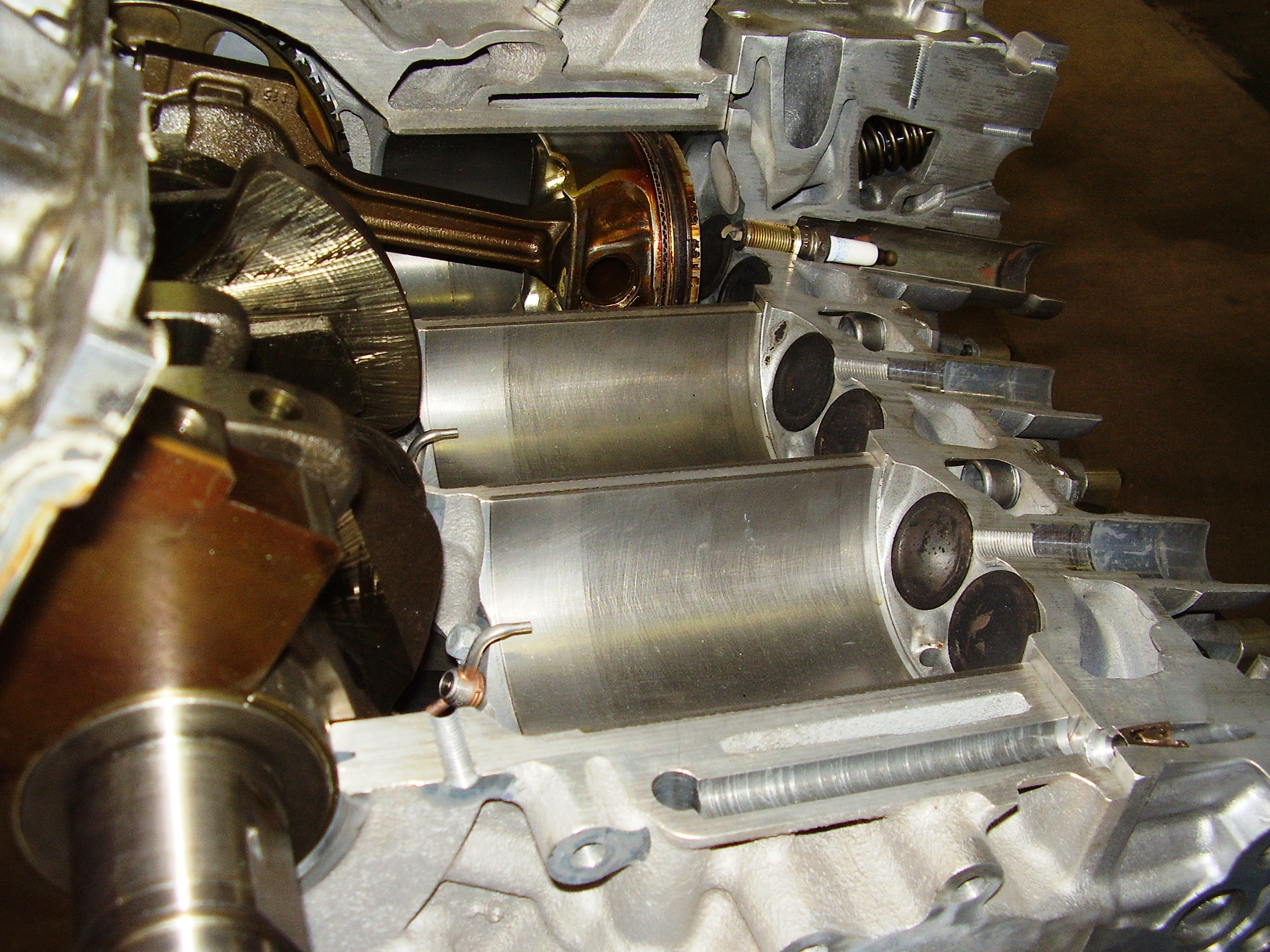

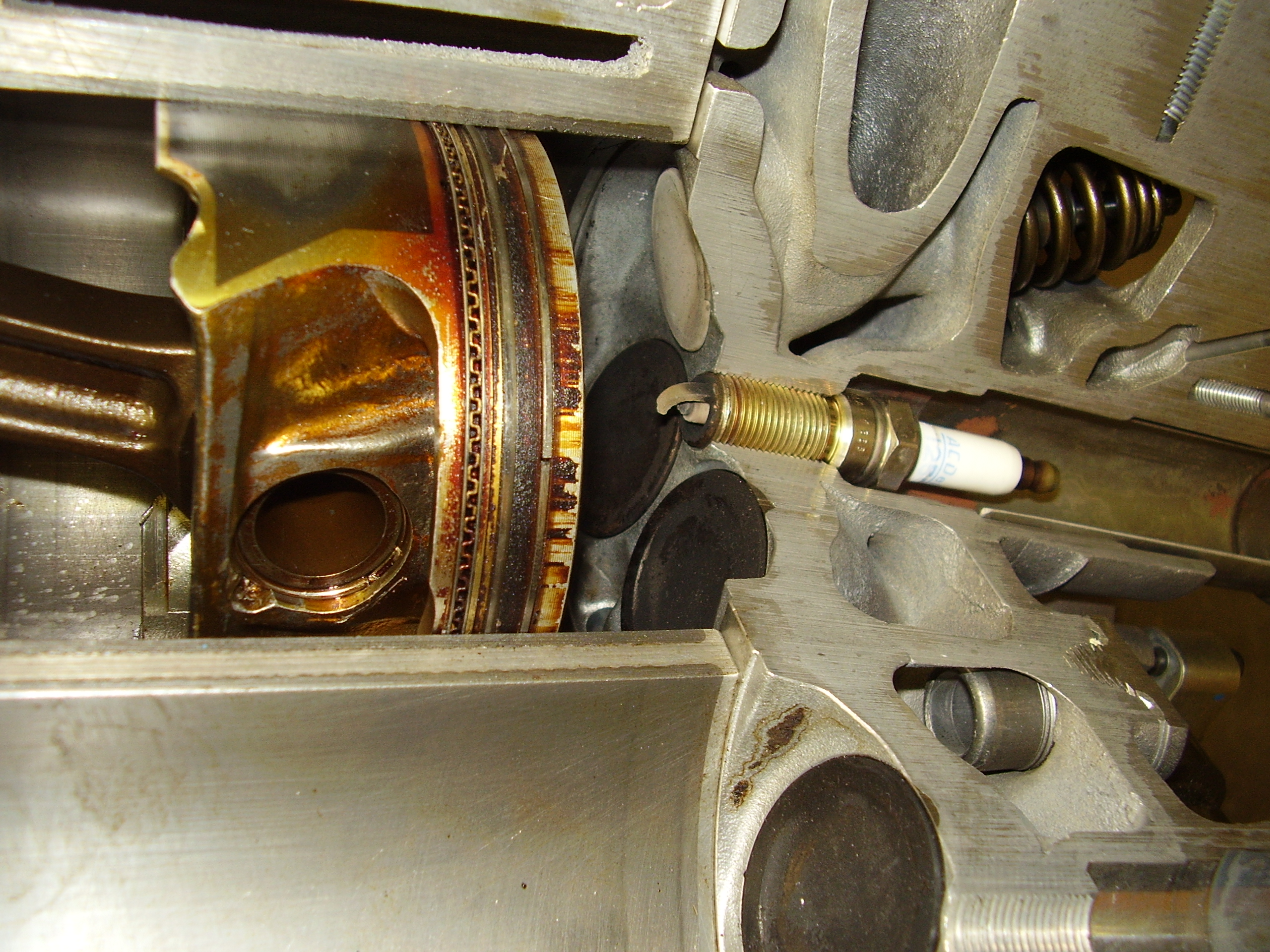

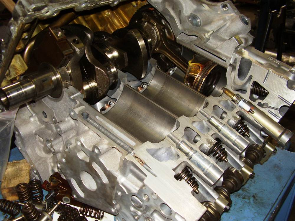

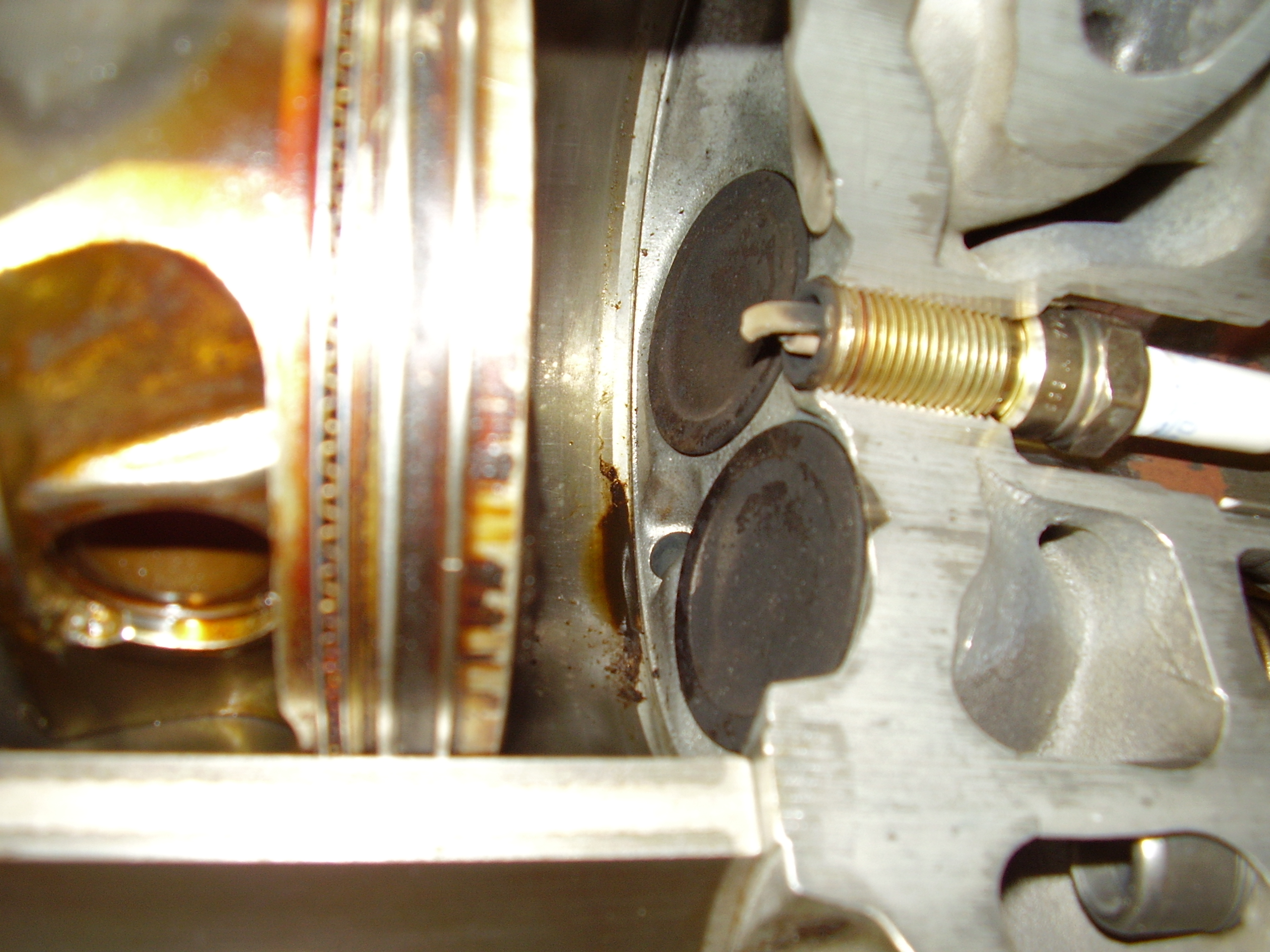

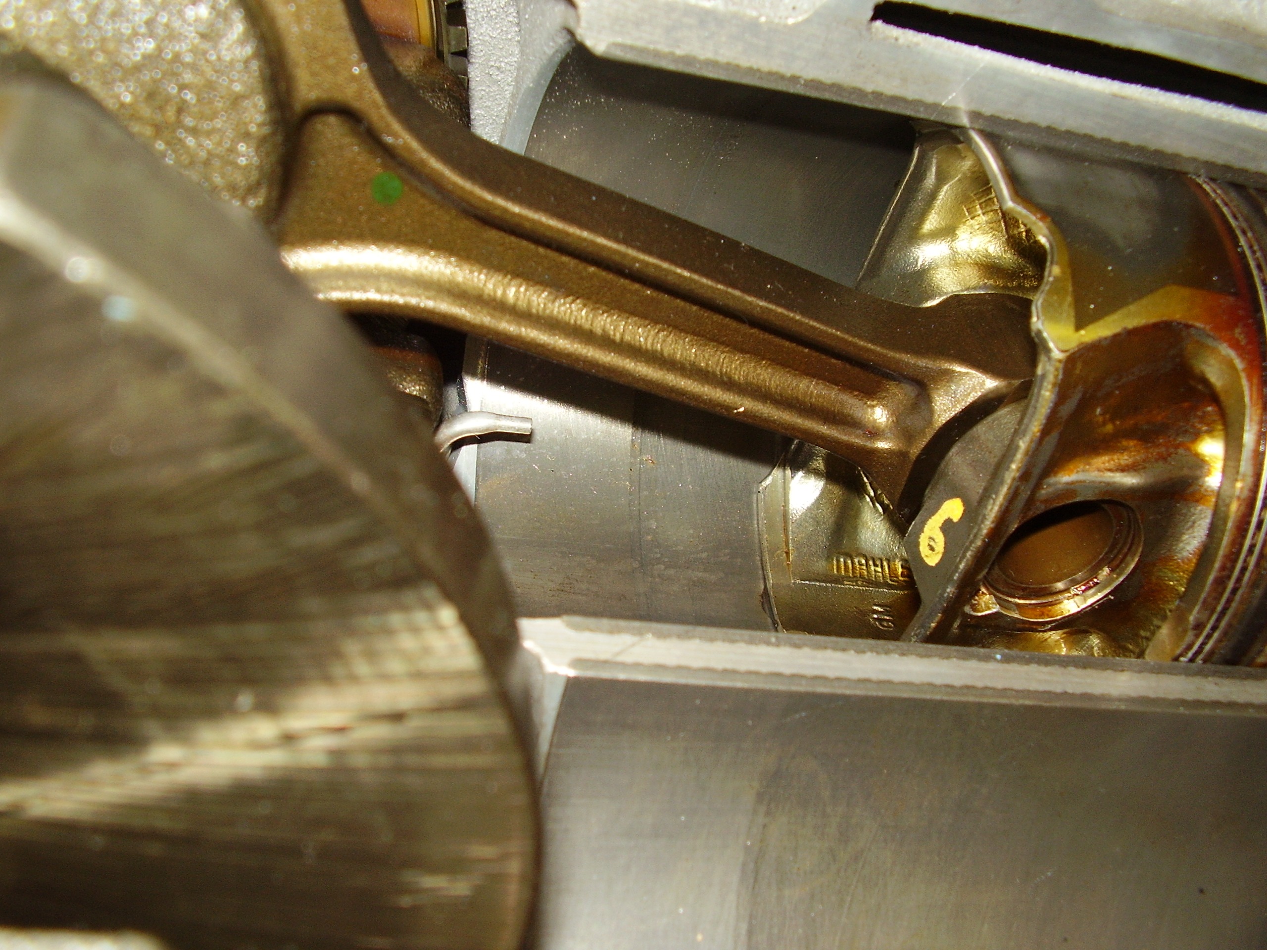

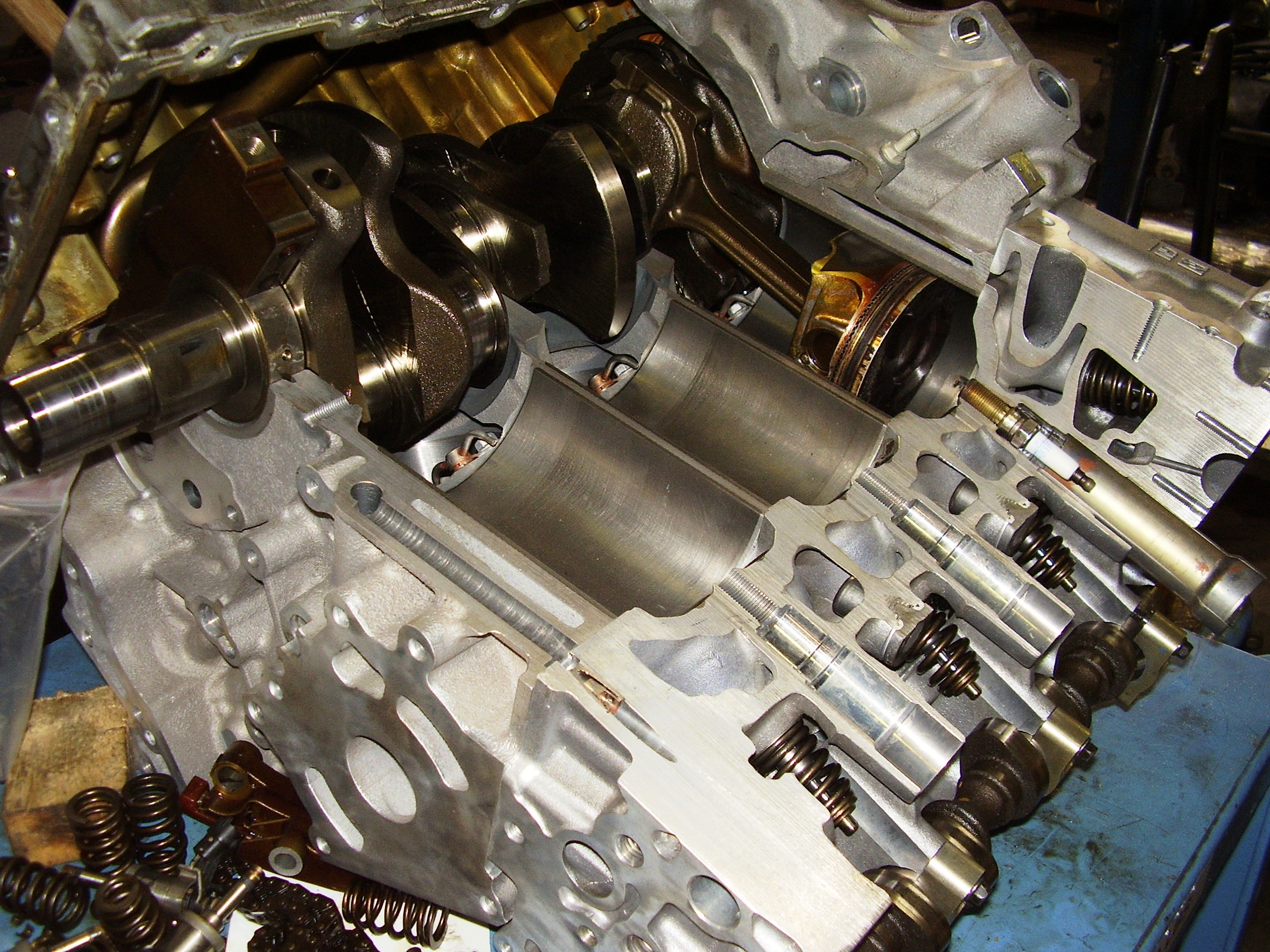

Just as a point of interest here are some pictures from a project I ran in late 2010 through 2012 on a 3600 Buick. Not sure how many of you have seen this motor sliced and diced.
