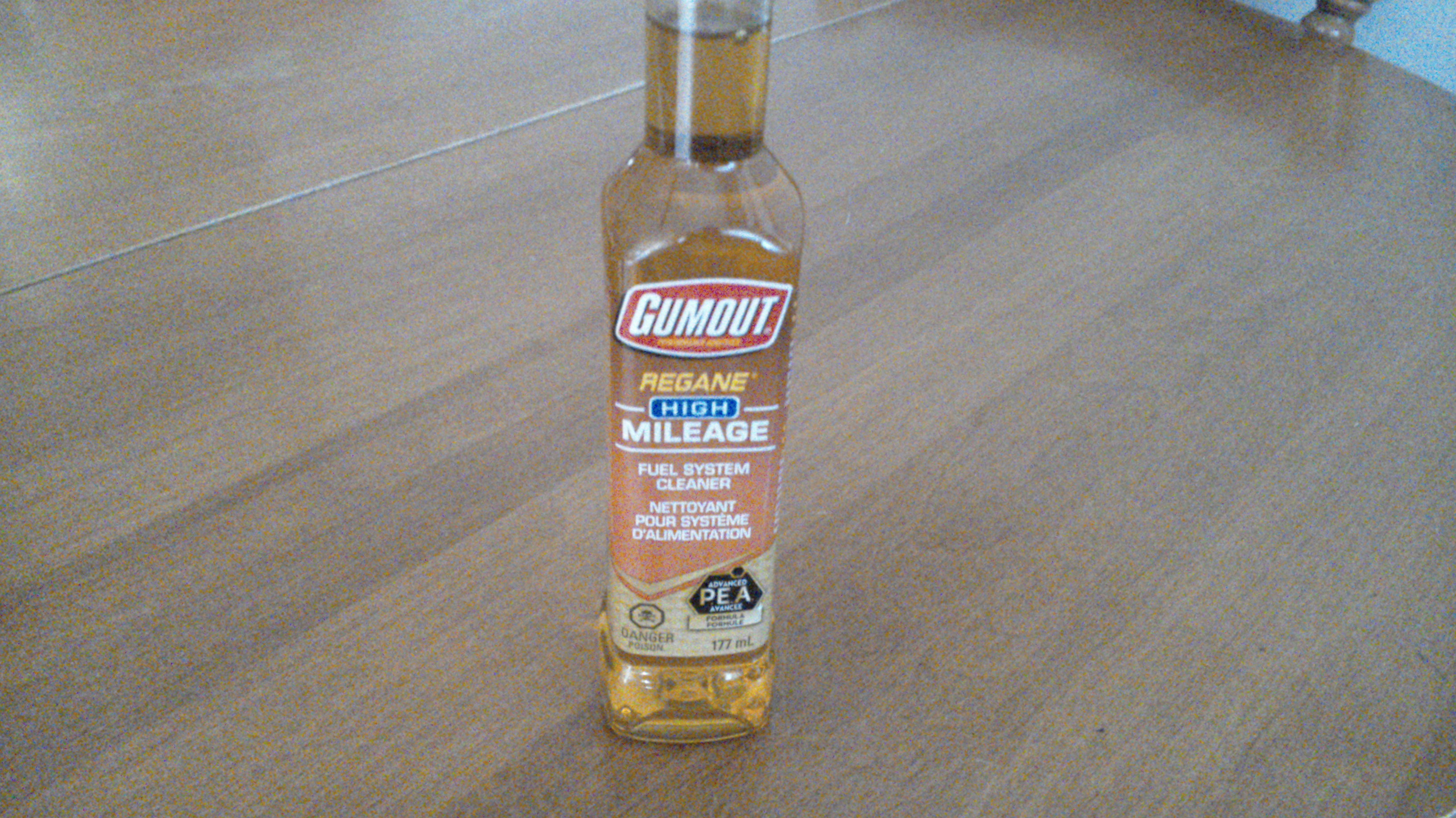

One bit of advice that may or may not help minimally with mpg, but well definitely help wth performance and continued maintenance of the fuel/induction system is to use a fuel additive that has PEA (polyether amine)in it such as Regain by Gumout. PEA is the highest end fuel additive there is and will cleanup many deposits and varnish that other additives won’t. All fuel injected engines suffer from the same issue which is that no fuel flows past certain components. Port injection is a problem, but DIC is the worst as it gets no fuel to the back of the intake valves. Either way deposits and varnish buildup is a problem in fuel injection systems. I can tell you factually that PEA works as I spent three years developing systems to deliver it for OEM use for warranty issues as well as a advisory role in the development of the chemistry.

well, I got me some of this. Hopefully it helps

Well, after adding additive and changing the spark plugs, two of which, had no diode left, am now getting 15 more km. from a fill up.
