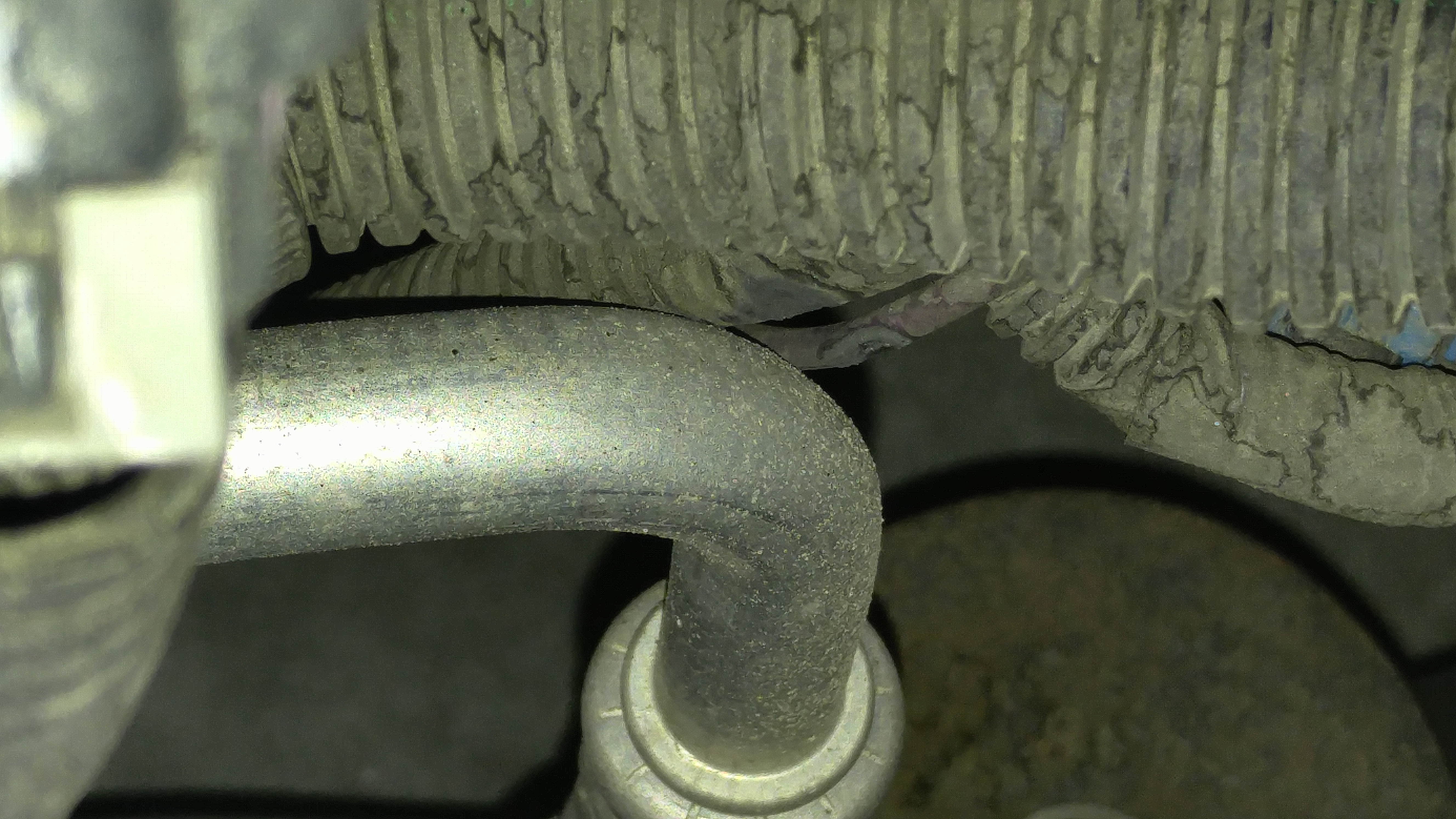

my G6 wont start. tried portable battery, tried car jump start. lights come on and gauges sweep like normal. stuck in a parking lot and its cold. what to check next? help! thanks.
i may have found an issue.

starter fuse was blown. and now the replacement is blown too. where to check next?
Sounds like something is either ground out prematurely or you have cut or broken wire in the circuit.
I would work backwards from the starter and work my way back to the ignition switch, checking to see if any wires on the starter are burned, cracked, or blistered. On Lucy, I had a situation that she would not start randomly. No clicking, no nothing. Turned out to be the negative cable going from the battery to the starter had touched up against the exhaust manifold, melted the cable insulation, and there was metal to metal contact with the battery cable and the manifold that was grounding out the whole system. So check all the starter/engine leads that you can first since they come in contact with the most heat first. Next you will have to move under the dash for the same thing.
Do you have a wiring schematic for the G6? If not, I would look for one online so you know what color wire(s) you are looking for both under the hood and under the dash.
Also, any chance the starter itself is bad? DItto the ignition switch (all assuming you find no wiring abnormalities).

What was the prob?
Looks like that picture he posted showed a wire grounding out/shorting. Lemme guess. You wrapped in in electrical tape? :D
this.
maybe. i also moved the wire away and zip tied it.
