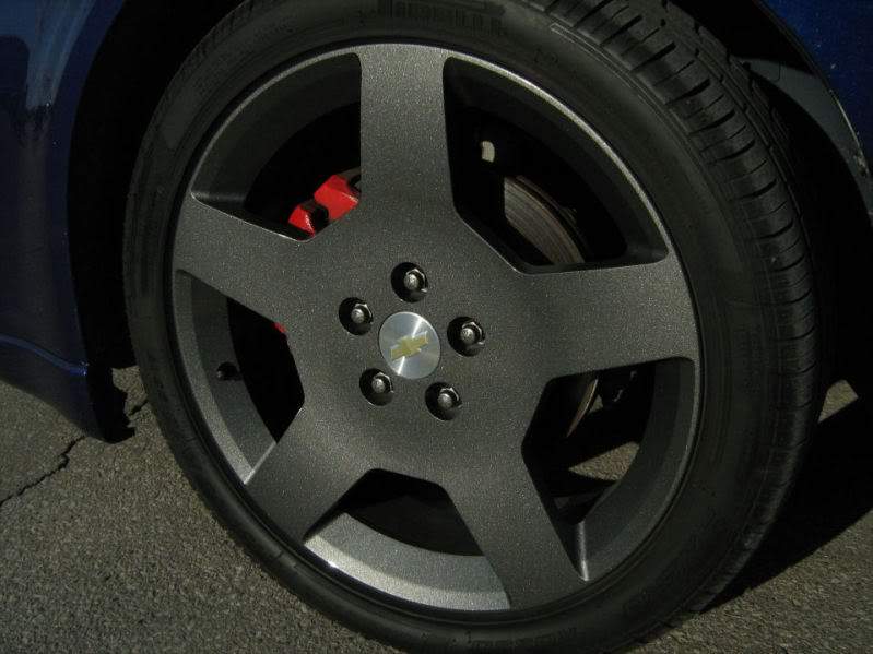

Does anyone know the reasoning why some of the G5s and Cobalts are 4 lug rims and others are 5 lug? It almost seems random to me. Some 4 doors are and are not, some of the 2 doors are not but all of the SSs are 5 lug rims.

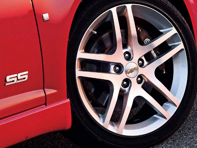

(coupes or sedans) SS TC or SS appearance pk & or the rim 18" rim pk. All 3 have the 18" rims and require 5 lug. :agreed:

All LE5 equipped Cobalts, whether it's a base or SS has the five lug hubs. While all L61 equipped Cobalts use the four lug pattern.
And of course, the Supercharged and Turbocharged Cobalts have five lug hubs.
