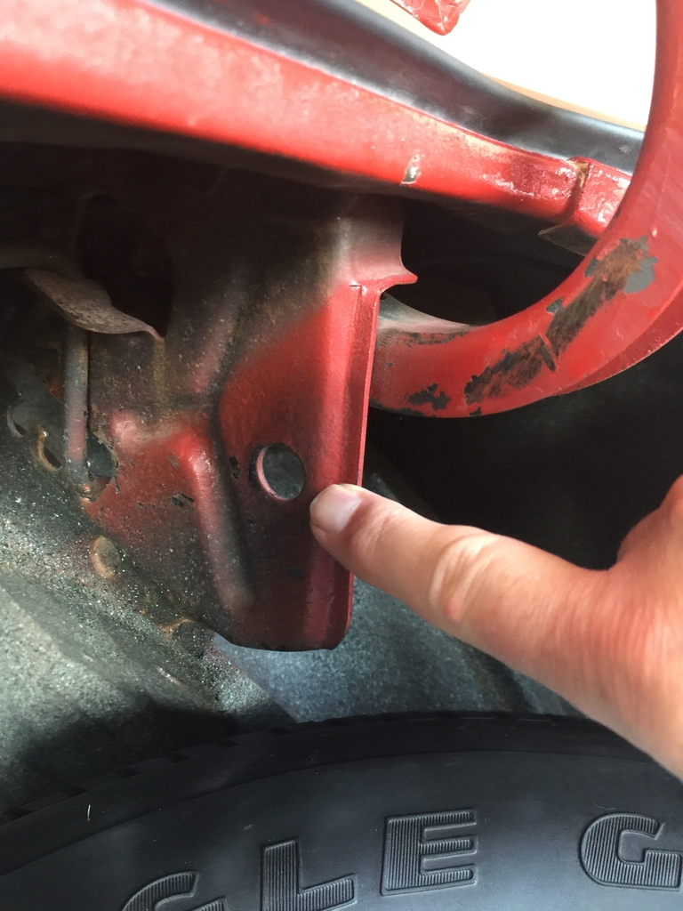

This hole is on both side of the trunk support and just under the trunk hinges when the trunk is open.

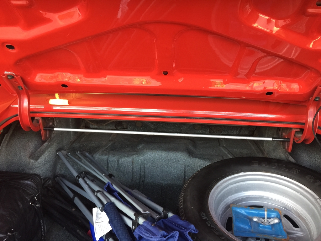

I found at the local hardware store for $14.99 a 4 foot hollow steel bar 1/2" OD that I hit with a spray can of paint and the added a few inches of heatshrink to each end.

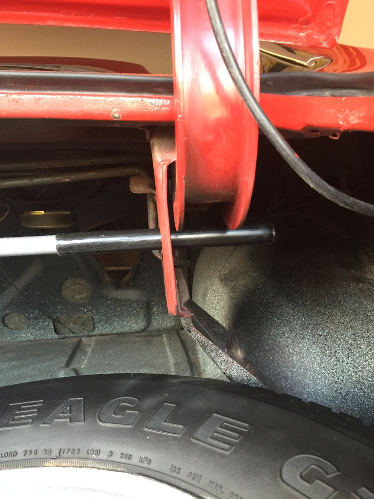

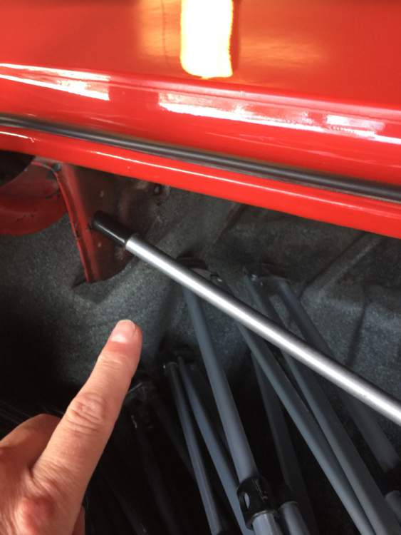

Insert the end of rod into each of the holes below the hinge as shown.
Most showgoers will be hardpressed to even notice the safety rod when it is in place. Most will think it is part of the car.
With the heat shrink in place, and the weight of the trunk on the safety rod, it will be hard pressed to shift out of place. It's really cheap insurance IMO.
that's cool. A very good idea.
Someone will "want to help you" and force your trunk closed.I like the idea.maybe use balsa wood? something that will give.
