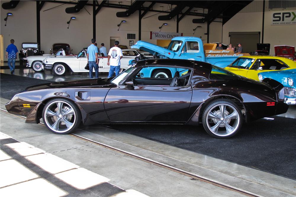

Actually Havoc, the term "shaving" is a car kustomizing term (not a typo) which means to remove things like door handles, chrome or stainless trim, drip rails, emblems, or other things on the car in order to emphasis or enhance the lines of a car (or truck). The idea, as Ghost said, is in order to achieve a smooth, often minimalist, overall look. This practice has been around since the late 1950s. Hot rods and lead sleds are the most often users of shaving, but they are not the only ones. Notallthere is currently shaving the drip rails off his FrankenChevelle.
As you can see from Ringo's example, the results of shaving can be quite stunning.

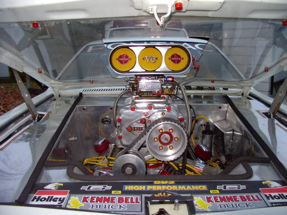

Does a shaved hood latch count?? Changed the Sunbird hood to a trunk release. Push the button to release, then hit the up or down button for the hydraulic's to raise/lower hood. Added the clear insert, so you can raise the hood while pulling into a cruise nite, and still see to get to your parking spot. Every head in the lot is turned because of the blower noise. Give em a show!
Well seeing where you need to go is important :P
