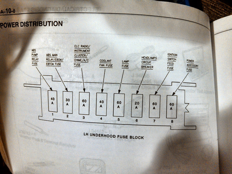

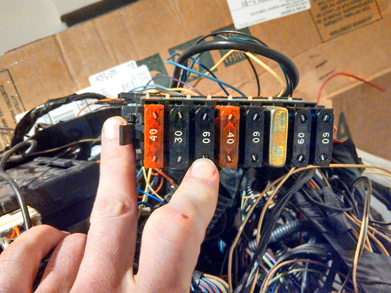

I know you said fuses are all ok but that grouping sounds like one of the main fuses in the engine bay popped. Theres 2 groups of large fuses on either side of where the positive side of the battery connects at the top of the engine bay.
It might be different on your 99 but on my 95 on the group closer to the driver's side, it's the 60A fuse 3 positions from the connection to the battery.
