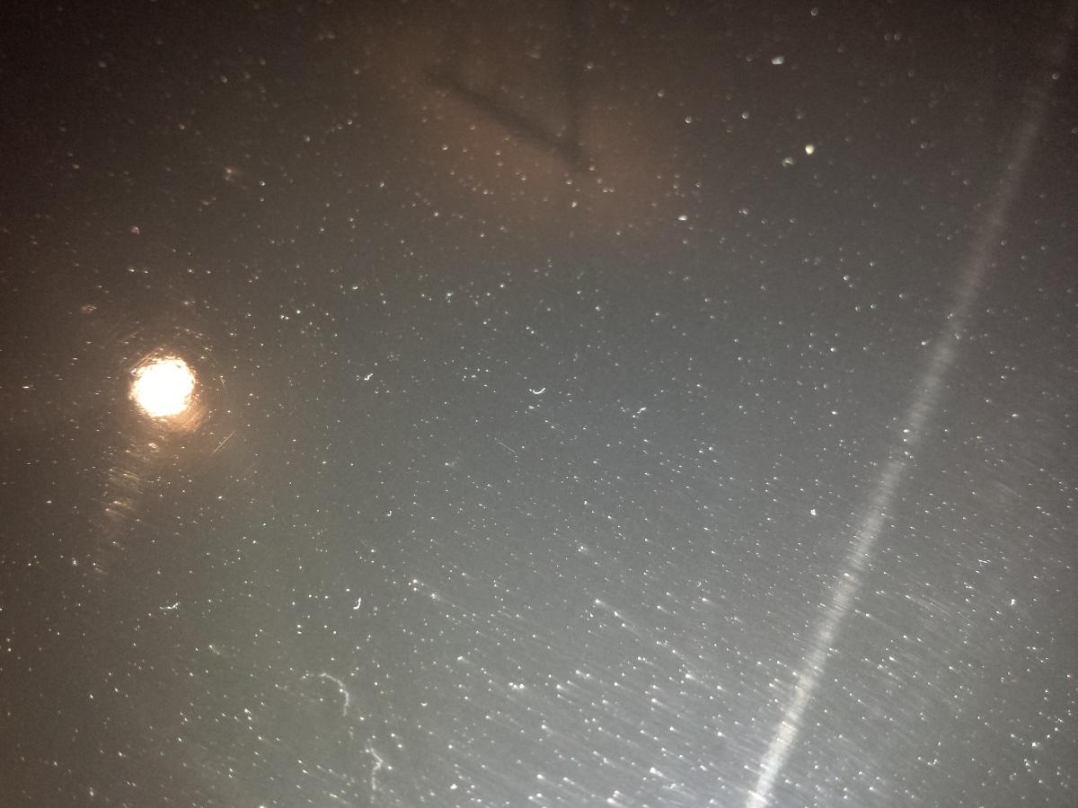

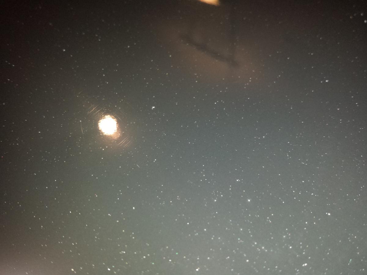

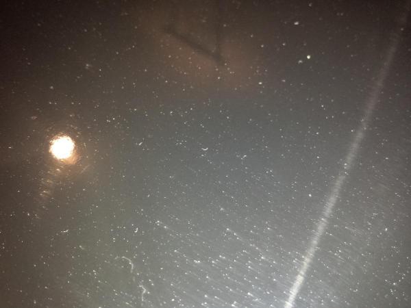

so my cars paint is needing some light attention. its a few years old and want to try to make it look more like it was new. the surface feels lightly rough, like tiny specks. also, i did some spray painting near by and may have added a few more specks to the surface. i have, and tried, Meguiars compound. but didnt do much. guess i need to do something else before that step. thoughts? before and after pics.
Looks like it might be in the clear coat. Have you lightly dab'd it with a clay bar?
