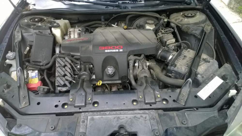

My plans are to insall a CAI, Colder Thermostat, Colder Spark Plugs, and a 65mm Throtle Body. I kind of like the exhaust factory, but if anyone has any suggestions, I am always open to hearing them. I would like to paint the front motor mounts, the support bars, the heat wrap, plug wires, and cold air tube green possibly. I would also like to repaint the calipers green, but not sure yet on the color.

nice! only 60k? cool. jus need an engine bay cleaning.
congrats the the purchase, i reccomend getting headers and forget about the throttlebody, dont do colder plugs until you have a smaller supercharger pulley
I was planning on smaller pully. Any recommendations on size, i was thinking 3.4.

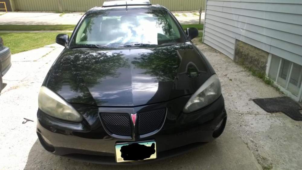

You need new headlights. Those are all fogged up.
Yep leds with halos
Ew...Please do not do that. Just black housing lights.
a 3.4 will require valvetrain mods and headers to be run safely, once you get headers you can possibly drop to a 3.6 aslong as you have a scangauge and a tune.
Ok so just so you know i was kidding about the lights! Ha ha. I would like to do a new exhaust with headers, but i cant seem to find any that work with my model. Ive looked on 3800performance, horsepowerfreaks, and carid. It will be a while before i put new exhaust on anyway. So if that's the case what size pully can i put on without having to mess with the pcm?
the most i would do is tint the lights i have now after i clean them, i like the lights that are on it.

All Headers for 97-03 grand prix will work on 04+, i reccomend Speed daddy off ebay ( usually can get them for 200 shipped), With any pulley drop i recommend a tune because since your adding boost you need to let the computer know about it, Also These cars require 91+ octane Stock and running 87-89 will blow them up ( most people dont know this), Good sites for aftermarket parts for these cars are ZZPerformance, Intense racing

A dyno tune would be your best bet, but make sure they know 3800's, if you got anymore questions lmk, if you want to get a little bit of performance and be able to hear the supercharger whine, Then remove your airbox and but a cone filter on the end of the stock tubing, cold air intakes dont do much for these cars because the blower will heat the air anyway

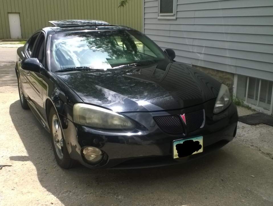

Your paint is looking like mine. I'm about to do a correction on my paint to give it that factory shine again and get rid of those swirls. Thinking it might be a good idea for you to look into it as well.
Ok so here is what i bought so far. 3.4 pulley, gatorback supercharger belt, nkg plugs(one temp colder) mds street fire wires, 180* thermstat, and soon a CAI.

I very highly recommend getting that pulley exchanged for a 3.6 unless you feel like replacing your motor, also dont touch the pulley until headers. other wise you will be looking or a new short block

that .2 is around 2-3 more psi, On my generation of 3.8s/c that would be fine with just headers and a intake and tune, but you have a bigger blower a 3.6 = a 3.4" on my engine, a 3.4 on yours = a 3.2 on mine, for a 3.2 to run safely you need valvetrain work or a intercooler, you need flow mods to get the air out of the engine before cramming more air in, if you were to put that 3.4 on your car without a IC or valvetrain mods, you would chip a few pistons. Headers alone will net you 10-15whp
Ok i will return 3.4 and get 3.8 and the headers.
