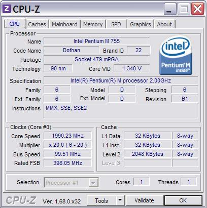

interesting. so for the Satellite, its W XP 32bit with 2Gb max, 2 slots. would going to 64bit XP allow the full 2Gb or go up 4Gb or not all? or a newer OS allow more? im not doing any if that, jus curious if it would change. and yes! clean it. one if your heat sinks looks clogged.
It looks like you have single channel DDR2. You can get 4GB out of that 32bit OS. If you do get a 64bit OS, you can add more. Since its single channel the max you can do is 8GB (2x4GB) due to physical restrictions on how many sticks you can actually put in.
so the Satellite seems to be working jus fine with the upgraded CPU.

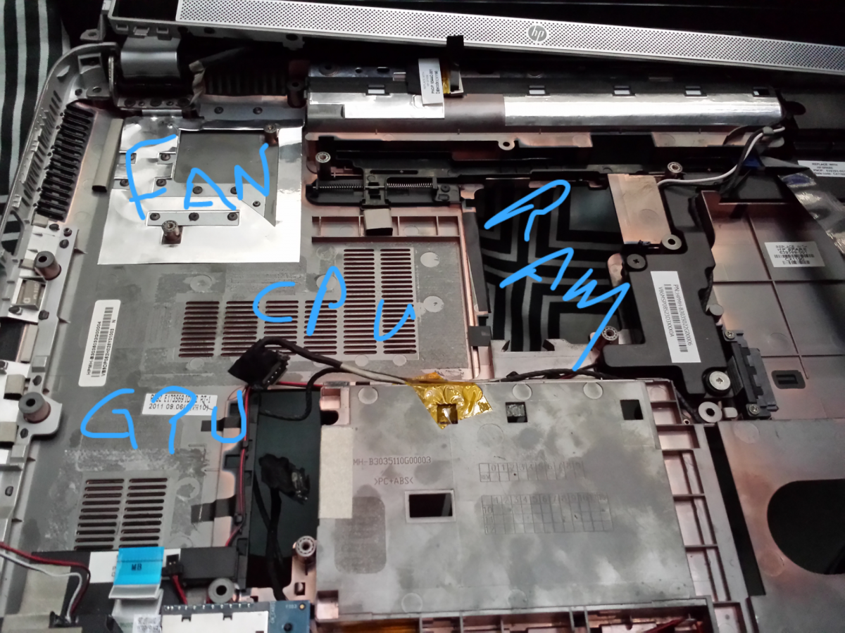

so my DV7 does not have direct inlet vents for the fan like the Satellite. would adding a direct inlet ruin the cooling design? the vents it has are about 2" away near the GPU, like on the CPU and on the RAM.
bump for my last question.
Probably not, most manufacturers just slap it together and put a vent or two on the side/bottom. As long as there is an inlet and outlet that allows flow over critical parts (CPU/GPU) you'll be okay.
heres the layout. RAM also has an inlet vent. fan does not. i thought about drilling holes for the fan to have direct "cool" air instead of possibly warm internal air that has passed by the CPU and GPU. or dont bother?
The number one thing I hated about older laptops and some newer ones is the cooling was never sufficient. Couple friends old HP's fans were crap, clogged and sounded like lawnmowers and overheat. Anything that would be beneficial to the fan is good. Keep in mind though, especially as this is a laptop to protect any openings you create as having a clogged inlet or outlet for the fan is counterproductive.
