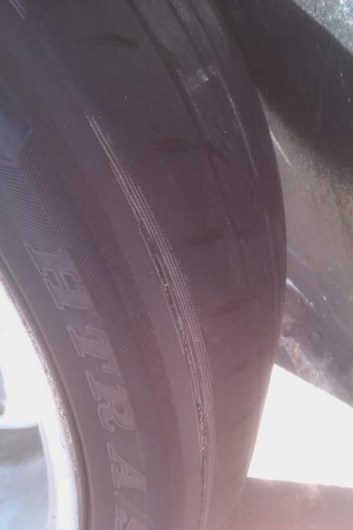

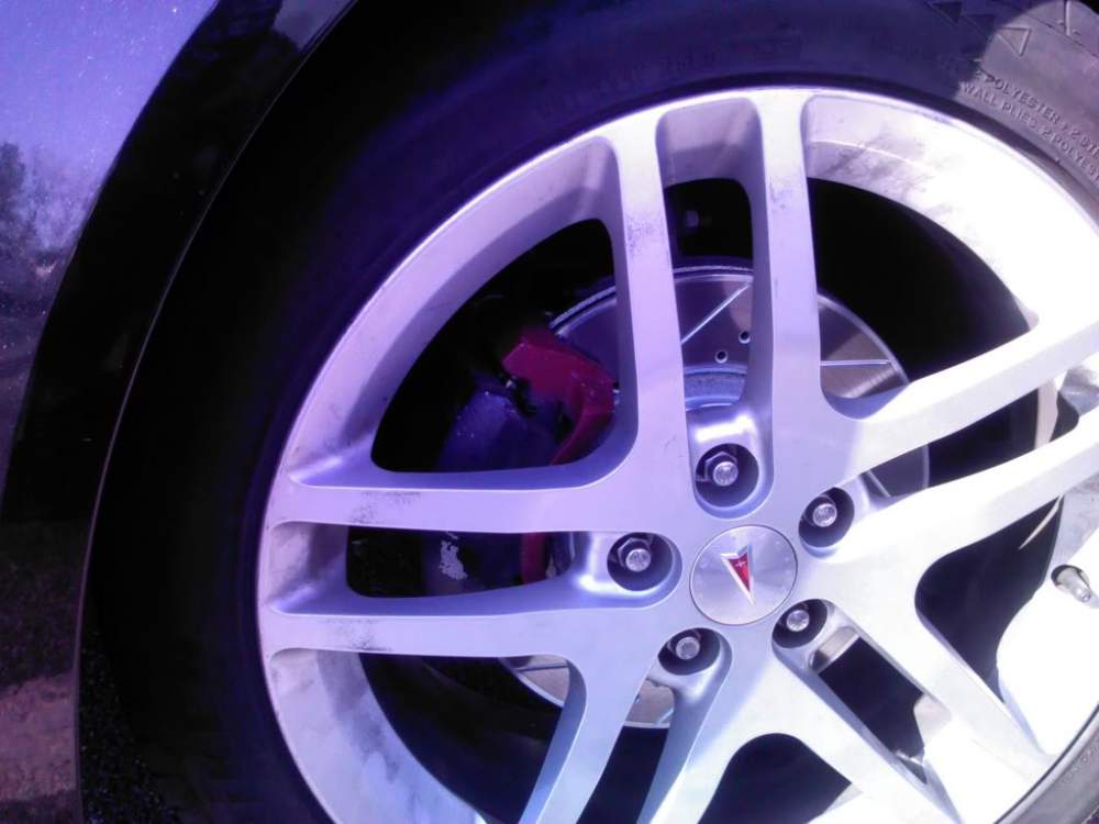

Well I got the rotors..well the fronts on. The lower grills too. So dont go 225/40 stay at 45 or 50 because this will happen. I am glad I did my rotors this weekend so now I bought used Riken Raptors with more than 85% tread left on them for 60 each after tax and mounted.

Uh, your alignment is off, bruh. Tire size has nothing to do with improper edge wear on your tires.

This is not wear that an alighnment would do. If you saw it the whole inner front wheels were like carved with something rounded and I was thinking the bolt holding the strut ( i think). I didn't mean to jump in words either my b.
yes it is. you camber looks to be off. if it was rubbing against something you would hear it and feel it. my van did the same thing.
i mean when i would parallel par i could hear and feel it o well ill get it adjusted
take the wheel off and look into the the wheel well and look for any signs of rubbing just to be sure.
Dude, the camber is off. Too much positive camber, do you even rotate the tires? Those looked wiped.
nope i didnt lol well this blows ill see when im getting suspension then decide when to do the alignment
and until then you will keep eating tires
Rotate the tires every 7,000 miles, FWD cars will eat tires if you don't rotate the tires every 6,000-7,000 miles. C'mon man, that's basic knowledge...
' timestamp='1330569796' post='67632']
What about RWD?
What about RWD?
That heavily depends on driving habits, and proper PSI in the tires. But half the time, the front tires will wear away faster than the rears if not rotated.
Bottom line, as long as the wheels and tires are not staggered, rotate every 6,000-7,000 miles.
