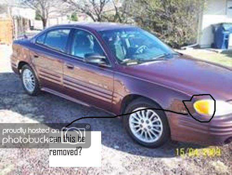

does any one or tried to remove the amber corner in the stock 99-05 grand am headlights?
might be possible. it is possible on the 6. so probably.
The amber lens is attached to the main lensitself, not the housing. Either way, you gotta crack them open for removal.

but it can be done?
I suppose, it'll look funky without a corner lens. Can't find a set of black housings, at all?

Yes, it can be removed. You bake the headlights in your oven to heat up the "glue" that attaches the lens to the housing.
Then when the time is right, you pry it off, and play around inside. This is how I made my headlights black.

Get ur headlights (amber section) painted colormatched to your car. :angry:
or use VHT nightshade to tint it.
thats wut i really wanna do it be sick
that overlay link I posted also had tinted ones "Dark Smoke (67% light transmission)" and that would be eaier that spray tint. :dancingpontiac:
Since the lens in inside the housing, use the hobby tint I use for tinting:
Racing Tint, pt # RC-294
Like six bucks a can, available in almost every Hobby store.
