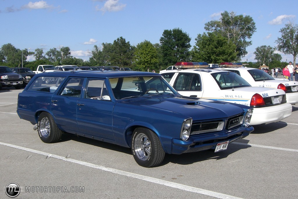

I'd love to find a 60's Pontiac Tempest Wagon to build, probably go the retro-rod route and make it into a road course beast.
1965 is the body I'd probably get.
That's cool Chaos. I like the pro-touring style in the first place. Personally I would rather have the classic Coke bottle shape of the '68 - 72 wagons myself. I saw a rare '71 Lemans Sport Wagon at a car show last year. The guy had a For Sale sign on it for $15k on it. I walked back to the car later in the show and he had uped the price to $17k. I don't think he was that serious about selling it. I agree with you, wagons are neat. I saw a gorgeous Buick Sport Wagon last Christmas that was all red with the Vista Cruise package. It really looked cherry (pun intended).
Here is that Lemans Sport Wagon. When this picture was taken it was still at $15k.
Wagons of any model are cool to me, whether it's a Subaru WRX STi Wagon to a 60's Tempest Wagon.
That is a gorgeous example...but that hood scoop, ugh.
The hood scope is a clear throw back to the early 60s hood scopes that you could find on the Catalinas and Bonnevilles in the day. It's not my cup of tea. The hood tach is fine, but a repo Ram Air hood would look better, perhaps with an Endura front end too. This wagon does have the factory console automatic shifter too.

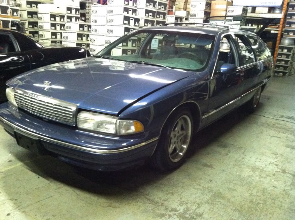

At my job, we have a 1994 Chevy Caprice Wagon, it's in pretty good shape...minor rust issues. But what makes it interesting is that it's an LT1 model. We've lowered it with Eibach springs with Tokico shocks and threw a set of ROH ZS wheels on it, 17x9 with 235/55 R17 Sumitumo HTR A/S P01 rubber. Looks pretty badass if you ask me. Not to mention, the last of it's kind to come out from GM.
I believe the Roadmasters were known to commonly have the LT1 more than Caprice wagons...
