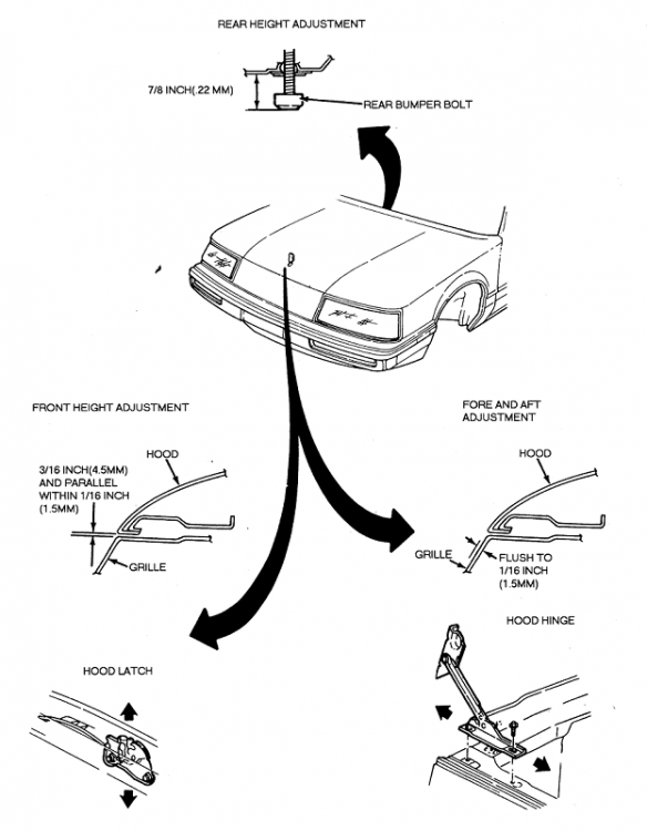

Fore and aft adjustment may be made at the hinge-to-hood attaching screws. Vertical adjustment at the front may be made by adjusting the rubber bumpers up or down. These adjustment may require several steps. Take care to lower the hood slowly each time. If the hood is closed hard when it is not aligned, you can damage the body or painted surface.

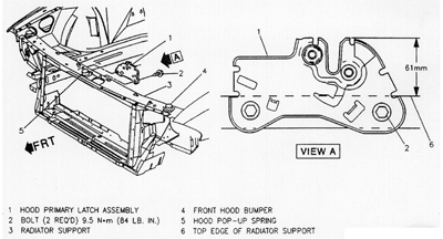

Hood Primary Latch
  1. Loosen the bolts and set the hood primary latch so that the top edge of the latch is 2.4 in. (61mm) from the top of the radiator support. This will be the starting point for up/down latch adjustment. The bolts should be snugged to hold the latch in position.
  2. Carefully lower the hood, but do not allow the striker to engage with the latch. Check the side-to-side adjustment of the latch to the striker. Raise the hood and tighten the primary latch bolts to 64 inch lbs. (8 Nm).

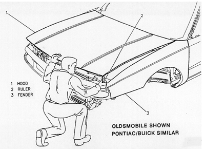

3. You must perform a drop test to determine if an up/down latch adjustment is necessary. The hood drop test will determine the amount of drop force required for the striker to fully engage with the latch.
  • Place a millimeter and inch ruler, between the hood and fender.
  • Raise the hood so the front upper edge is 31/6 in. (60mm) above the top surface of the fender. This part of the test will determine if the latch is set too high.
  • Drop the hood. The striker should not engage with the latch.
