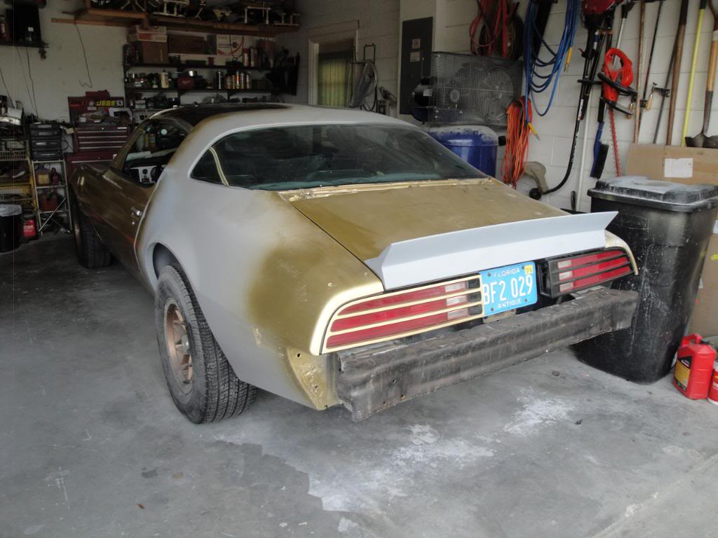

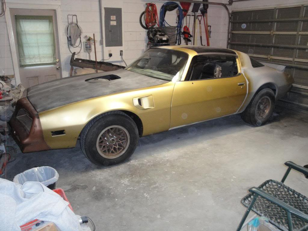

I own a gold 1978 Trans Am from CA. It has a black interior and the WS-6 option. I have removed the body side moldings and changed to the non-appearance weatherstrip on the windows. I also removed all of the original clear from the T-top end crome, polished it, and cleared it anew to remove the blue hue and cracks from the 1978 clear. I am in the process of learning how to paint using the car. Body work is not as easy as it looks, learning it takes lots of practice, and doing it well requires too much patience. Um gonna finish the jambs and take it to a professional.

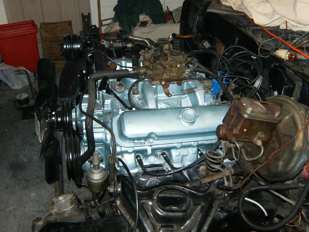

I replaced the factory engine and transmission wirh a SD455 and 200-4R (4-speed AOD) from a Grand National and added a set of Doug's headers. Still using the factory rear with 3:23 I think, I have yet to pace the car and the tranny is set up for a 3:90 gear. It seems no matter how slow I go um passing everybody. Imagine that from a Pontiac? I have replaced all steering and suspension components, body bushings, and converted to 1970 style 455 motor mounts.

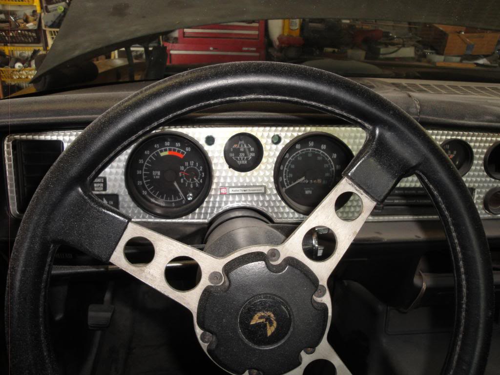

Grabbed them for you Bill:
