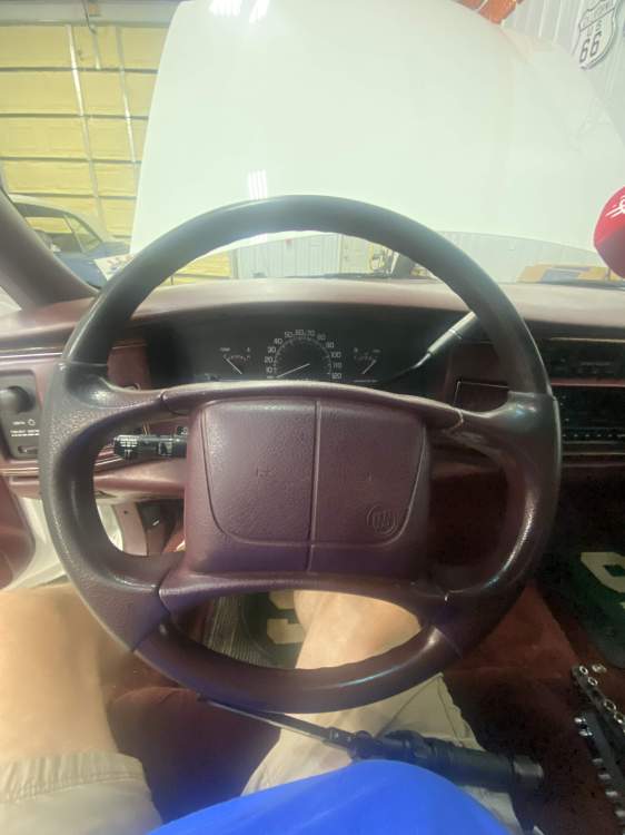

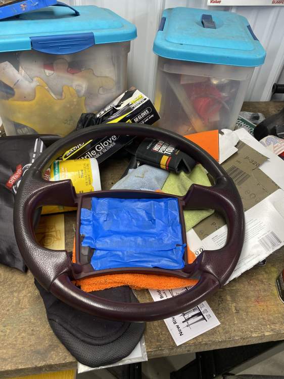

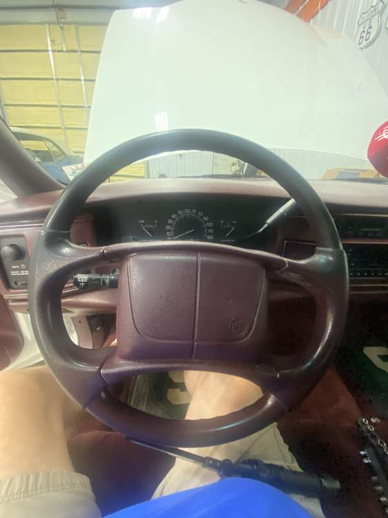

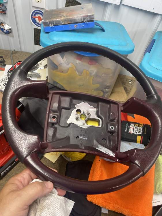

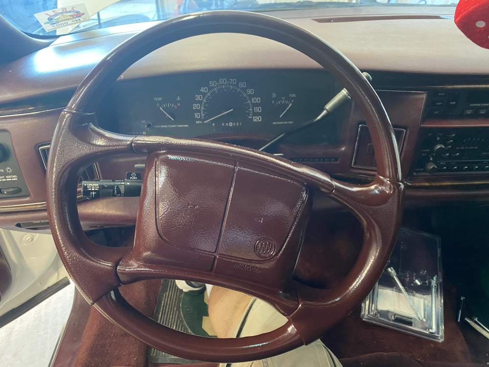

Now I am working on the steering wheel. After 32 years of my dad and I driving this land yacht, the vinyl steering wheel has gone black at the top from finger prints, dirt and oil.
This what I started with.
The black looks bad against the rest of the burgundy interior.

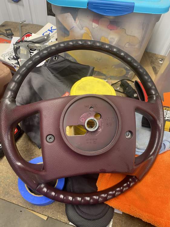

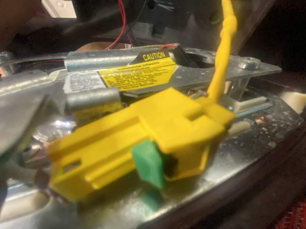

First thing I did was disconnect the battery and wait for about 20-30 minutes. This was to insure any residual capacitor charge had dissipated. Can’t have the airbag going off in my face!
First I removed the two T30 torx screws in the back, pried out of the airbag / horn assembly and disconnect it. The yellow wire fires the airbag. The green clip has to be removed before you can unplug the airbag connector.
Once the airbag is off, a regular steering wheel puller is used to remove the wheel.

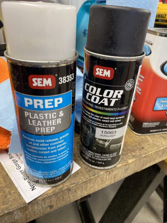

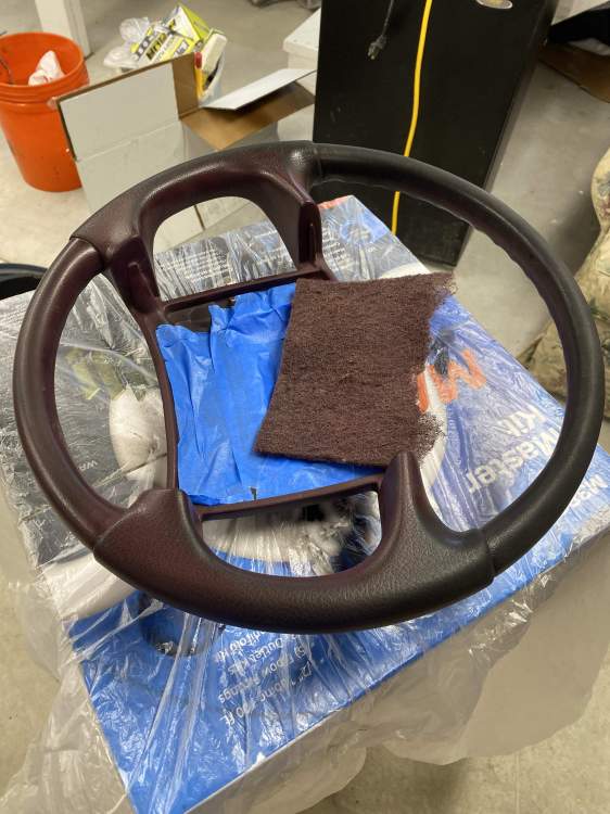

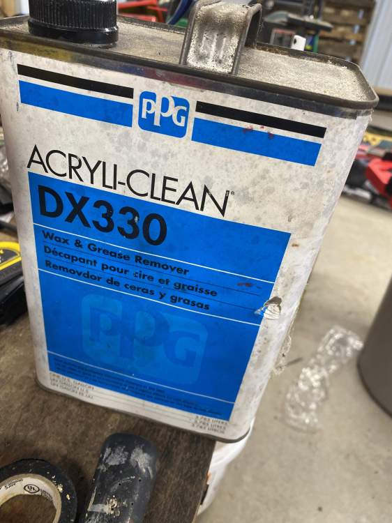

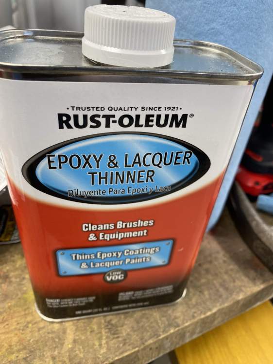

I was lucky in the sense that there is no physical damage to the wheel that needs to be repaired first, just discoloration. So I proceeded to clean the snot out of it. I used a dirt/grime/degreaser first. Next I hit it with a red Scotch Brite pad to dull up the finish and create some tooth for the paint. Next was the wax and grease remover, then lacquer thinner, followed by an adhesion promoter. I was also wearing gloves while doing all this cleaning.

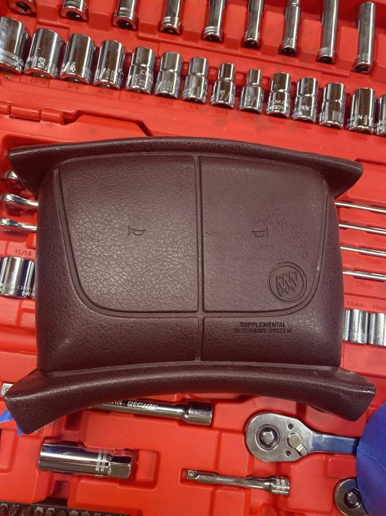

I did the same thing with the airbag but while cleaning with the lacquer thinner, I used a tooth brush to clean the Buick logo and the tight cracks of the airbag.

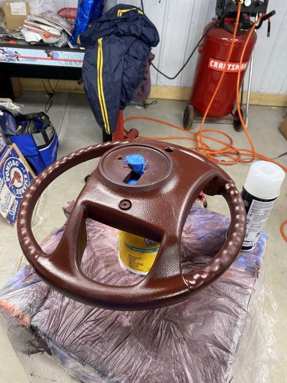

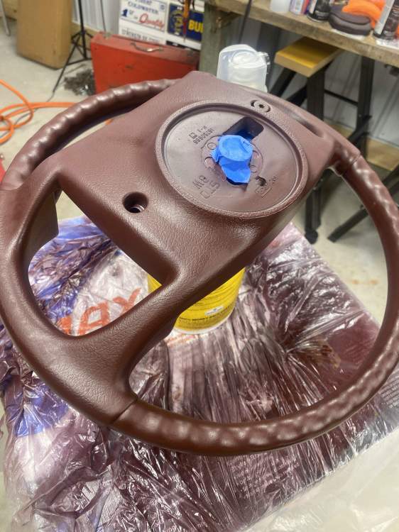

Now it’s time to apply the SEM burgundy Color Coat paint/dye. IMG_6708.jpegIMG_6703.jpeg
I am almost out of paint but I think I have adequately covered everything. The wheel was worse than the airbag, so it needed more coats to cover the black plus it is simply a larger piece to paint, on both sides. It needs both sides painted, the airbag has only one side that needs painting.
The paint is currently drying. The next step is to apply a low luster clear coat. A matte clear might be even better if I can find one. I don’t want or need a shiny wheel but I want to make sure it is protected for another 30 years.

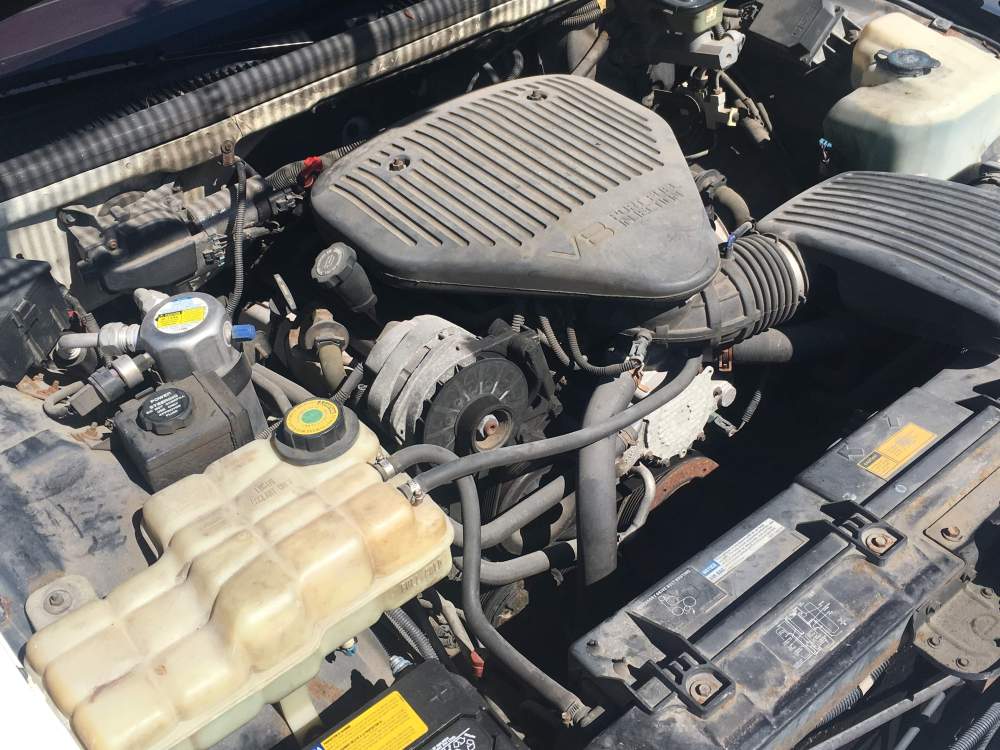

An LT-1 motor. I have always heard that the "OptiSpark" module behind the water pump was trouble due to water intrusion from pump leaks.

SEM Color Coat Burgundy. You can find it on Amazon, eBay, etc.
Rick
Thanks for the tip B52. I will keep it mind for the future. I do have a solid respirator.
I try not to cross paint manufacturers very often. One never knows if there is a chemical reaction between two different products that might destroy the paint job causing you to start over.
As for the Optic spark, yes it is hands down the Achilles Heel of the LT1. What is more mind boggling is replacing the electric water pump. It’s three hundred dollars and up for a new one!
New AC Delco and aftermarket OptiSpark distributors now have water drain holes in them to prevent water intrusion and killing the distributor. Fortunately for me, this car still has the original OptiSpark and water pump. Knock on wood.
People have come up with ways to run the LT1 with an LS coil pack and ECM or a traditional distributor, thus eliminating the OptiSpark. Is it worth it? I have no idea.

The Water pump on the LT1 engine is driven directly by the camshaft...It is not Electric...The hard part is actually finding the seal that is between the Camshaft drive and the water pump...99% of the time that is the point of failure and is very tedious and unforgiving to install correctly...The Lt1 is a very good reliable engine as I have zero issue wth the optispark on my Firebird...The LT engines were available in two different displacements with the 350 Aluminum headed version used in F-bodies and Corvettes...Iron head versions of the 350 LT1 were used in cop cars and the Impala SS Certain Oldsmobiles..Cadillacs and Buicks...Visually they look the same...so you have to check the VIN codes to 100% tell the difference between the two different Displacement engines...
The other Gen2 LT engine is a 265 CID iron head version that is used in some cop cars and most full sized Chevrolets...Oldsmobiles...Buicks and Cadillacs...They look exactly the same...The only way to tell the difference...is to Decode the VIN...As I'm unsure which code is which....
Roadkill’s “Bubblicous” - a pink donked 9C1 Caprice has the L99 4.3L V8 in it. Yes they look identical but LT1 vs L99 is the RPO designations.

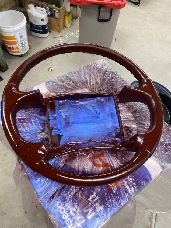

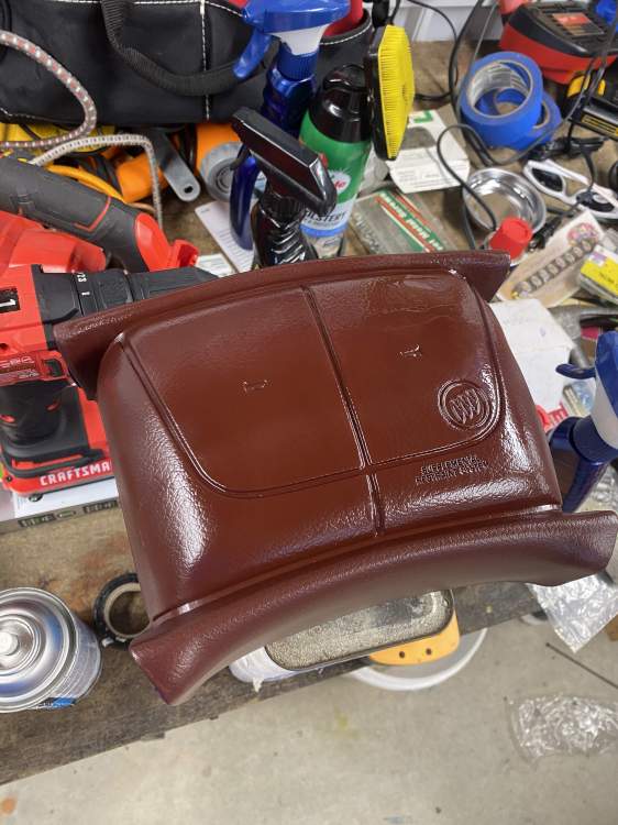

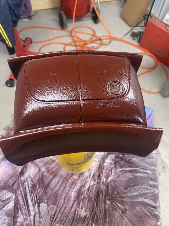

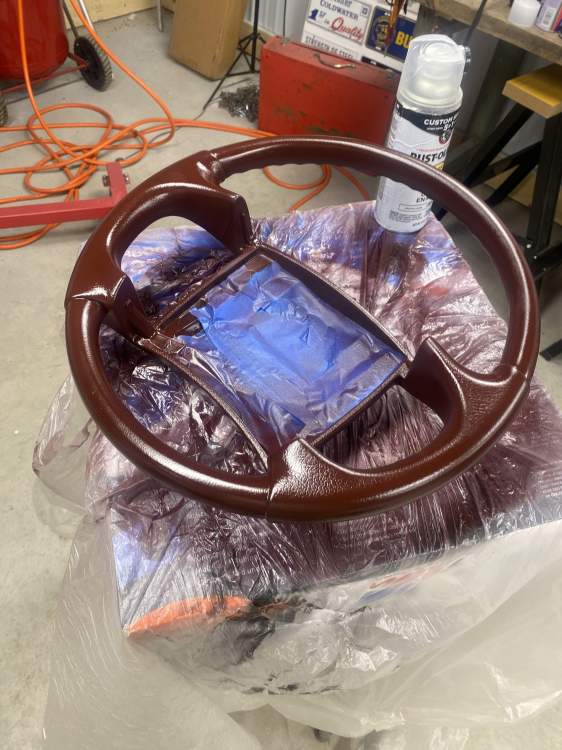

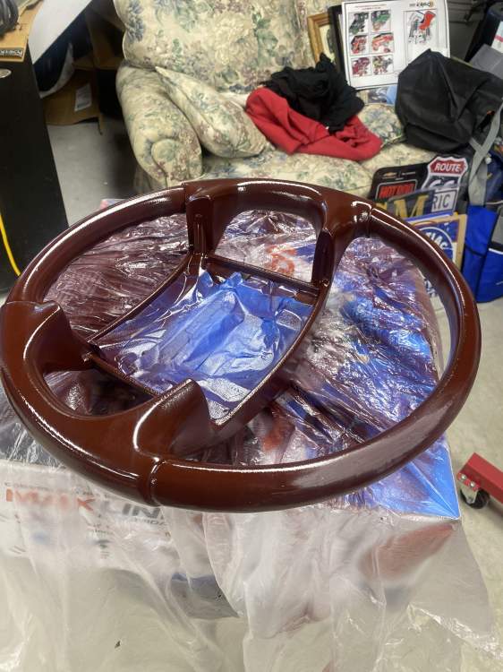

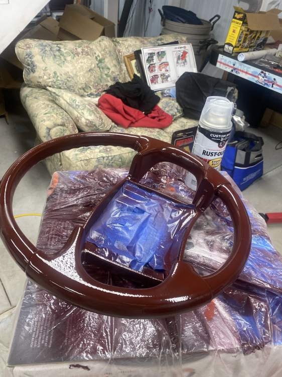

Wheel update!
Air bag with two coats of clear
Steering wheel- backside coated only with two coats
More coats coming this week
Airbag may only get one more coat. I am thinking five coats total for the wheel - both front and back.

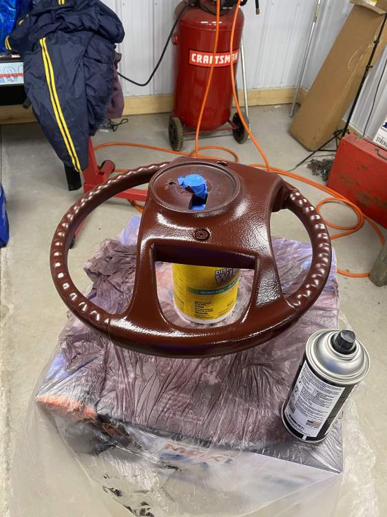

Well the low luster clear was a bit of a disaster. The steering wheel looked like burgundy flat primer, not a low gloss finish. So as much as I hate to mix and match different paints, I switched to the high gloss clear I used on both my Hurst pistol grip shifters handles.
This is definitely low luster but it’s too low!
Back to a high gloss clear,
I don't know why I think this, but my gut tells me that high gloss is a tougher, more durable surface.
Rick

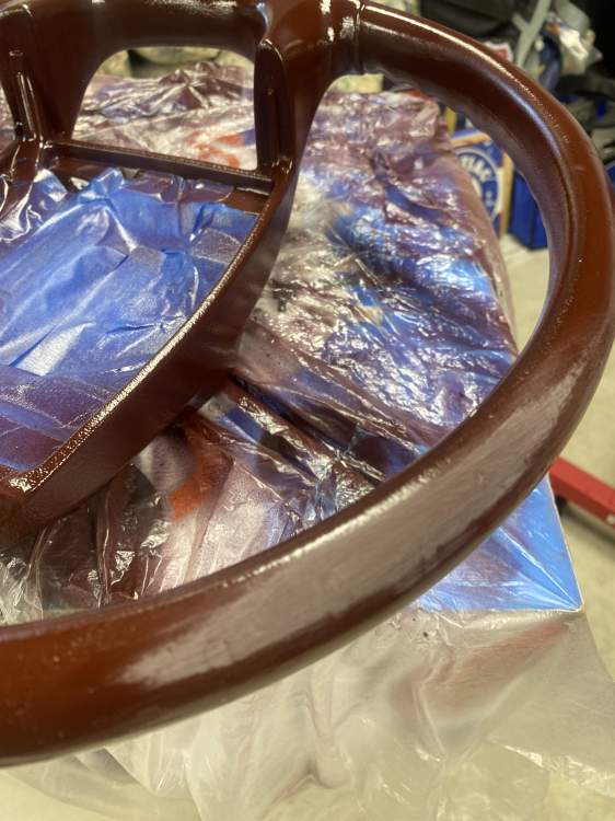

I found three drips in my clear coat. So I used 600 grit sandpaper to smooth it down and then re-sprayed the area.IMG_6838.jpegIMG_6837.jpeg
thats a finger bump frosty ! not a drip !
I stand corrected Kiwi! D

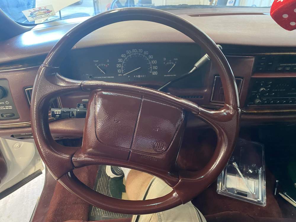

The freshly painted steering wheel is done and installed. I still need to reconnect the battery and test the horn.
Looks good!
Nice job! Now you have make everything else on the dash shiny.
Well done frosty , it looks great 👍
Horn works! I connected the battery and successfully honked the horn.
