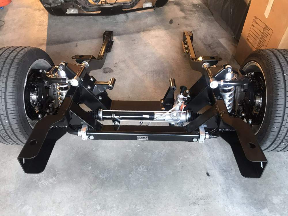

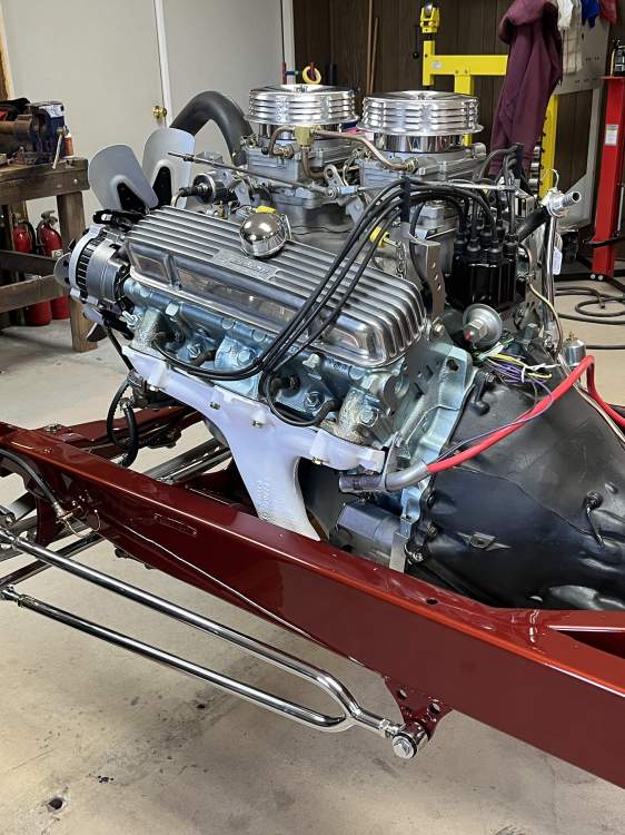

Hey ya'll!!! long time classic car buff, but new to the forum here. Hoping you could all help me out with an issue I've ran into with my 1967 Firebird build. I've installed a Heidts subframe, coil over suspension system with rack and pinion steering components. The original engine has exhaust manifolds so i had zero fitment issues with the new subframe/suspension upgrades, but now that i am ready to drop in my brand new custom built 428/467ci stroker motor, i found out the Dougs headers conflict with the new steering shaft location for the R&P set up. I am being told by Butler Performance that they don't know of any header that will work with my aftermarket steering setup. Its hard to believe that i would be the only guy who would upgrade to R&P steering and still want headers on the engine, so i was hoping some of you guys have dealt with this and have some suggestions.

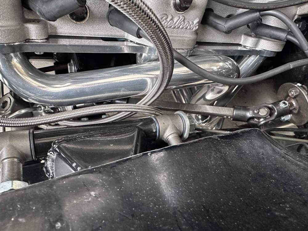

Can you show or explain in some detail, what, where & how much is the interference!

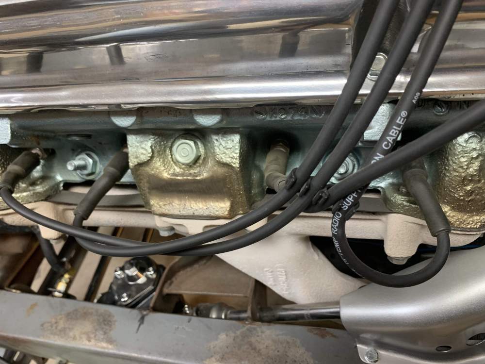

Thank you sir! See attached photos, i tried to get as many angles as i could. I am hoping the right set of shorty/block hugger headers might work.

Well! That’s a problem! First thing I’ll ask, is I presume there is no provision with that frame for a traditional reciprocal ball system?!

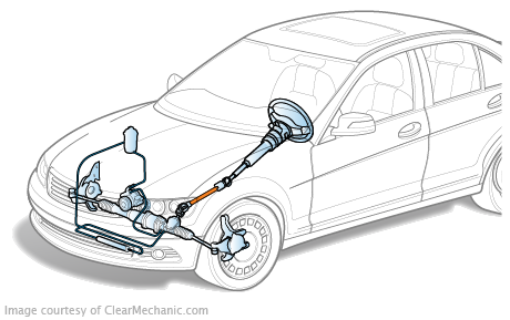

If that is the case, as it appears, my next thought is you need to layout a path with the header in place. This would entail at least one frame connection for an intermediary joint. In this design you will be running a per say straight line from the firewall to the frame connection. This needs to get you pass the point of header contact due to the current angle you have to take. Than an angled shaft & couplings that gets you to the gear box. This may result in to steep of an angle & if that becomes the case I have a remedy that may negate that issue as well, but if the first design works I would see no reason to complicate things. See attach schematic drawing.
I like tims way, simple easy, quiet, plenty of room and tidy cheers

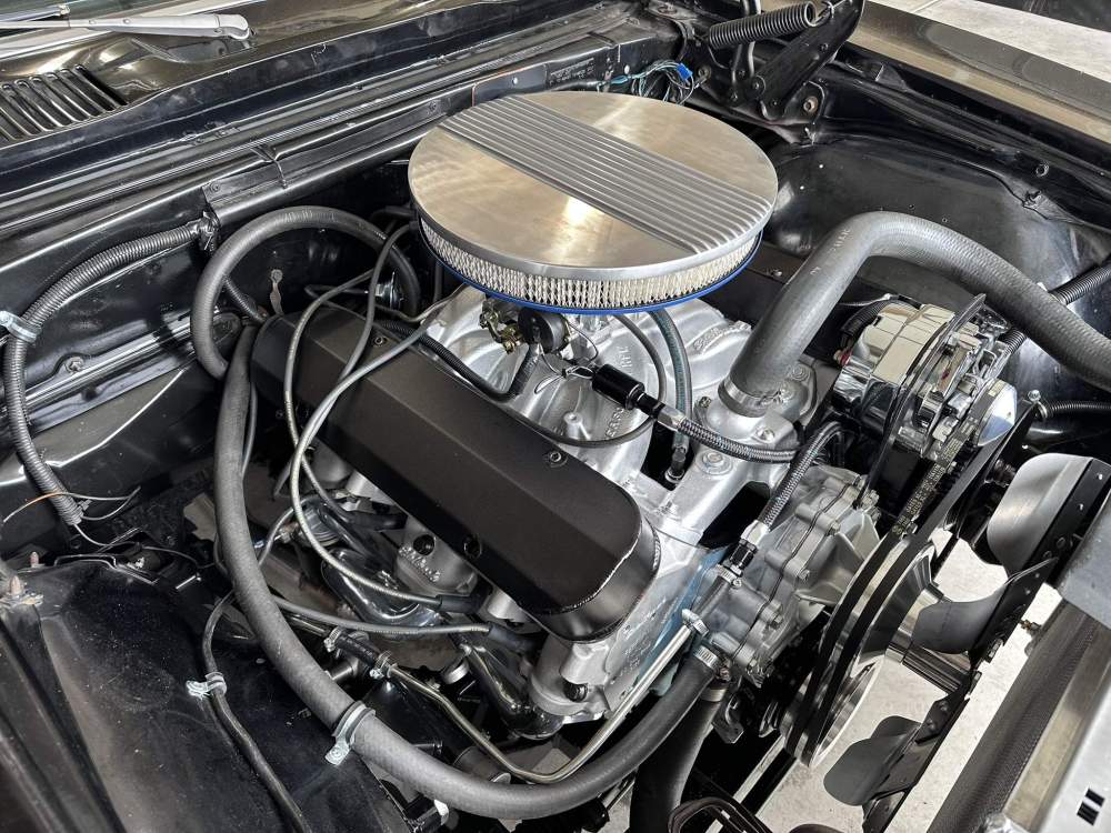

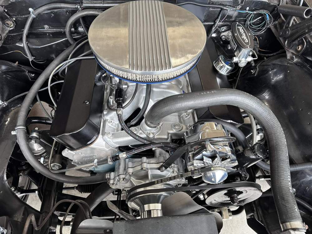

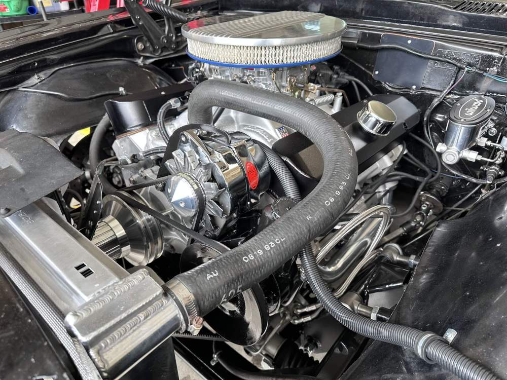

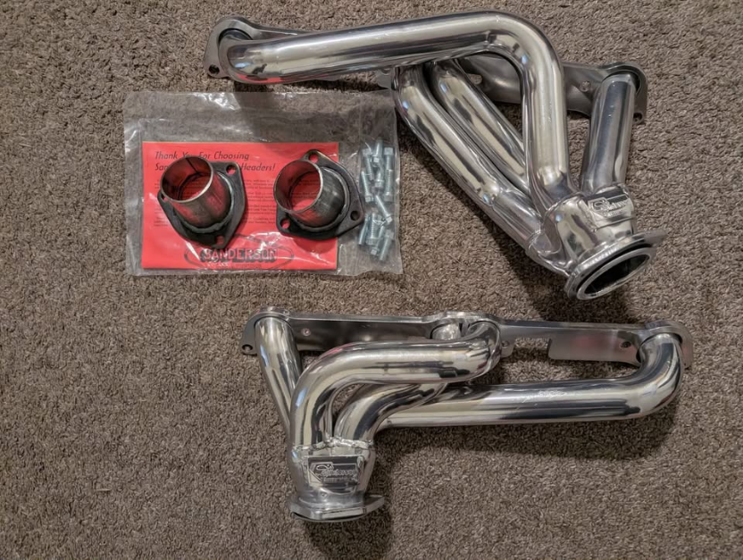

Well ya'll, case closed on the 428/header conflict issue. I tracked down some real nice ceramic coated shorty headers from Sanderson, the PF1 series. Clears my R&P steering shaft even better than the old stock exhaust manifold. AND!!!!! Yesterday was the official grand awakening of the 428/467ci Poncho beast!!!! Just in time for summer time car shows!
Thank you to everyone who was helping with their ideas and suggestions! I really appreciate it!
Congrat's on the 1st fire. 1st ride go with that? Beautiful job.
No 1st ride yet, waiting for it to stop raining D
