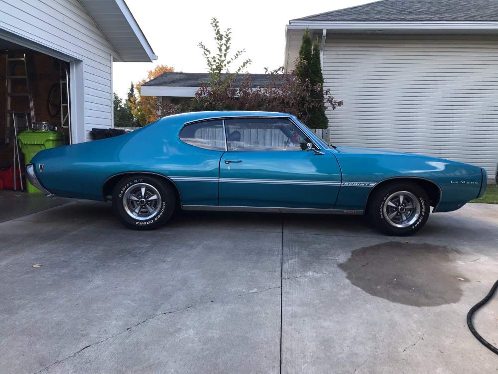

So as it stands now, the car is (at least exterior-wise) almost complete. Friend of ours who helped us put the bumper on is going to a swap meet down in Michigan in a few weeks; might pick up a set of tailight bezels for our car if he sees them, as well as a set of those little chrome splash guards, at least for behind the front tires. I was hoping to block stone chips from hitting the rocker trim and 350 emblems, so I wasn't planning on putting those on until I get a set of splash guards. Also the side stripe; it was determined that the only change to happen is that we're going to change the "Sprint" to just "Pontiac". There's always so much confusion at car shows because of the "Sprint" in that stripe. And then finally the grille is going to be further chromed up, via laser cutting chrome vinyl to go on the outlined moulding around the headlights, which will complete the grille appearence.

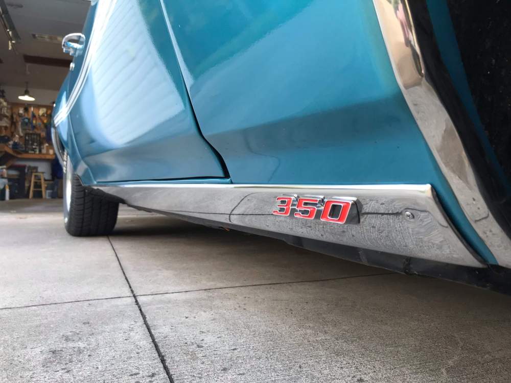

    Got the rocker trim on a few weeks ago. Took it to a friend's place, as he has a lift. Big ordeal that was. Had to take the front wheels off in order to slide the trim piece on the clips. It was tideo

That stripe was put on by the previous owner to break up the "too blue" theme since both bumpers were body colour and there was nothing breaking that up. The car never came with that stripe, as it would had to have been an actual "Sprint" which had the OHC 6 option. I'm pretty sure you could only get that stripe if you had the OHC 6 underhood. That sprint option was available on Tempest and LeMans from '66-'69.

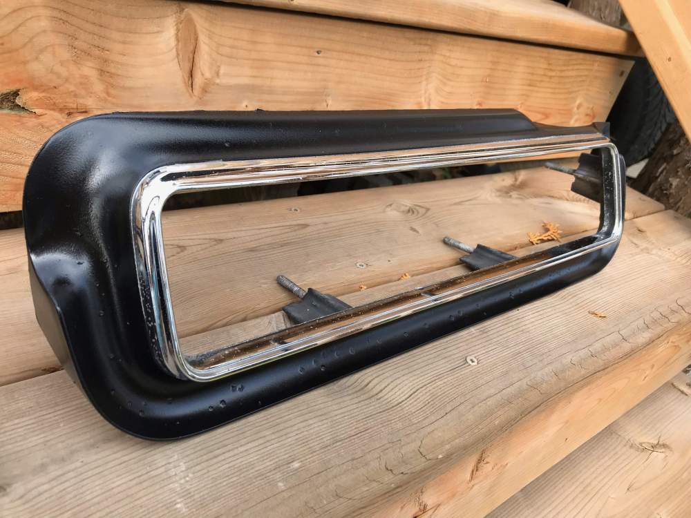

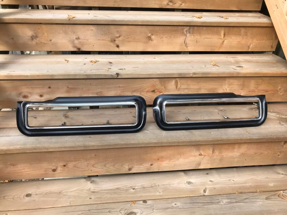

Got the rocker trim on a few weeks ago. Took it to a friend's place, as he has a lift. Big ordeal that was. Had to take the front wheels off in order to slide the trim piece on the clips. It was tideous but it worked. And I managed to score a pair of proper tailight bezels off of eBay, and got them today. Wasted no time cleaning them, polishing the chrome, and then sanding, priming, and repainting the black areas. They look absolutely stunning now, but it turns out it might be a while before we can get them on the car, because we have to take the rear bumper off (again!) in order to do so. But I am very pleased to have the bezels now; they just look so good. Might go out to the garage and gawk at them for a while after I'm done here

Finally got those tailight bezels on yesterday morning. Took it to our friend's place again, and had the car up on the lift to remove the bolts from the bumper brackets so it would slide forward enough that we could just slide the old bezels out and put the new ones on without having to take the bumper off entirely, which was a good thing. Then we ran into a ground issue with the tailights after we put them back in, where the rear side markers and the lisence plate light were flashing with the left turn signal, and the left back up light and the rear side markers were flashing with the right turn signal, so we must of did something wrong when we put the lights back in, but our friend was able to check where a ground needed to be on each side and he fixed it. It was just weird how that happened.
I am happy with those bezels though, they complete the stock rear end look of the car.
She looks great. Nice job.
Ground is always an issue on these cars. Especially with the light sockets that get corroded. I have actually soldered a ground wire to the sockets to make sure the lights get grounded 100%
