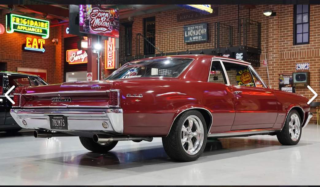

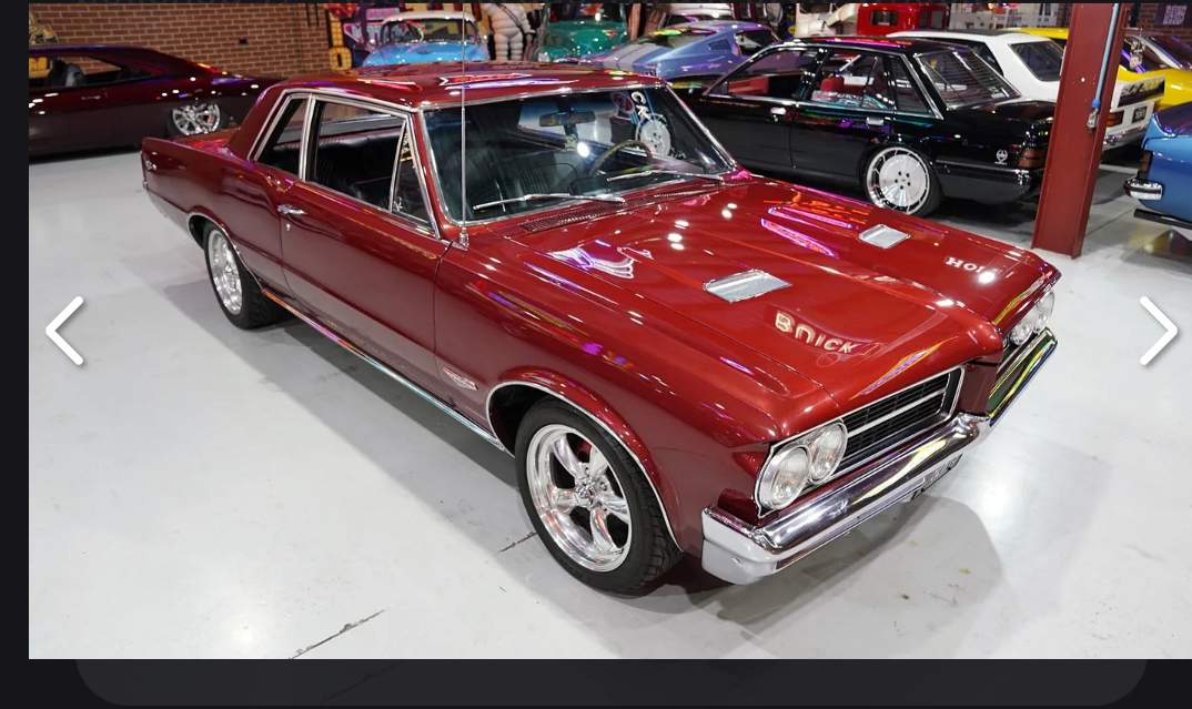

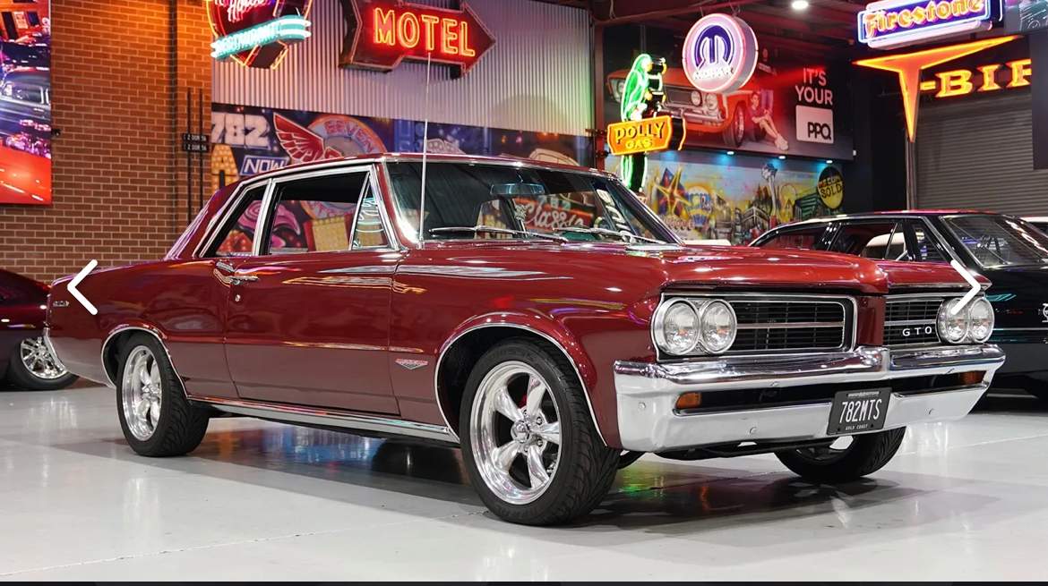

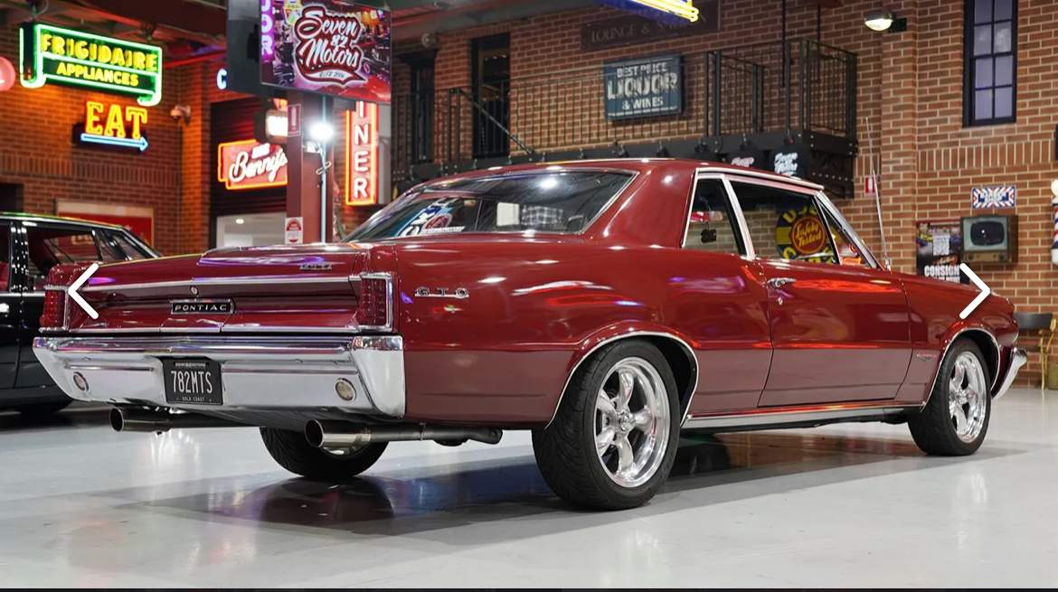

By the way, welcome to the forum. You have a beautiful ride!

Welcome to the site, thankz for the pic's. Amazing Pontiac.
