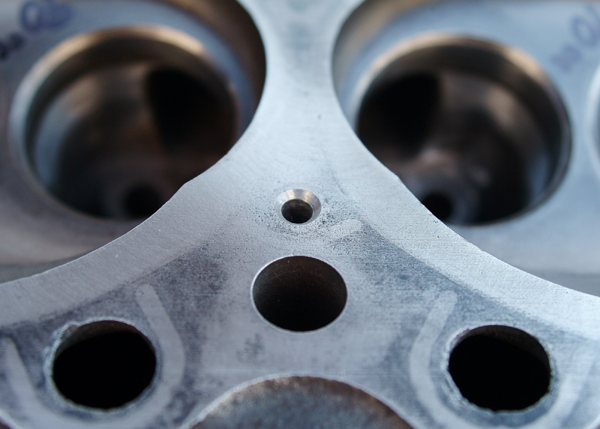

I found a little info on this mod
That's part of it yes, use gasket to locate holes. need a corresponding hole in block too. then use 1/4 plugs in the 3 front water outlets on block at deck. these should be recessed about 5 thousandth .  back when Pontiac v8 was developed, they had water pipes from the pump go right into the heads, with bigger holes at rear to keep the block temp more even. I have a 400 with plugs in place and middle hole at exhaust area, I'll get pics up soon. this is almost mandatory  for any CR over 9 or Iron headed high CR engine. Pontiac did this engineering ,  due to CR drop offs in the 70's the cooling wasn't as much as concern...
