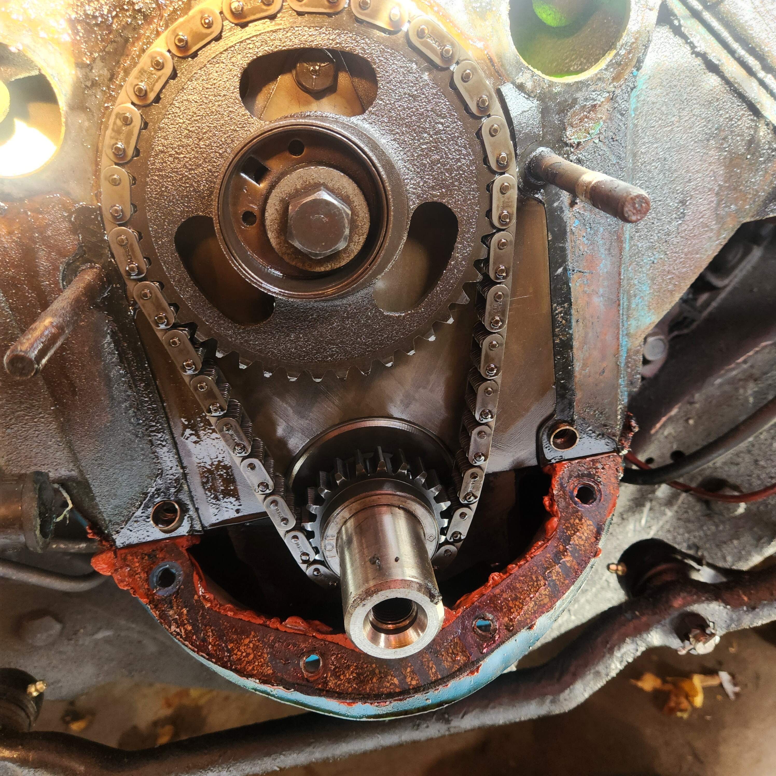

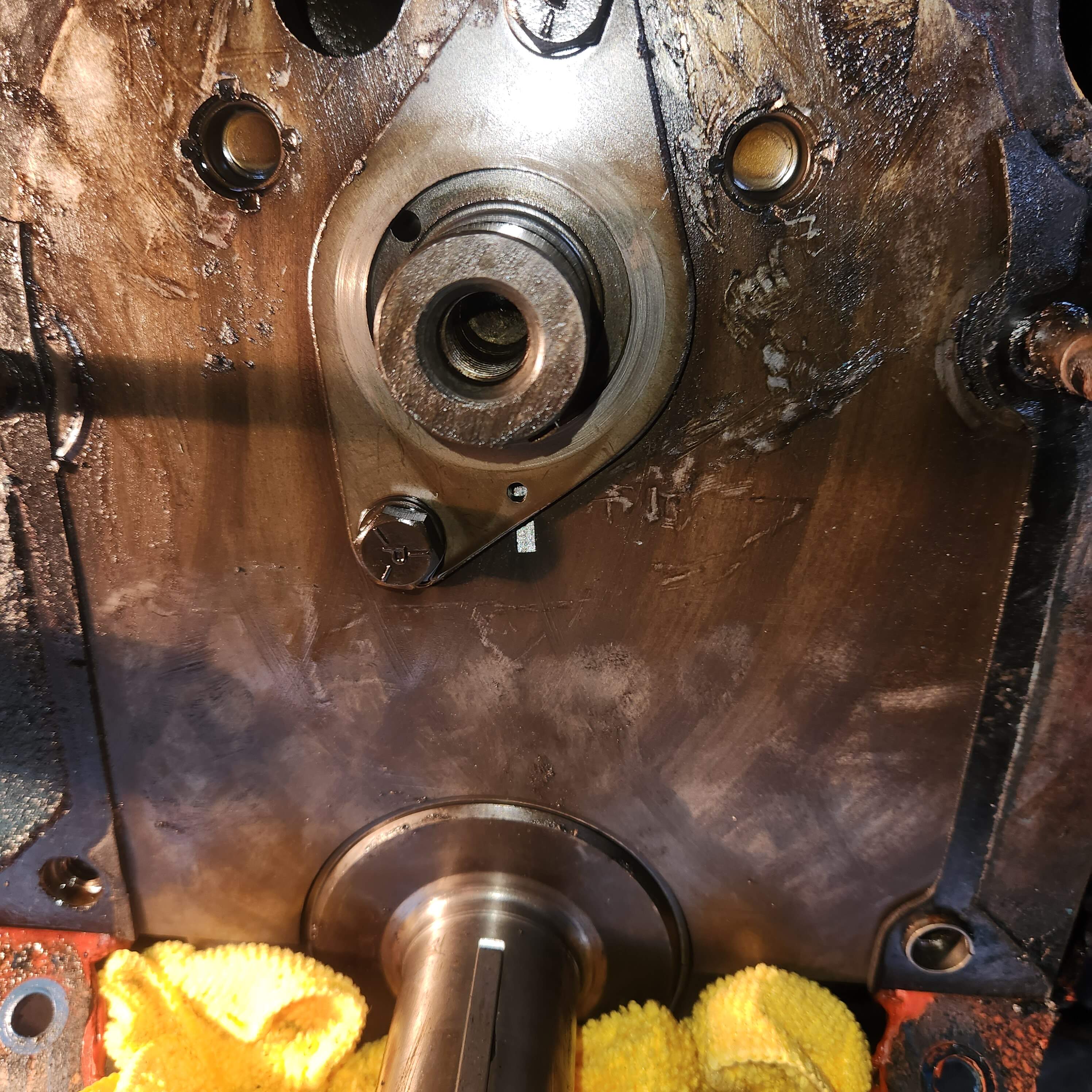

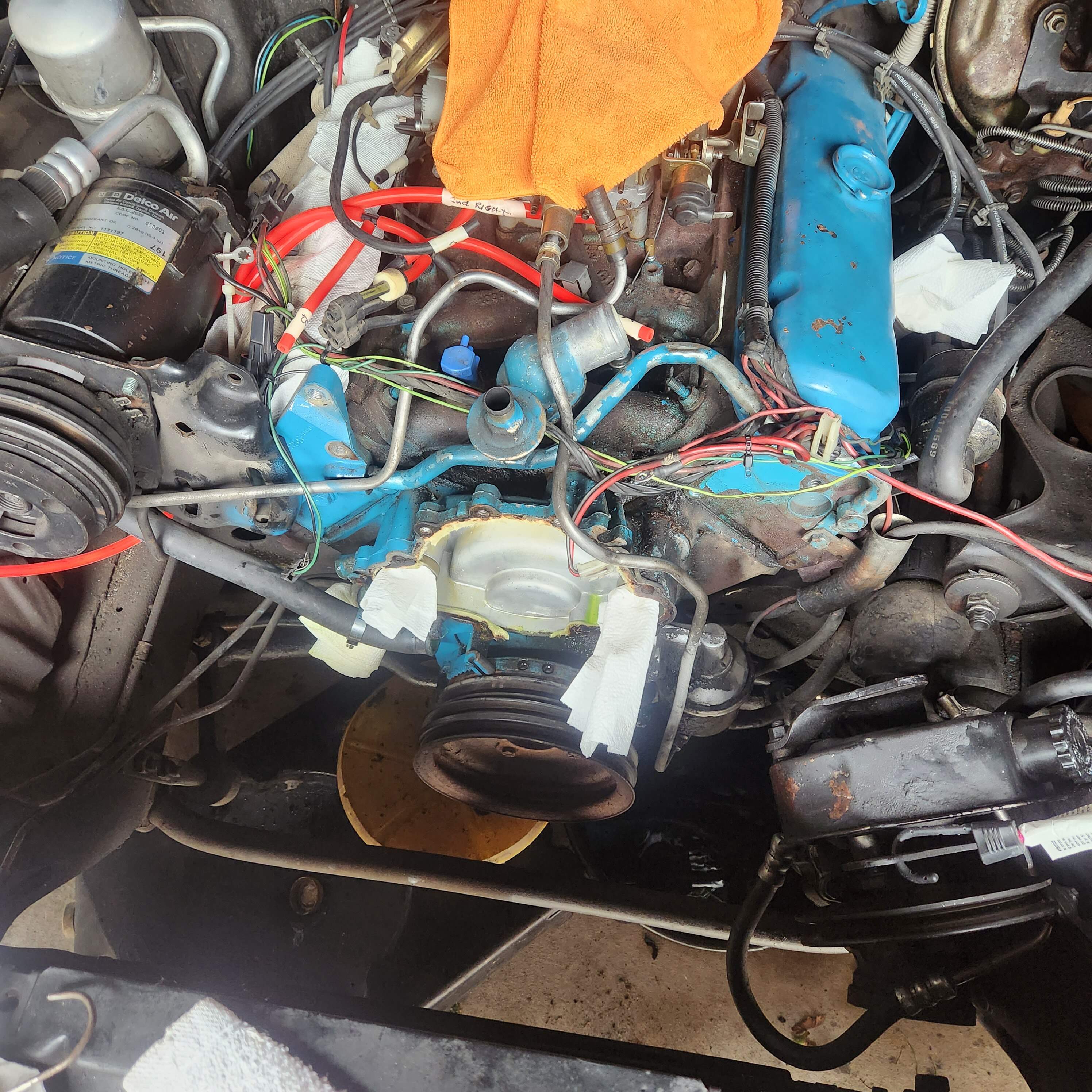

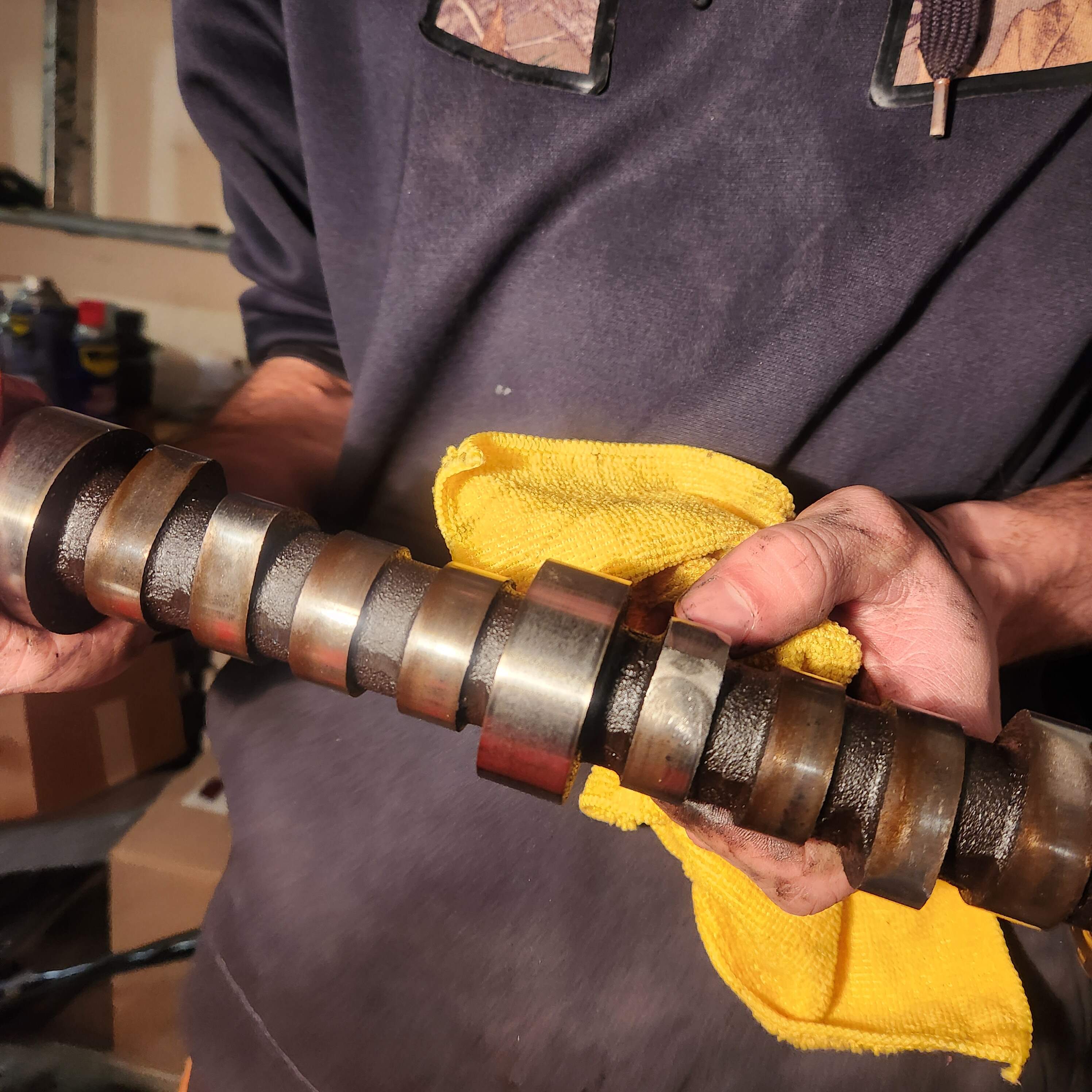

here is my story on my 1980 Firebird TA that I have had since new. Everything is original except the water pump. I drove it on weekends and nights for the first 11 years. then after putting a car seat in the back, I cried and stored the car in a garage. I would start it up once in a while and drive it around the block. then about 2 years ago, I pulled it out and got the front end, exhaust done, carb rebuilt, new belt, hoses, new gas tank, etc.
I then had an issue with the car overheating and bogging down. found out that it was the ICM in the distributor and removed the new Chinese after market part with a new GM type. this seemed to work. Then I was going to drive it up to a transmission shop to get it overhauled. as I drove it out of the garage and up the Highway I heard the lifters tapping. so after the transmission got overhauled I stored the car in the fall and slowly started to remove the engine to get to the cam and lifters. My son installed the cam and lifters yesterday and now I will slowly try and put the rest of the engine back in its place. Wish me luck as I have never taken an car engine apart or visa versa.
I have put some pictures up so you can see the progress.
