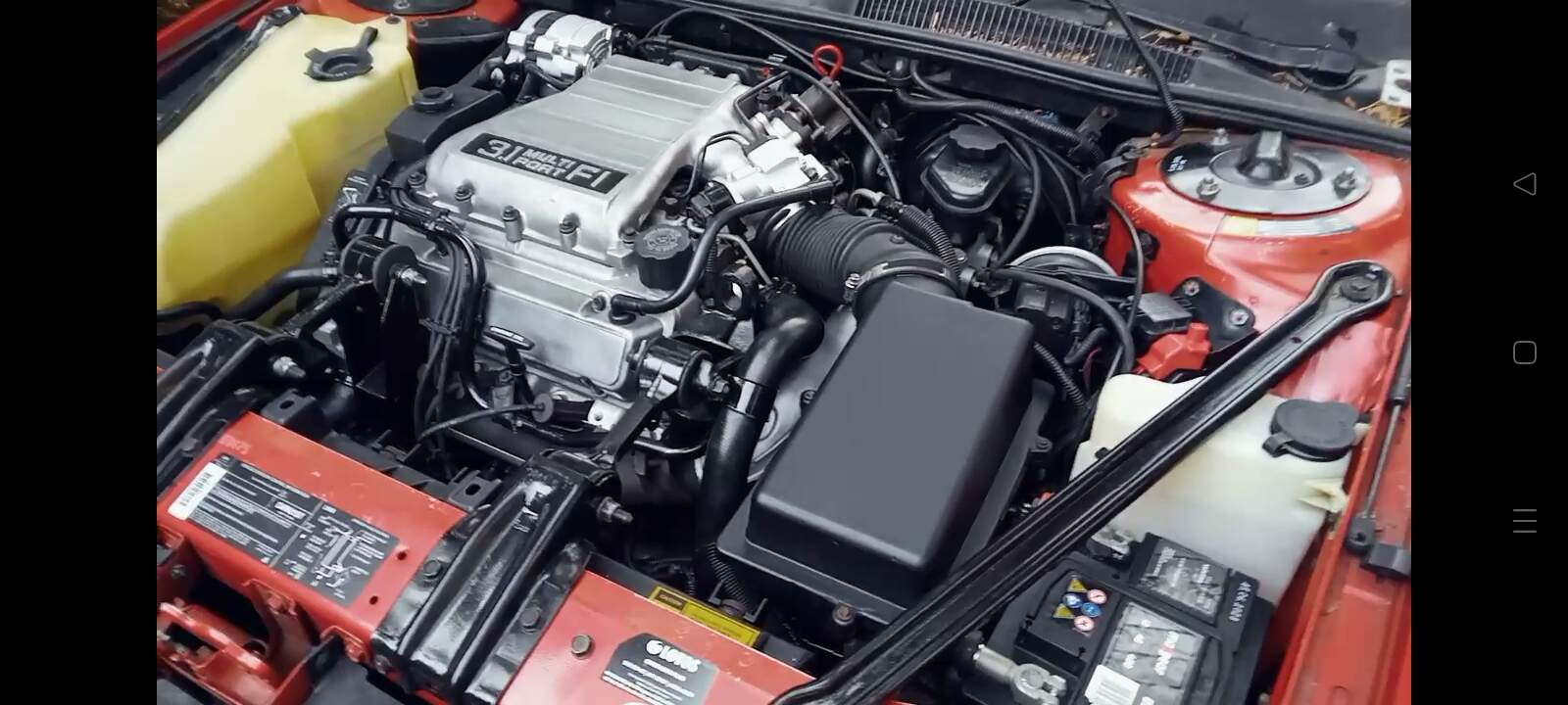

Of course, I'm sorry I didn't add photos. I'm really only interested in the original air filter housing, even just the upper part that is in the photos. The general view shows the casing in the engine compartment, which is only put on for the photo because it is cracked and broken. It looks good but it doesn't work.
Okay - two things come to mind.
1. Is it possible to simply repair your existing air cleaner assembly? I can't see what is damaged in the pictures you shared with us.
2. We have to expand our search of used parts. The W-body 1991 Grand Prix shared it's engine and engine bay with it's sister cars, the Buick Regal, Chevrolet Lumina, and Oldsmobile Cutlass Supreme. So we should be looking for air cleaner assemblies from those cars as well. So looking for 90-96 air cleaner assemblies for a 3.1 engine from one of these other cars should be identical to the one in your Grand Prix.
I know that the photos don't show these damages, but believe me, they are there. The housing has broken fasteners, they were only glued to take a photo. The upper part is also broken and glued. The damage occurred when the alternative fuel, LPG, detonated. In Poland, it was quite popular to convert a car to run on a different fuel, such as LPG. It was also popular in Western Europe, e.g. Italy, the Netherlands etc. Sometimes, due to ignition errors, the gas and air mixture in the intake manifold detonated. The effect of such detonation is the destruction of the filter housing. It looks undamaged but is cracked in many places. I removed the LPG gas supply system a long time ago and now the vehicle runs only on gasoline. The filter housing is made of a material that cannot be glued with any glue, even specialized ones. That's why I need a second one that would be intact. I only need the upper part, because the lower part is undamaged. I know that this housing is also found in other vehicles and that's what I was looking for. Unfortunately, without any positive result :(( This part is probably unattainable for me

Adam I do understand your problem, so obviously the real fix is a replacement. That said I do believe you can repair your current top, at least for the time being, if you can get the right materials.
You need .020 - .025 thick aluminum. This material is very workable, I.E. easy to shear & easy to form. Than you need a good quality construction adhesive. The type they use to glue woods together, like wood subfloors to floor joists. You will need to form the aluminum to contour to the shape of the inside of the lip of the box & extend the aluminum up the inside of the box a couple inches. Run the aluminum the entire side of the box & on each side where there is a broken ear.
Take a 120 grit sandpaper or something close to that & rough up the inside of the plastic box where the aluminum will attach. After you rough it up take some lacquer thinner & wipe down what you have sanded. Now you will need some thin pieces of wood or something like that so you can cut pieces to go on the inside & outside of the box to sandwich the aluminum using C clamps to clamp the entire aluminum piece in place. Spread the construction glue on to the plastic box where the aluminum plate will go. Put the aluminum piece in lay the wood over the aluminum, put the wood pieces on the outside & clamp. Leave it clamped over night.
