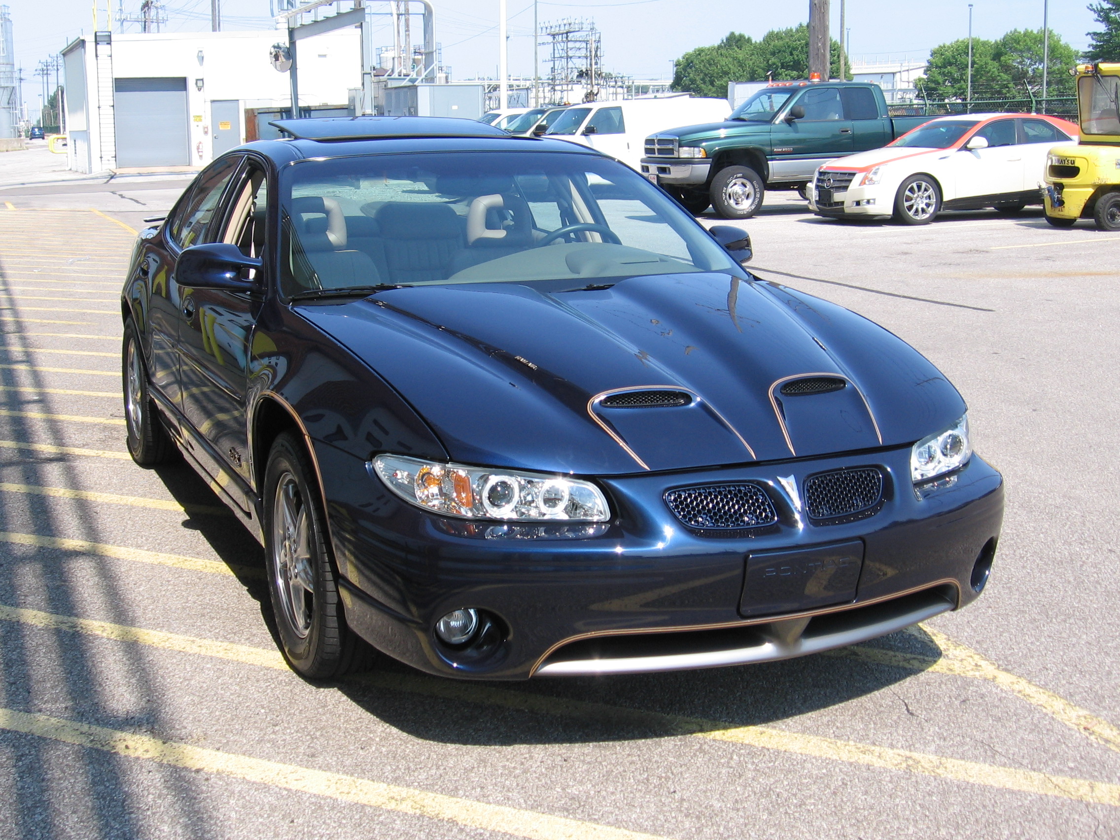

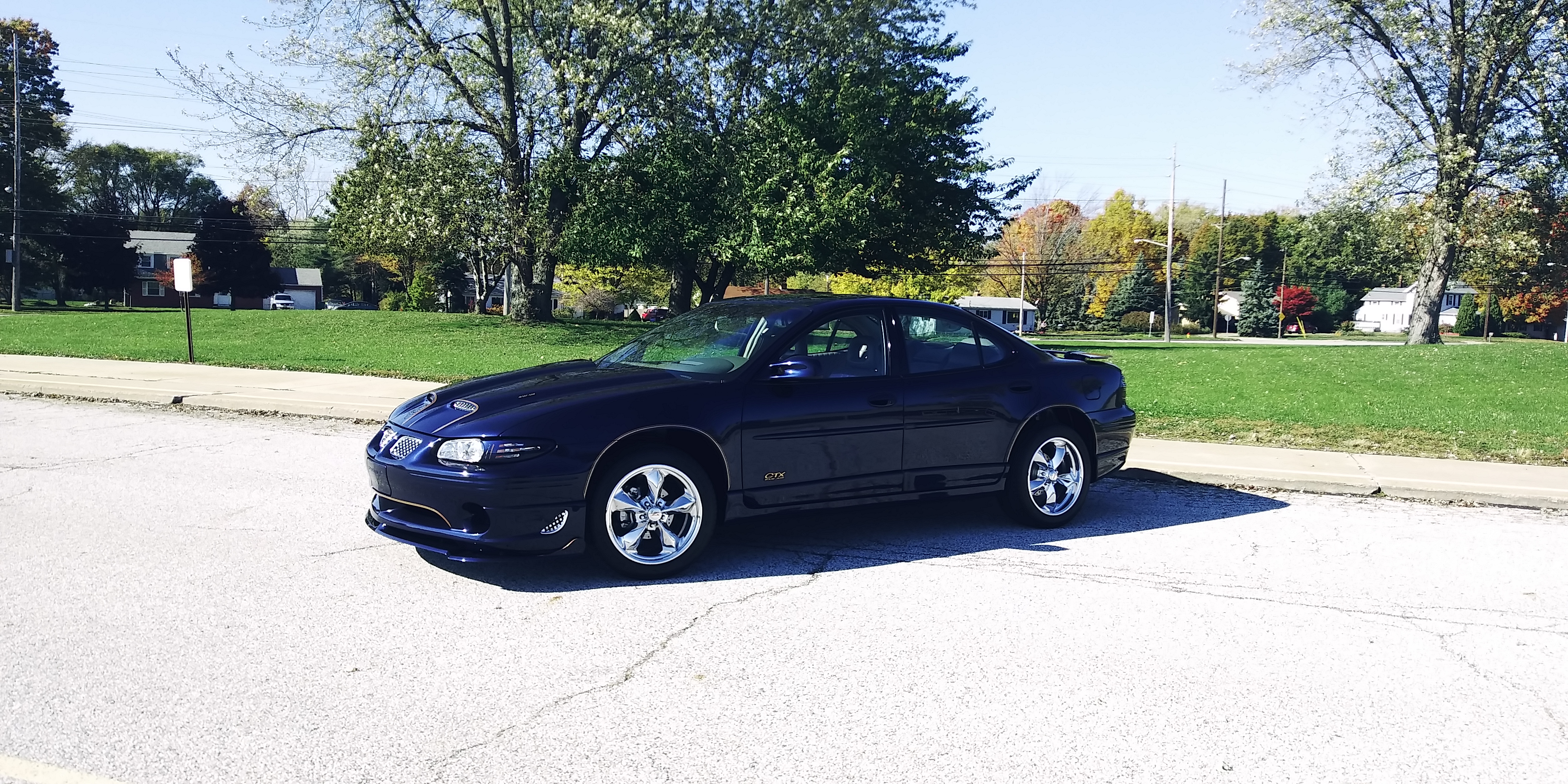

An example of my statement is this, my factory rims were P225 16” x 6 with a 43 offset! I had custom rims built. 18” x 8 with a 10 offset for the rears & 23 offset for the fronts. The tires for all 4 rims are P245 45 18”. Yet the over all diameter of the rim & tire combo is exactly the same outside diameter as the 16x6 with P225 tires. All I did was fill as much of the wasted space between the outside fender lip & the inside suspension/inner fender as I could with out making contact with any thing!
these are the original rims/tires
these are the new
