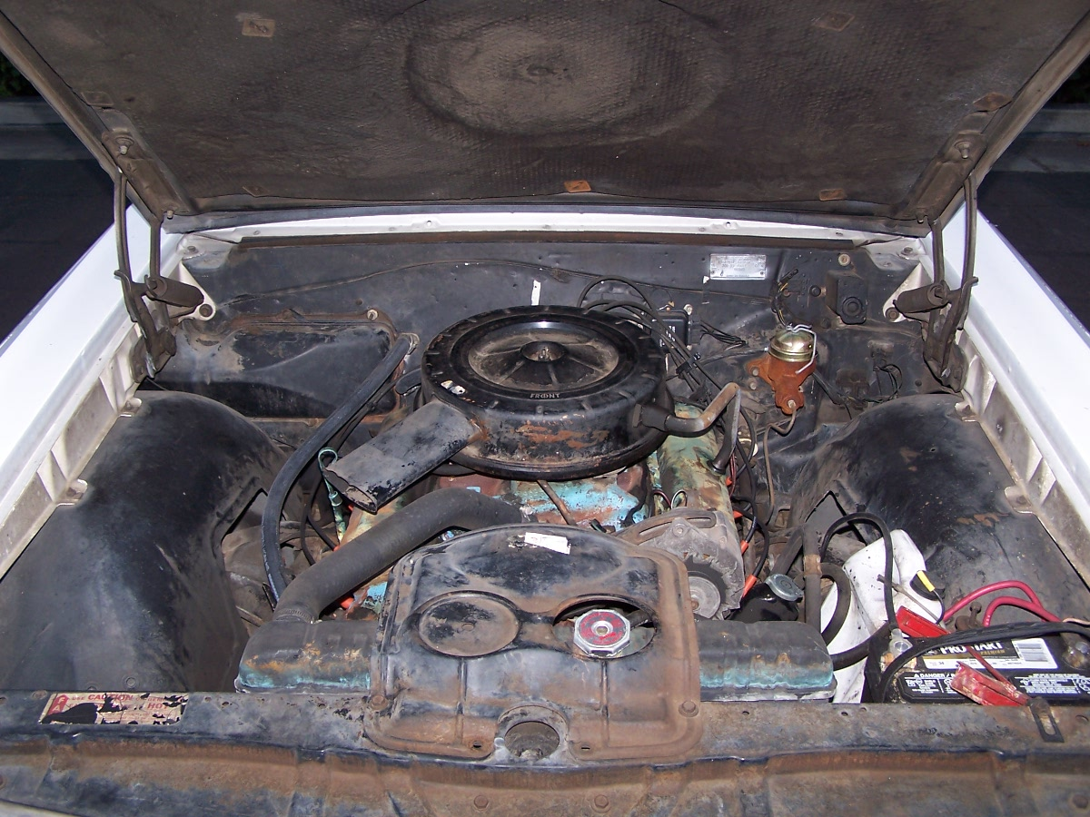

I am just finishing up putting the Vintage Air on My 65 GTO.  Put aluminum Pulleys and Cleaning up the engine bay.  Was noticing that My Radiator Inlet and Outlet are both on the right side of the Radiator, Being that it is not a cross flow but flows bottom to top, Am I going to have heating problems,  What keeps the water from just going in the bottom and backout the top without going through the rest of the radiator. It gets hot in Vedas so I really don't want heating problems. Any Information would be appreciated,  Thank You

The Radiator was In the car when I bought it,  It looks like the stock Radiator It is a three row.  I have seen other cars in pictures and seen adds for radiators for this car with the inlet and outlet on the right side.  but don't understand how it would cool very well unless there is a baffle or something to direct the flow to the left side of the radiator,  thought maybe there might be someone out there that knew a lot about radiators that could answer My question.  (KIWI Vegas Is hanging in there Still opening new casinos and other venues Like the Raiders Arena, It is tough especially when You have a stupid and spineless Governor.  But We still have a lot of tourists coming in)

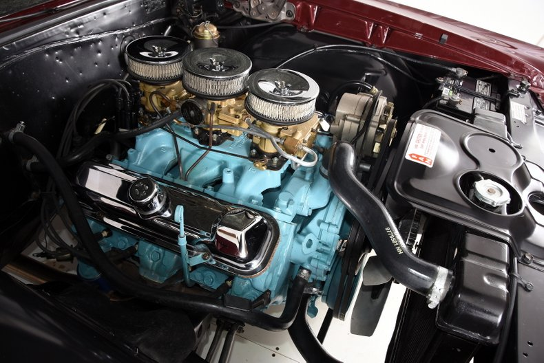

I did a little visual research. The radiator is correct for the 65 GTO. You can see from the photo that that the upper hose from the thermostat runs to the right side of the radiator, as doesh the lower hose. In later years, the thermostat housing was changed and the upper radiator hose was moved to the left side. This photo is from the '65 GTO in the Volo Auto Museum.
Here is a single carb set-up as well, albeit a little worse for wear.
Thank Frosty, that is what mine likes like(without the tri power).  I am going to putt it back the way it was and see how it holds up to the heat.  Thank everyone
Your radiator and cooling system appears to be correct....Hope this helps....
