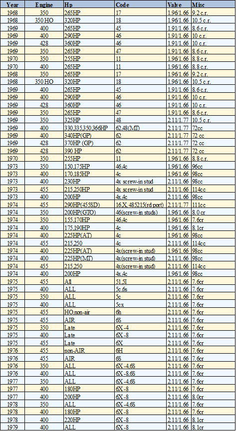

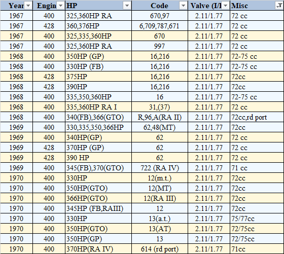

Andy - if you are looking for something in the 72-75cc range, here are a list of Pontiac heads to look for. The nice thing is the 400 and 428 heads will bolt to 350 engine with no problem. Further more, all of these heads have the desirable 2.11" intake and 1.77" exhaust valves. The Ram Air II, III, and IV heads are most like to the most expensive heads on the market, so unless I am trying to build a numbers matching engine, I would look for something else. The codes refer to casting numbers on the heads. MT stands for manual transmission and AT for automatic.
Based on the data below #16, 62, and 13 would be my first choices. However, if you find something else - clearly look at them.

Thank you Frosty, Wow that was a lot of good information,What is the difference between A/T and M/T heads? chamber size? and can you tell on the head?
You are listing a few 1967 heads was that a split year for open/ closed chambers? What is thoughts on open vs closed chambers?

As for non-2.11 heads, I would suggest the following:
That said, I would first look to find a set of 5C or 6X/6H heads, particular the 6X heads that were plentiful in the late 70s. You see 6X heads all the time at swap meets and online. If you can find a set of #18 (350 HO) heads, grab them. Again, heads from any 455 should be somewhat plentiful, but they may not be as cheap as other heads, as you have already discovered.
