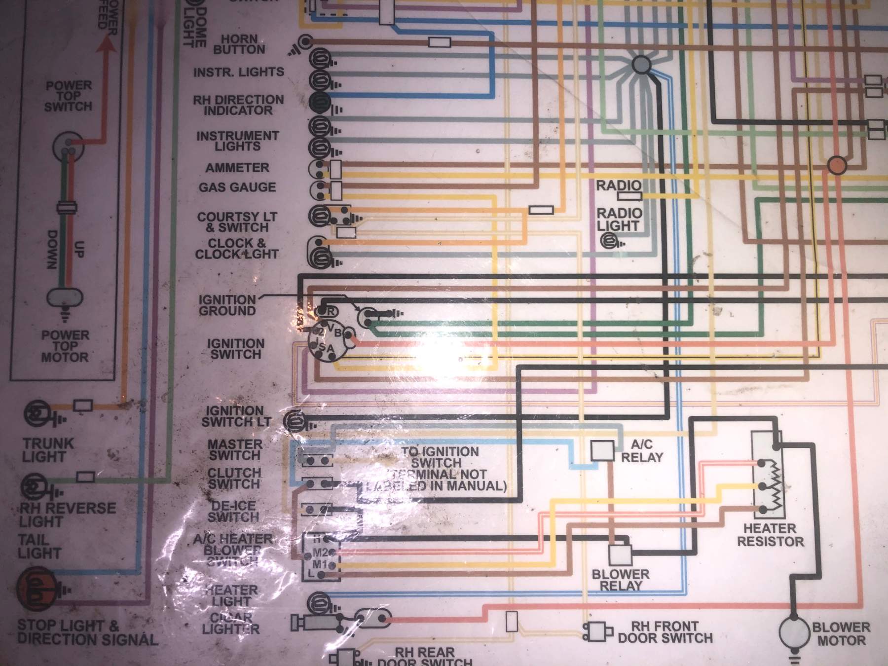

Jim, I can tell you that I rewired everything in my 63' Grand Prix by myself a few month's ago bud. I used a Painless wiring harness part# 10102. It really wasn't as hard as everybody made it out to be. But I have wired a couple of old Fords in the past. The only wires that have not been replaced in my car are the Turn/Parking lights in the grill. About 18' of wiring on each. That's because the screws holding the lenses on are rusted and I don't want to strip out the heads. They will be replaced when I can figure out how to remove them. The biggest issue is the ignition switch. There's conversation on this forum about it. IF your 63' has the original Pontiac ignition switch then it will be a 9pin. Nobody that I've spoke to has been able to figure out the proper way to wire it. But there are a number of after market switches and Painless even offers one. American auto wire also offers a kit. I've heard good things about them but never personally used them. If you decide to rewire it yourself, I have a factory wiring schematic that is in color. It was a huge help when I did mine. Be happy to shoot you pics if you decide to tackle it bud.

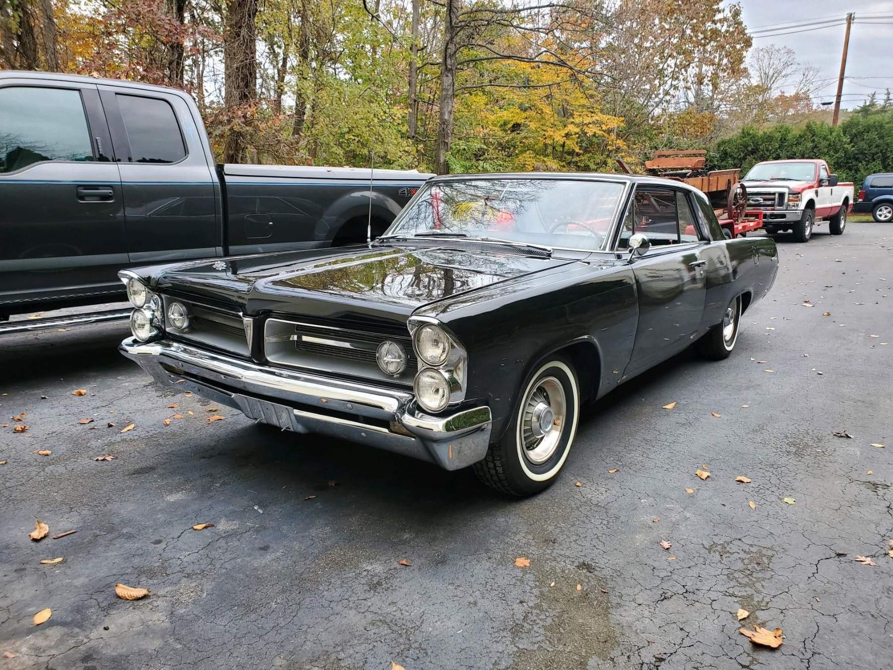

Yeah from the pics you sent she's beautiful bro. I have thought about the 2x4s for a while. Still thinking about it lol. Maybe next year after mines been on the road a bit and I get the bugs worked out. If you need anything just ask bud, everybody here is willing to help and the amount of knowledge these guys have is just unreal! Be safe

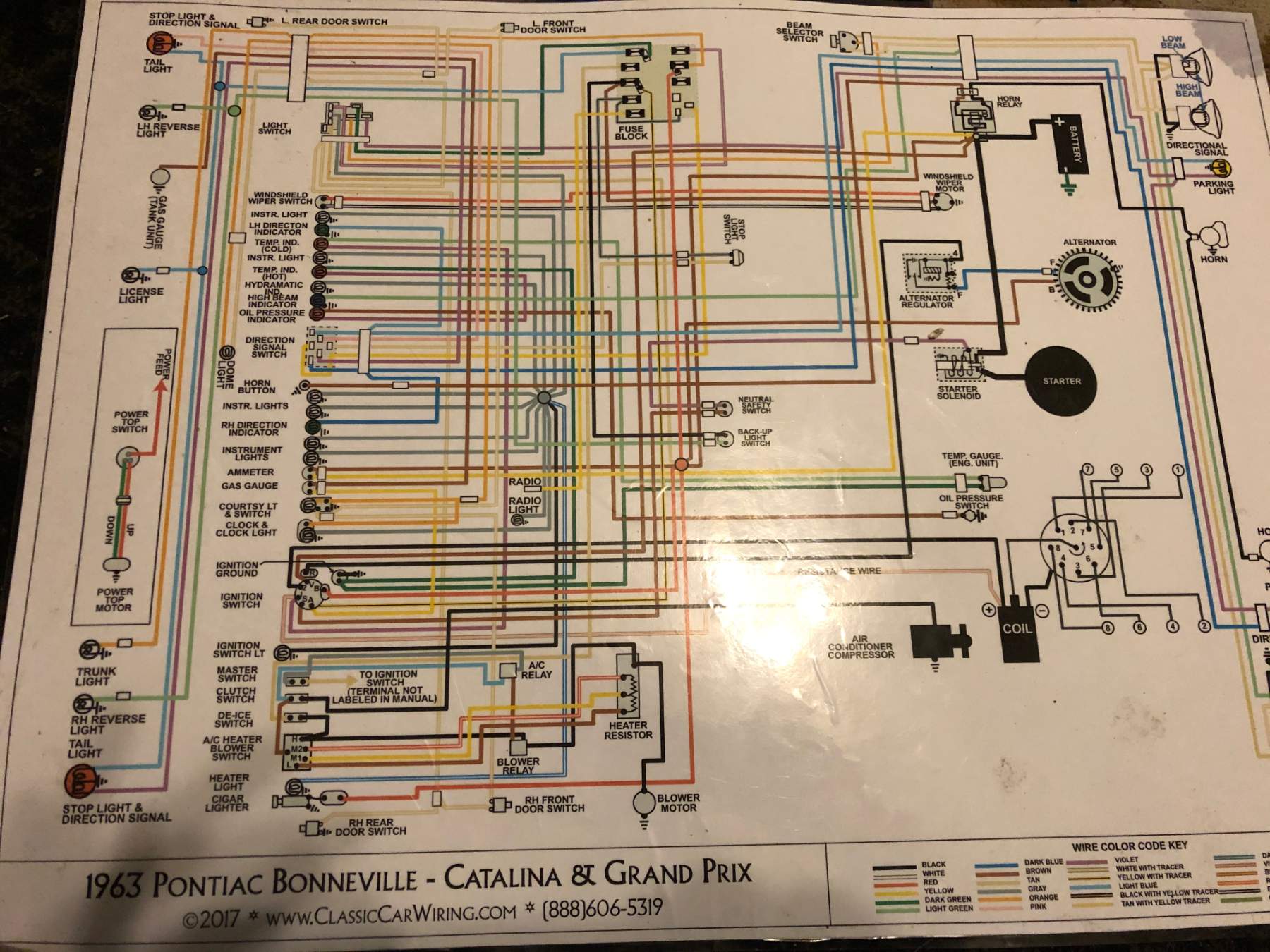

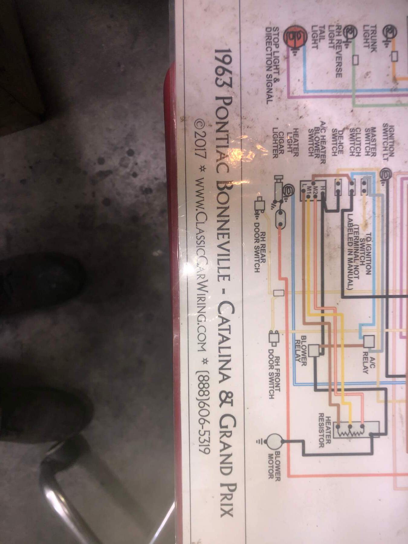

Hello, I would like to beg borrow or purchase that set of wiring diagrams.  message me a price and you have a deal.  Also, I promise to share with other pontiac builders.  Thank you.

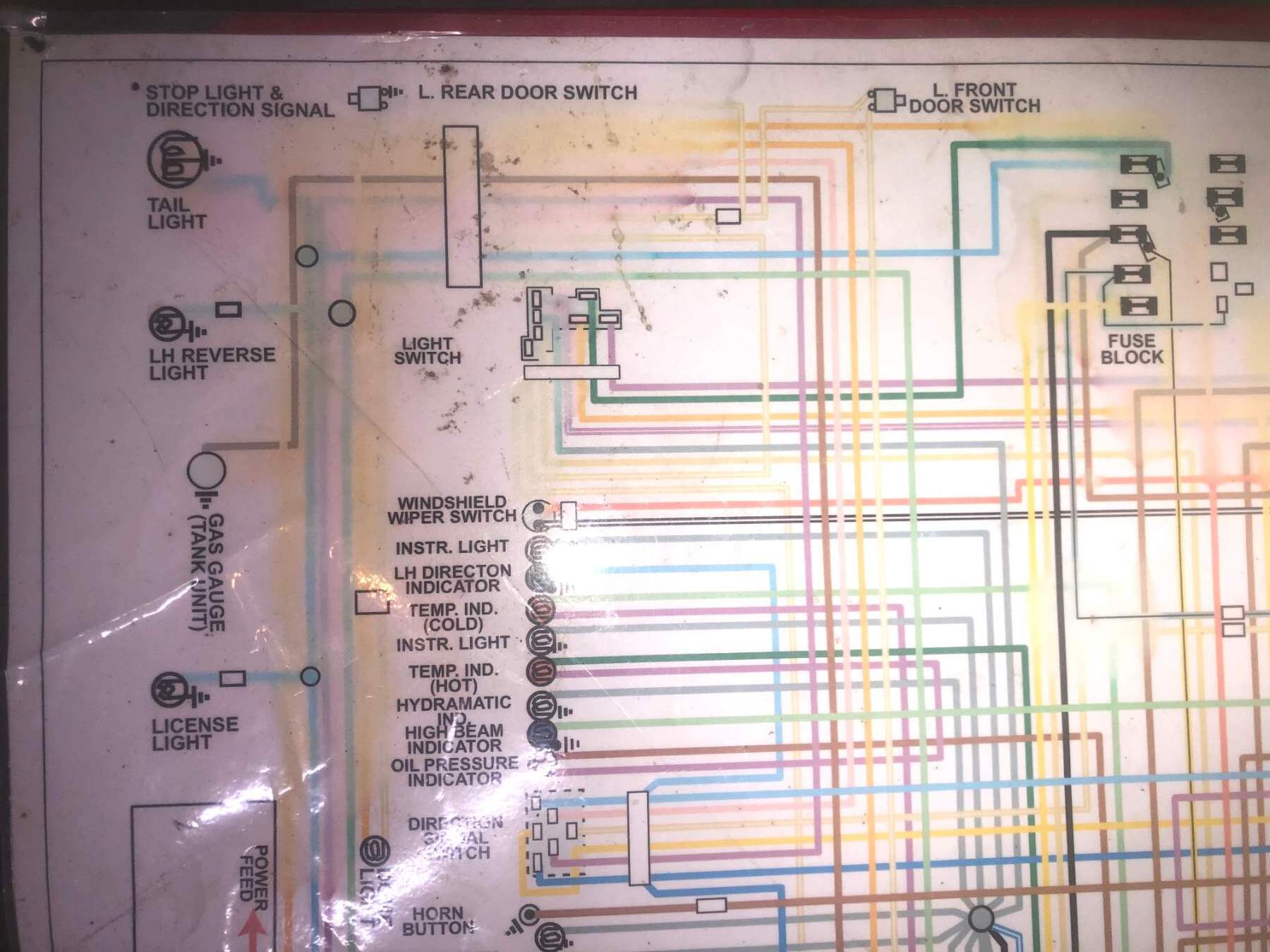

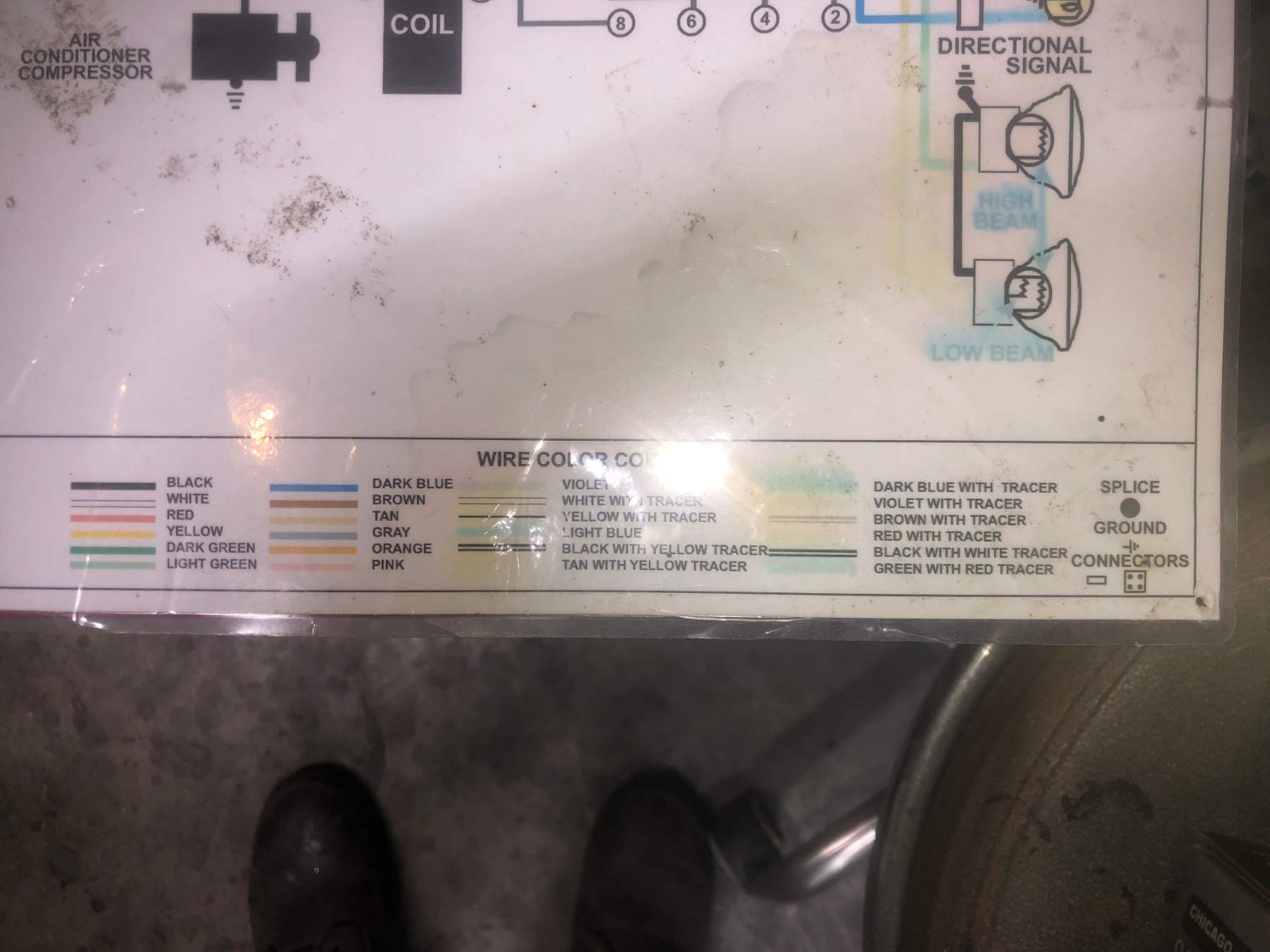

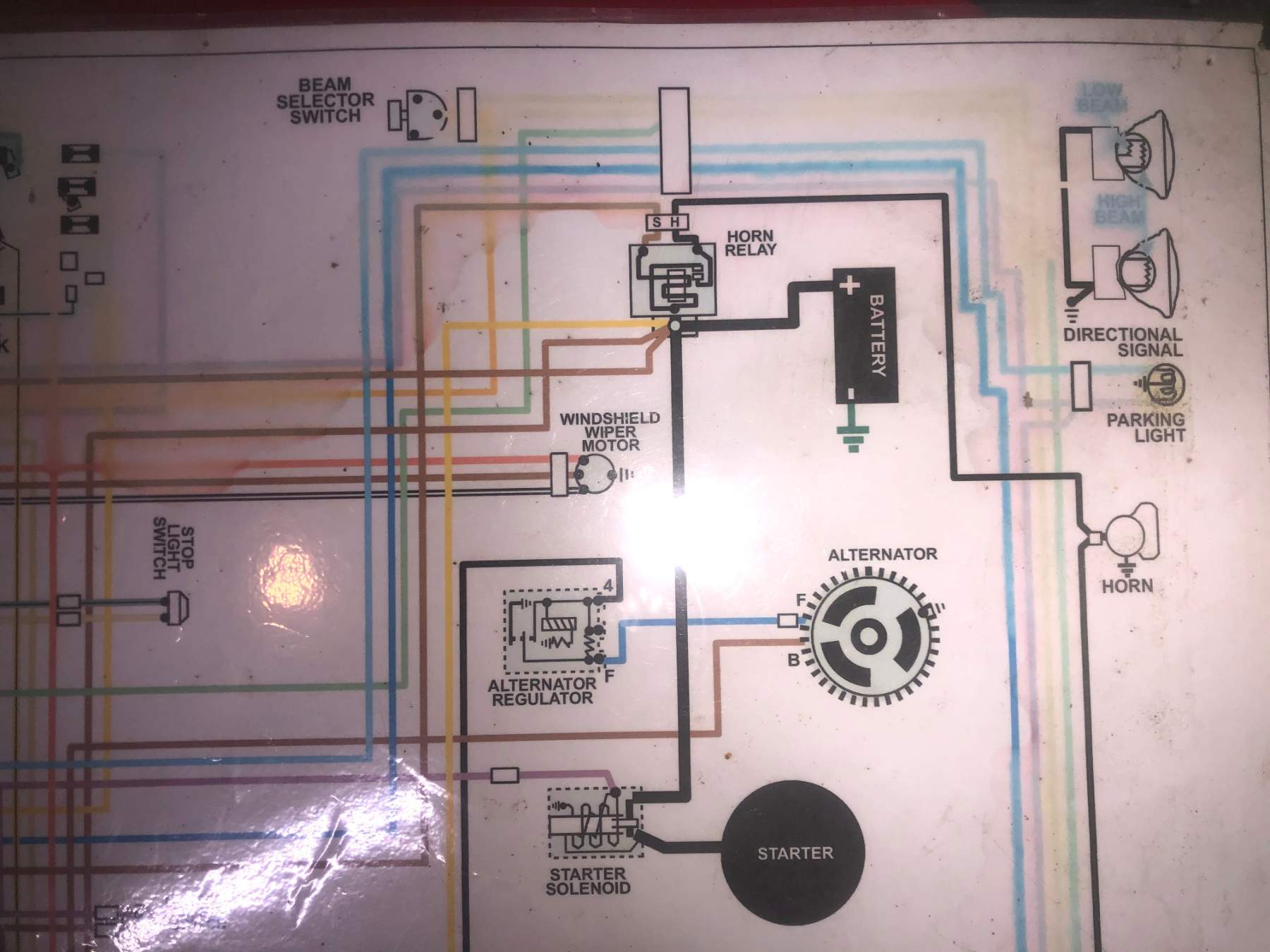

Hey Jim, I'll get you some pics and the company's name that I got them from within an hour or so buddy.
Ok bro. So the last 5 pics I broke up into pieces in case you want to print and reassemble. The company I got them from is Classic Car Wiring They offer 2 sizes. The large which is what my old eyes told me to get was $29.95. Not sure how good these pics will be. Hope they help bud. If there's anything else you need just ask.

Thank you.  I just ordered the 18' x 24" set of drawings.  Thanks for the lead!  This is great stuff.
