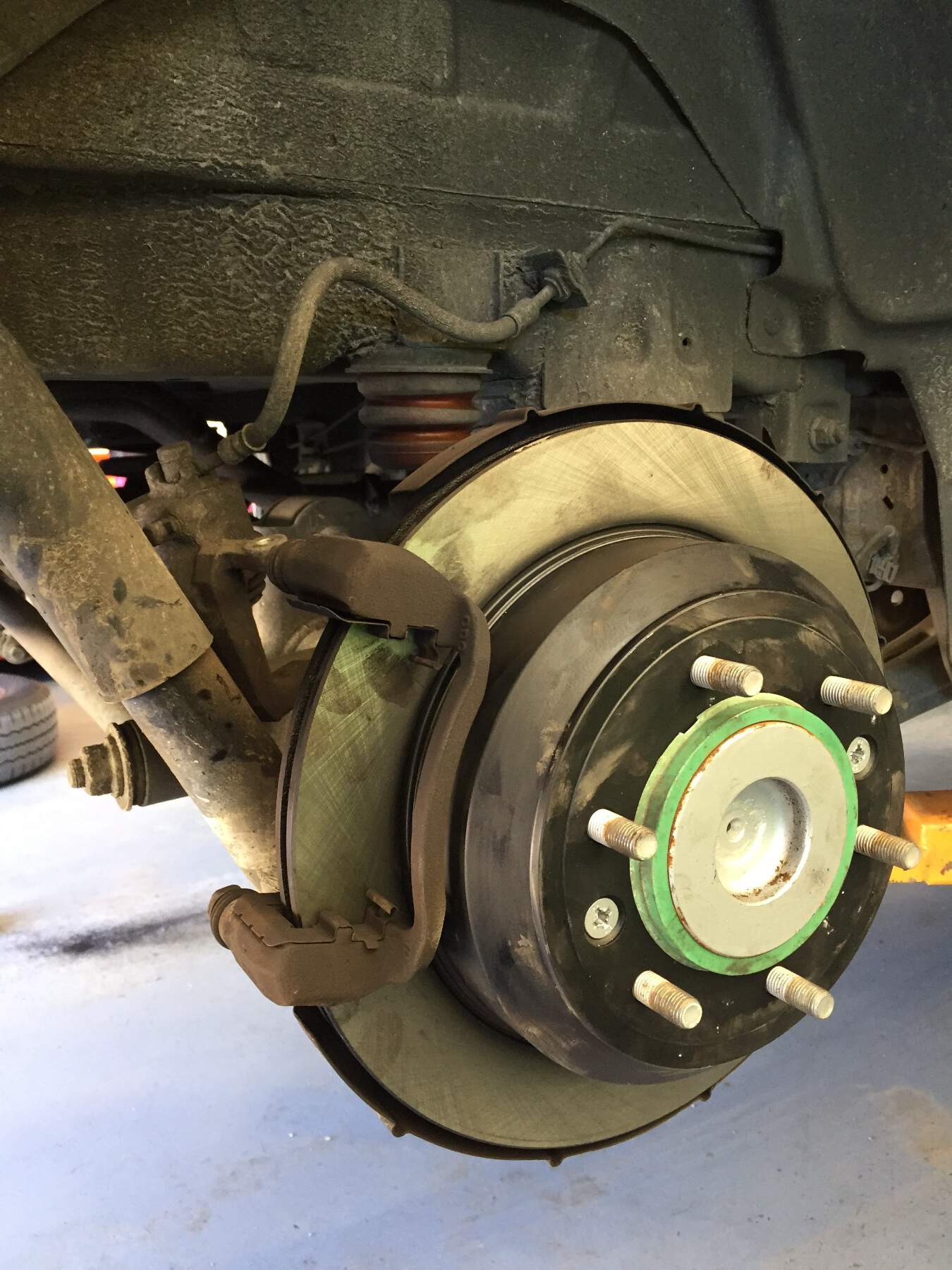

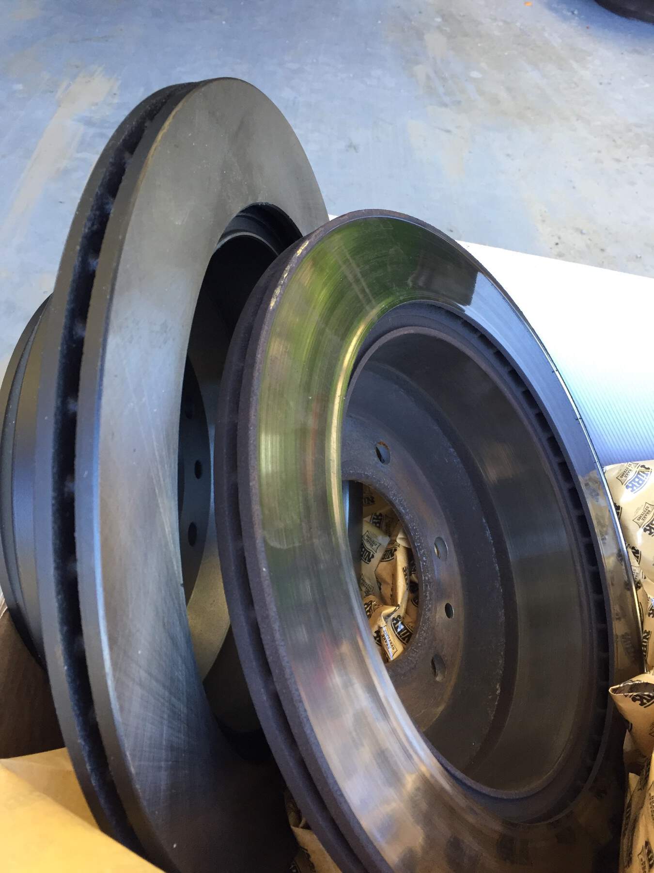

Today being Sunday is my first day off in a while so
over due work has to be done , full service and swap out discs and pads on the work van
150kms and back discs are shot !
i already had to do the fronts at 100kms
they must be really soft cast iron 🙄

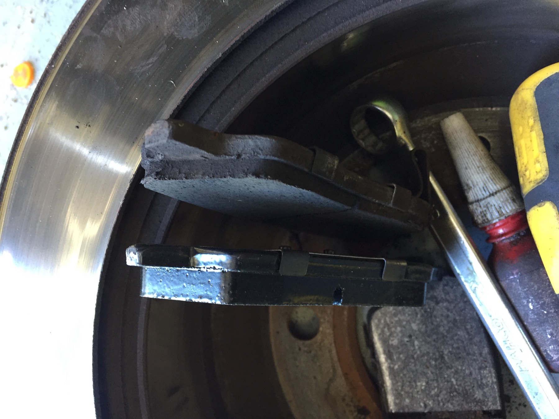

Weak piston?  Wear on the pad is off balance.  Wore out on one end and almost new on the other.  Assuming it's a duel piston caliper.  Rotor looks good as we appear to be lookin at the backside which usually gets torn up from the piston pressure.  All about finding the time to get er done.
Ah, they are just single piston calipers JustA, and the wear is even over both sides of both discs, JustA that they are now worn past the point of milling safely, so are a throw away item!
the van weighs in at 2737kgs all up which i think will have a lot to do with wear 🤨
 plus with me towing a trailer full of building materials to the the beach house for the last couple of years probably doesnt help! haha
