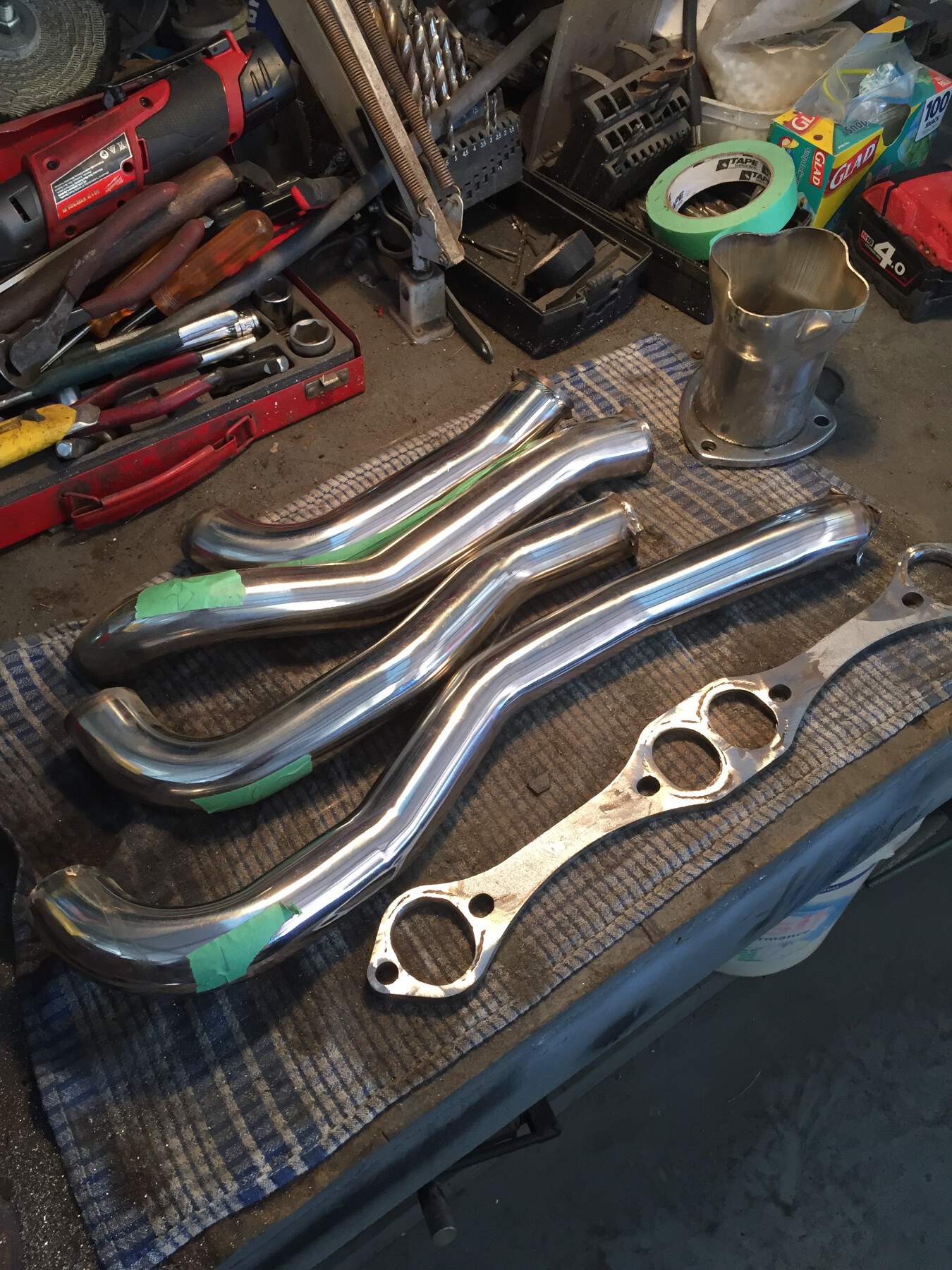

    i bit the bullet and chopped up the left hand header! tacked it together and since i am still a rooky tig welder i gave it to my good mate who welds stainless steel for a living ( last 40 ye

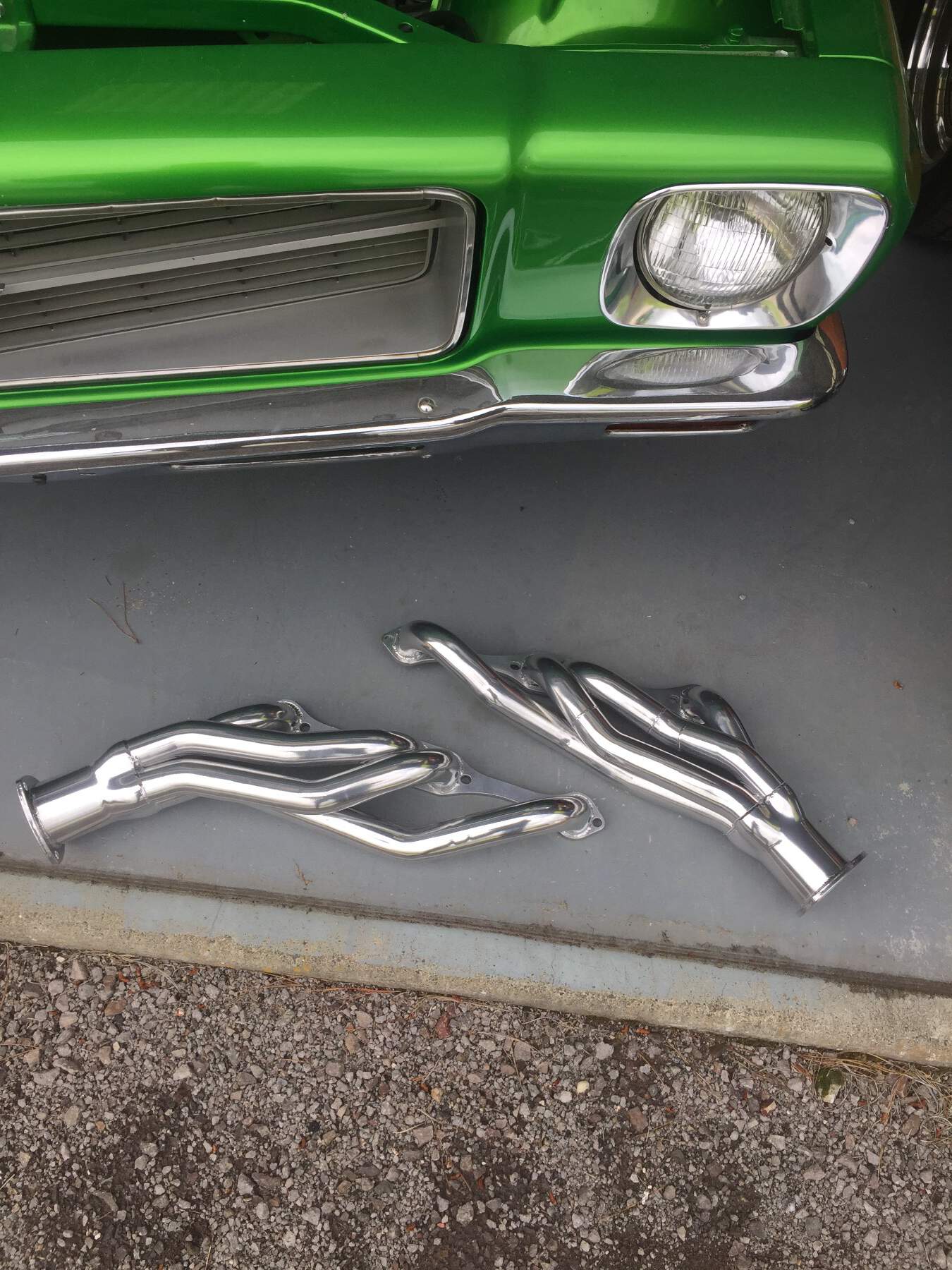

    Got the hq headers back from hpc on Friday  looking very good  And got them bolted up  and looking very smart

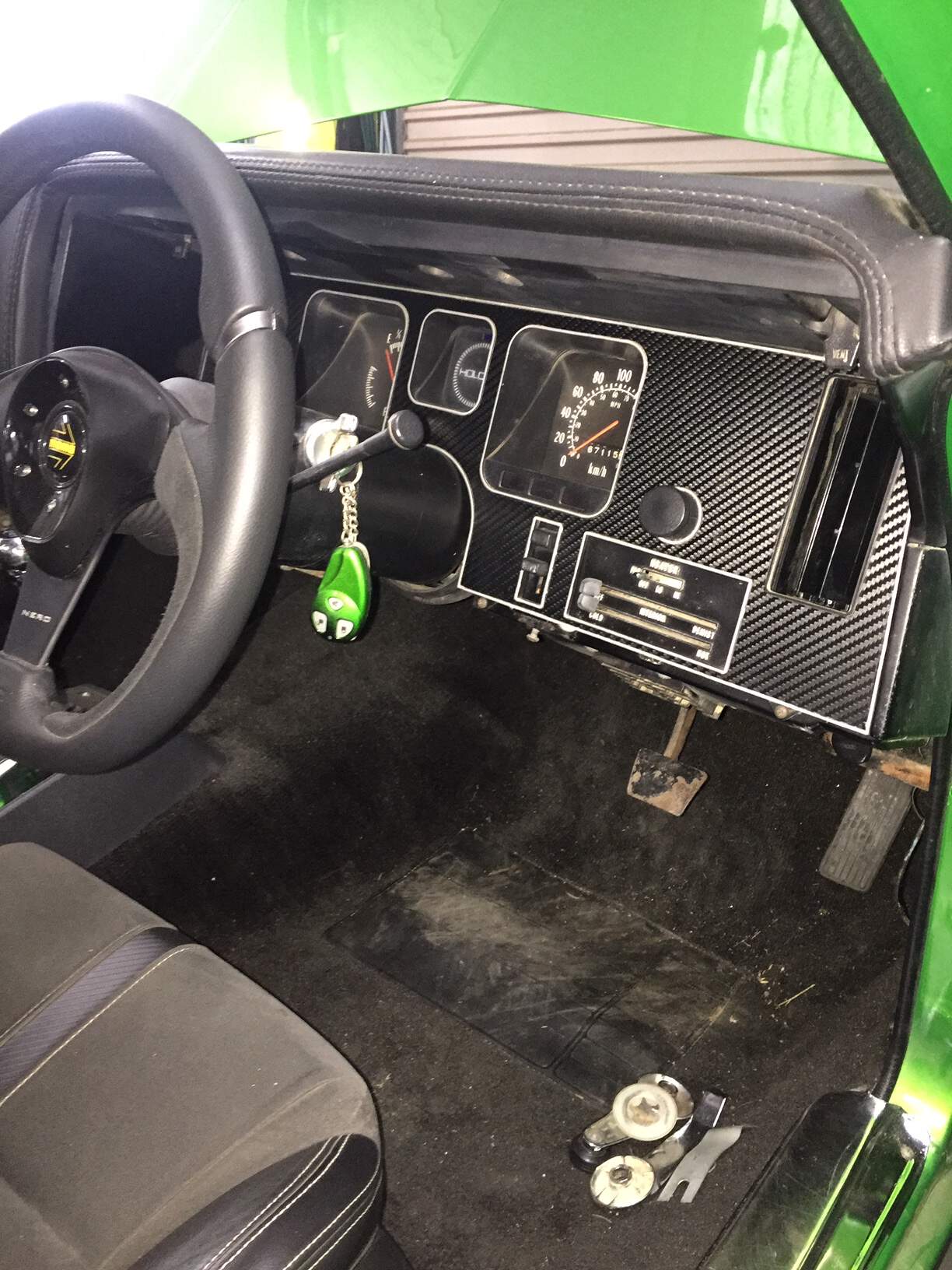

i used the carbon fiber on the HQ dash, 👍
Yeah Kiwi, that looks good bro!

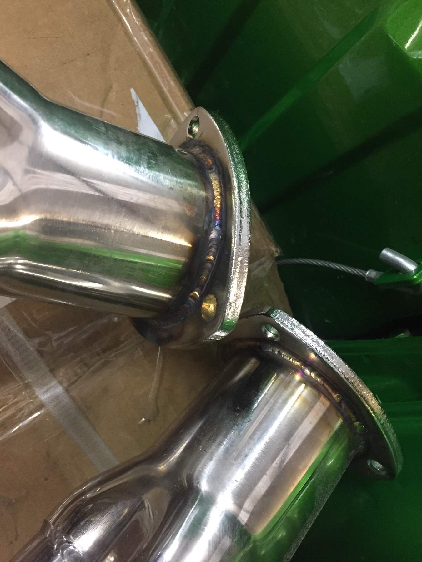

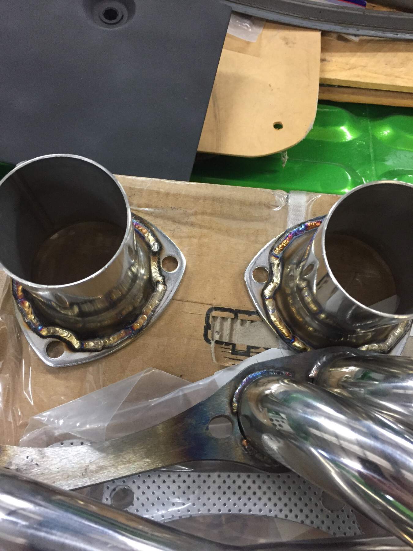

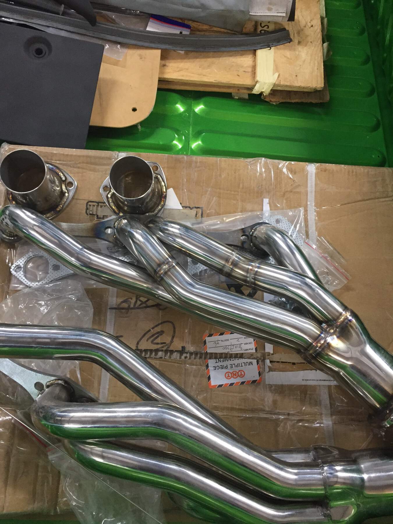

tacked it together
and since i am still a rooky tig welder i gave it to my good mate who welds stainless steel for a living ( last 40 years)
The headers when i bought them had the 3 inch flanges loose on the tube, and i thought that was a dumb idea!
i had my mate weld them up so i can use a flat gasket and make a good-long term seal :cheers:
Next thing is i am going to take them  to my hpc coating man and get them sliver hpc coated :cheers:
 Stainless looks great but i want the heat removed from the engine bay and they will still look good in silver.... just that they will look good for longer too !!:cheers:

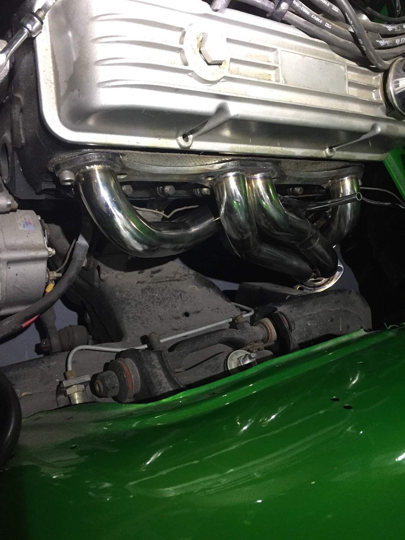

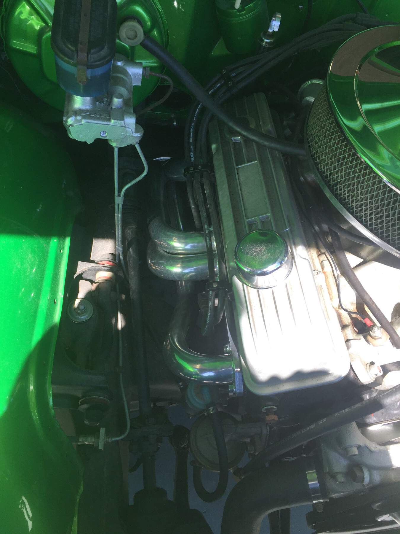

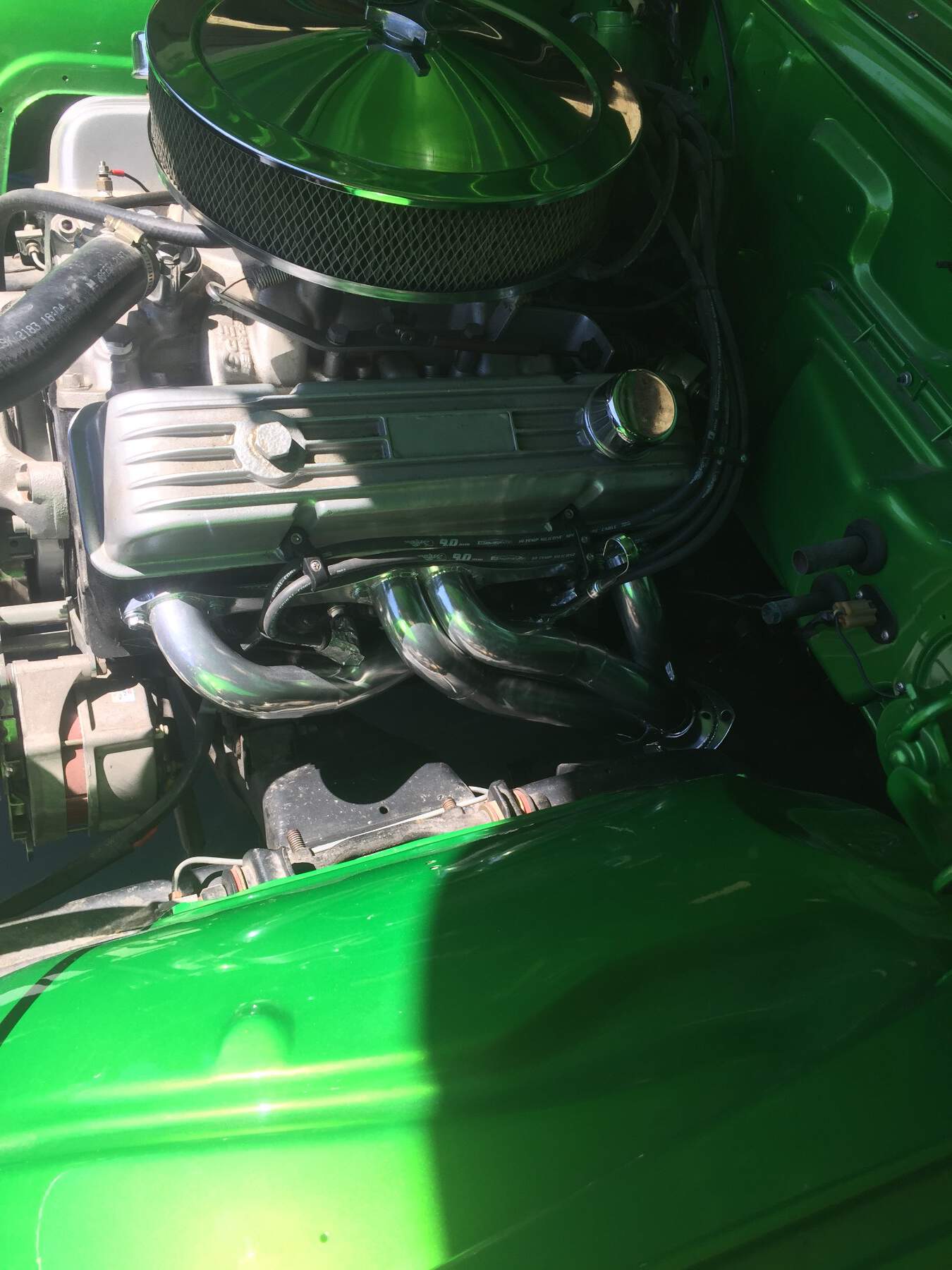

looking very good
And just wanted to hear what it sounds like 😀
