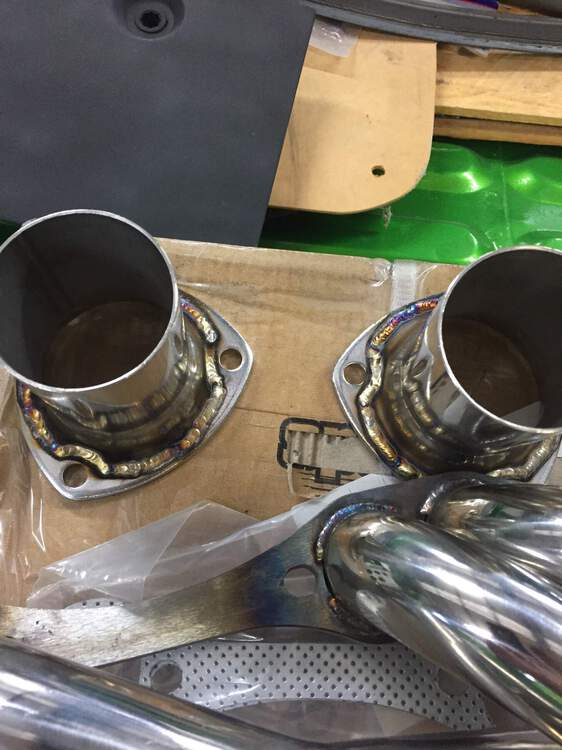

    i bit the bullet and chopped up the left hand header! tacked it together and since i am still a rooky tig welder i gave it to my good mate who welds stainless steel for a living ( last 40 ye
  • 64 kiwi boni
    64 kiwi boni

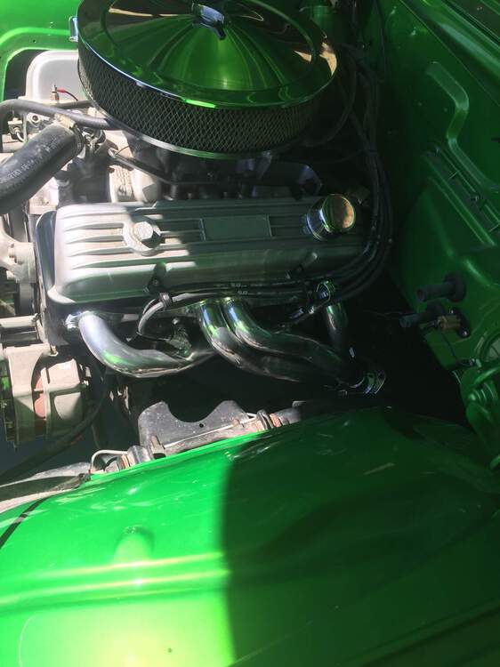

    Got the hq headers back from hpc on Friday  looking very good  And got them bolted up  and looking very smart

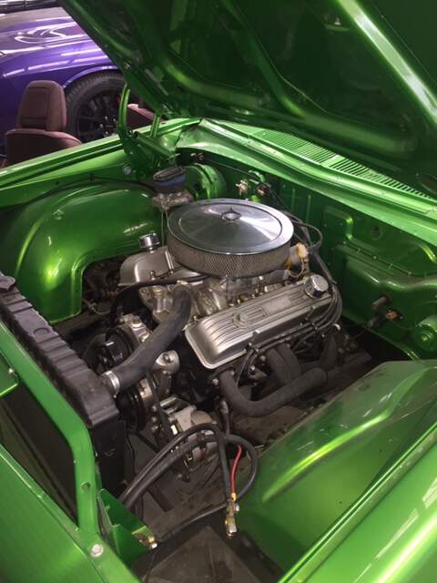

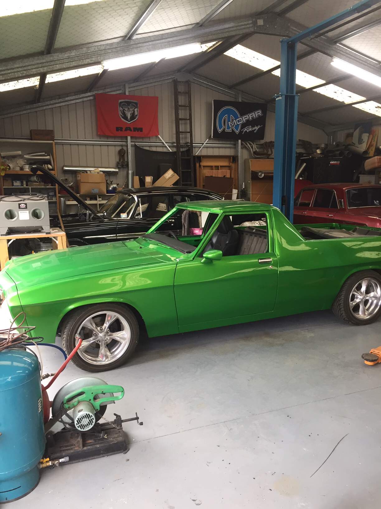

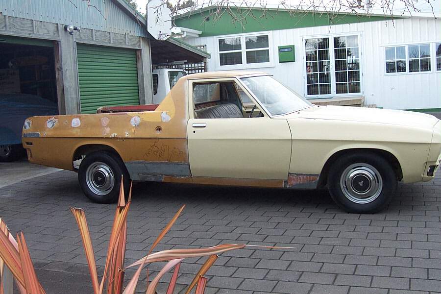

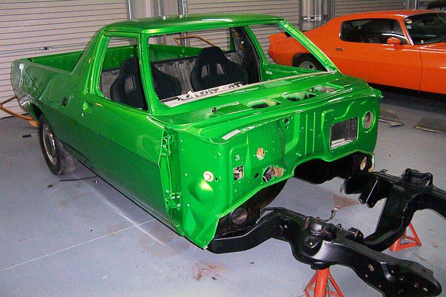

it is a 1972 Holden belmont with factory 173 cube inch straight 6, very simliar to the 60"s  chevy motor, but Holdens version, with a 3 on the tree box and bango ltd slif diff.
Rust wise, it wasnt too bad (for a Holden) !!!
 These things where work horses and very basic.
14 inch wheels, A arm front end pretty much like a gen 2 Camaro, manual steering.
 Oh but full chassis and the tray is fully galvanized
so together we striped all the paint off and cut out all the rust and got it to primer stage.
Sent it off to my mates paint shop where it sat for nearly 2 years, but it was worth it.
when we got it back it was show level workmanship, the colour is custom with a fine flake in the green

 He then offered to de tune it.... street manifold, cam and heads... and a much better number, so i said yes.
What i got was a small block 400, with less than 200 miles on it, steel crank, forged pistons with all internals fully balance (Trust me it makes a huge difference to the way it revs)
 fully blue printed and he fitted double hump fuelies with a dual plain manifold.( port matched)
 i went up to his place to get it and once i fitted it into the ute, he came down and tuned it..
 i am not sure if i can put up a video here but to hear this thing, is bloody awsume !!!
i live in the country and when i start it i get calls from my neighbors about how hot the ute sounds from a distance ( got petrolhead neighbors)👍😋:drool:

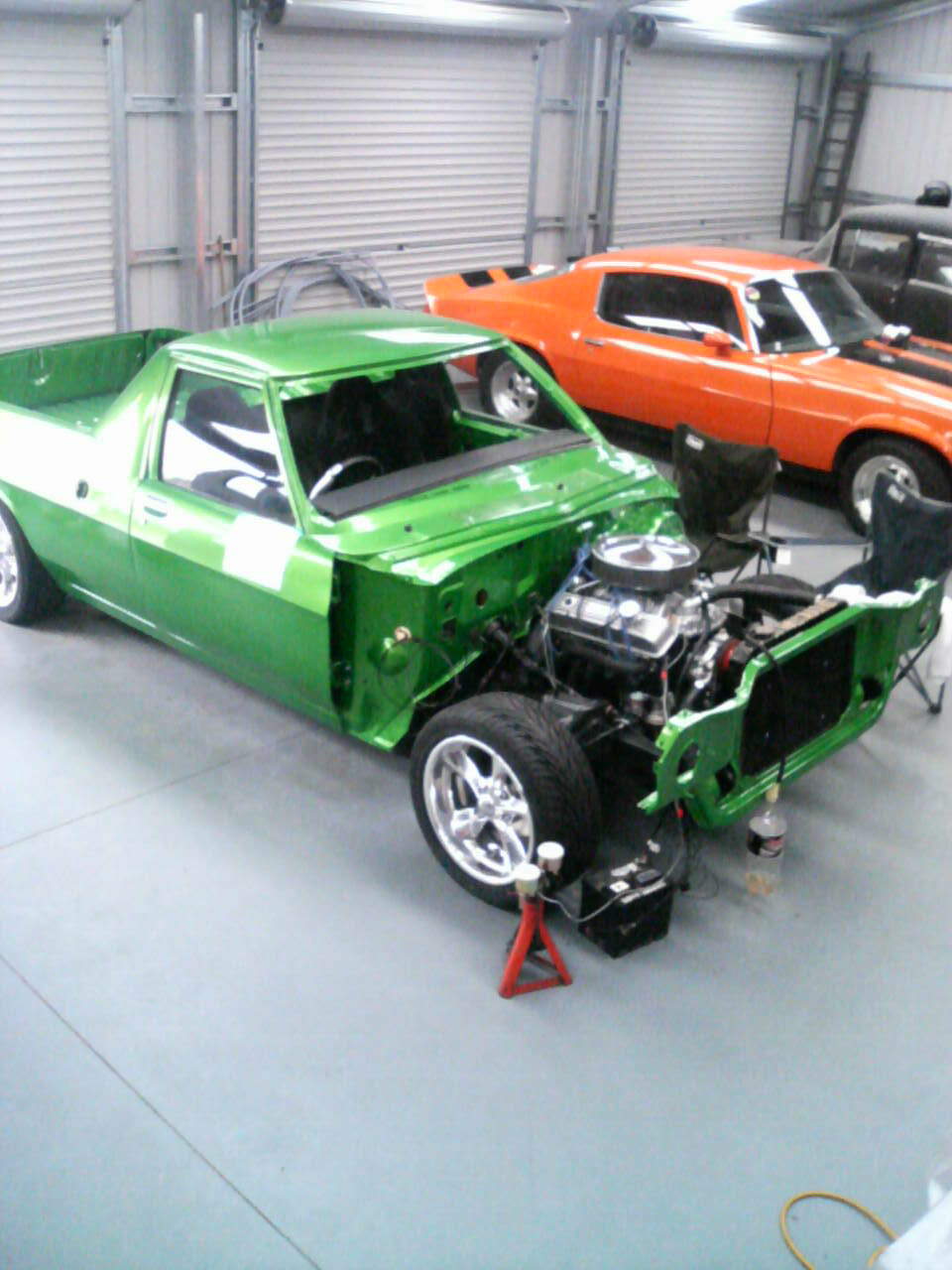

From there, it was a custom built turbo 350 trans, custom driveshaft and i had my good mate build a 9 inch with disc for the rear, chassis got full rebuild with all new parts front and rear, set of boyd coddington junk yard dogs 17inch ( got to remember this work was done over ten years ago)
and at the time some rear dumb race seat!! ( watch this space)😜
i rewired the whole thing, which was easy, b and m shifter and some stock pacemaker header ( watch this space)😜
next week i am going pull it out of storage and show you what it looks like and i plan to get some work done, or what i can do with what i have on hand.

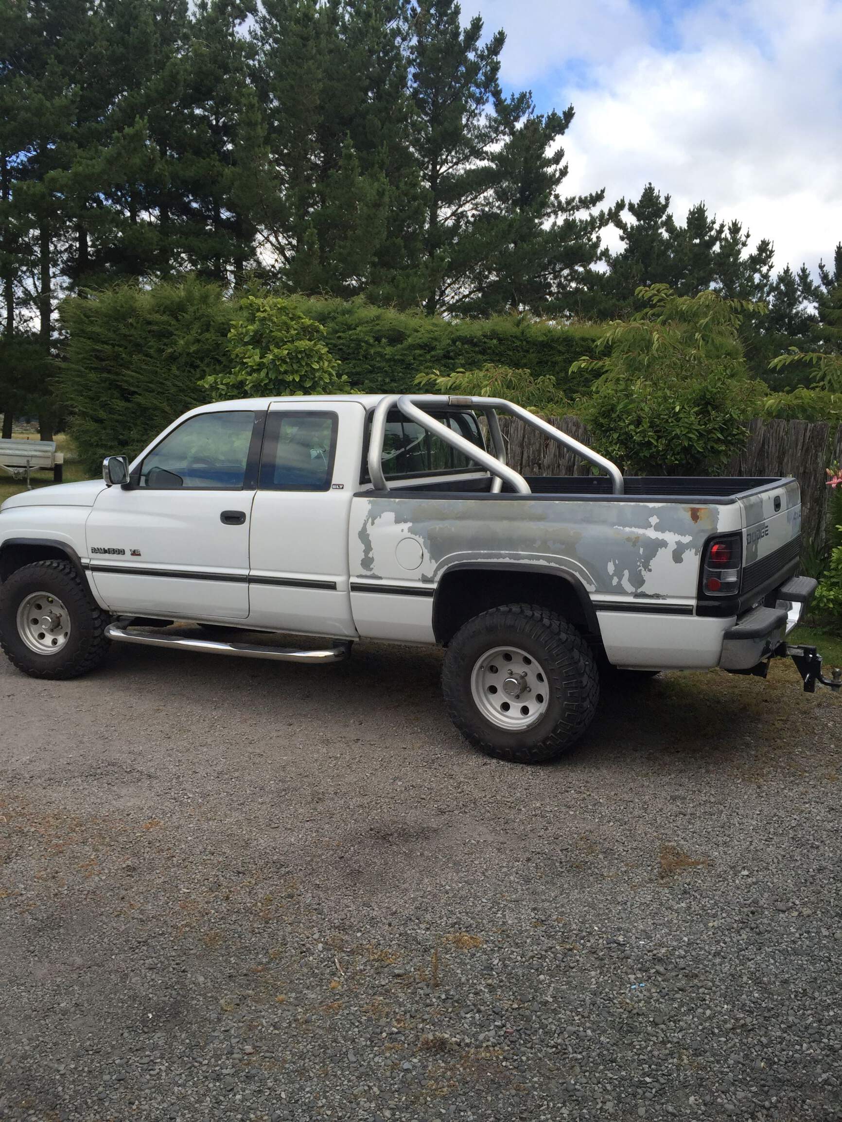

shes done 380k miles before i got her, has had a new motor, gear box and god knows what else before i got her. original paint, which i will not touch.. it so cool to have the patina. the boss keeps going on at me to repaint it but i dont want to, once you paint it its not original.
 it has no rust except what you can see on the rear.
 Up till 2 years ago we used her to tow our retro caravan, and spent many weekends at the beach with our mate on the turps!:cheers: and my vinson 500 fits nicely on the back with the tail gate closed, fishing gear loaded up, konkiki etc
you will note Harry is in and ready to head to the beach !!!

So with the weather being sh-t i cant do much on the Bonneville, so i am on to my HQ Holden ute ( Justa6 street :dancingpontiac: )

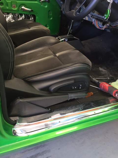

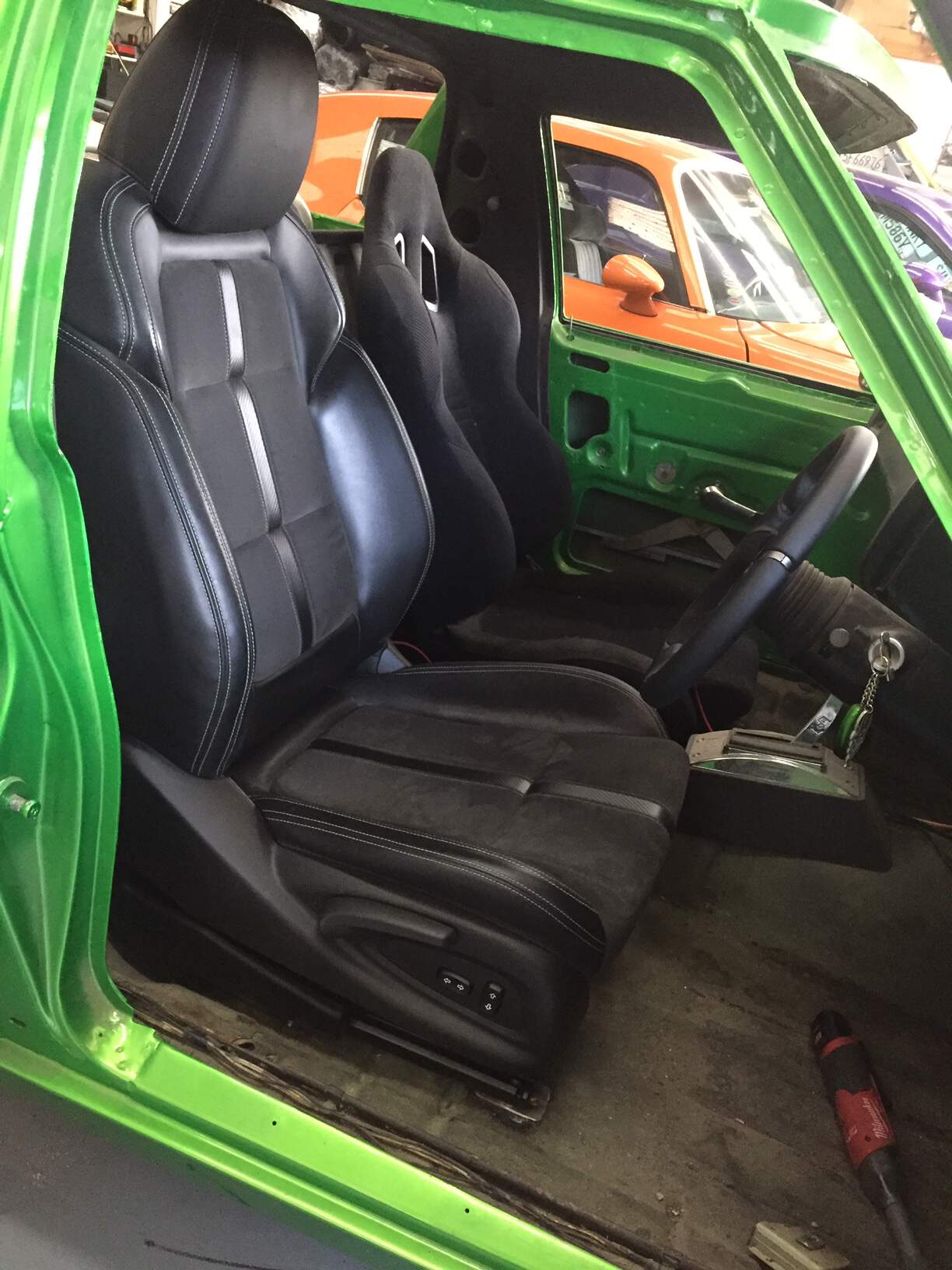

i have a set of VF commodore/ R8 pontiac seats to fit and they look way better than the "race seats"

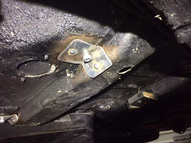

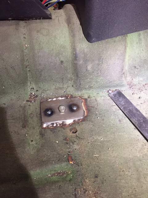

have had to make mounts to comply with our new zealand LVVTA requirements so it will get through certification to get it back on the road .
 Basically here if we mod anything we have to get it certified to get legal for the street, way easier than Australia, they have it really hard.
so i made all my mount plates and plug welded then to the floor pan...as per Blah blah 🙄
As per my hobby car manual, i have made a double plate that fits under and above the floor, min area is 3 1/4 x 2" or 80mm x 50mm and 3mm thick
 each plate has to have a 5mm / 3/16 radius corners and all which contact with the structure of the floor pan must have a 0.1 mm or 1/24th radius.
 Pretty easy with a cut off saw to tickle up 😋
 then  you have a max of 5mm plug weld  hole to hold it in place or, you can use a money rivet x 2 max 1/8 time two too hold them in place.. nothing major but very explicit in what you can and cant do.🙄🙄

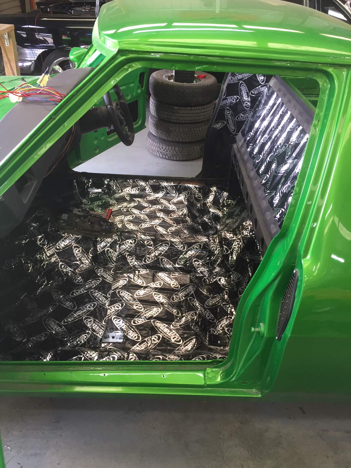

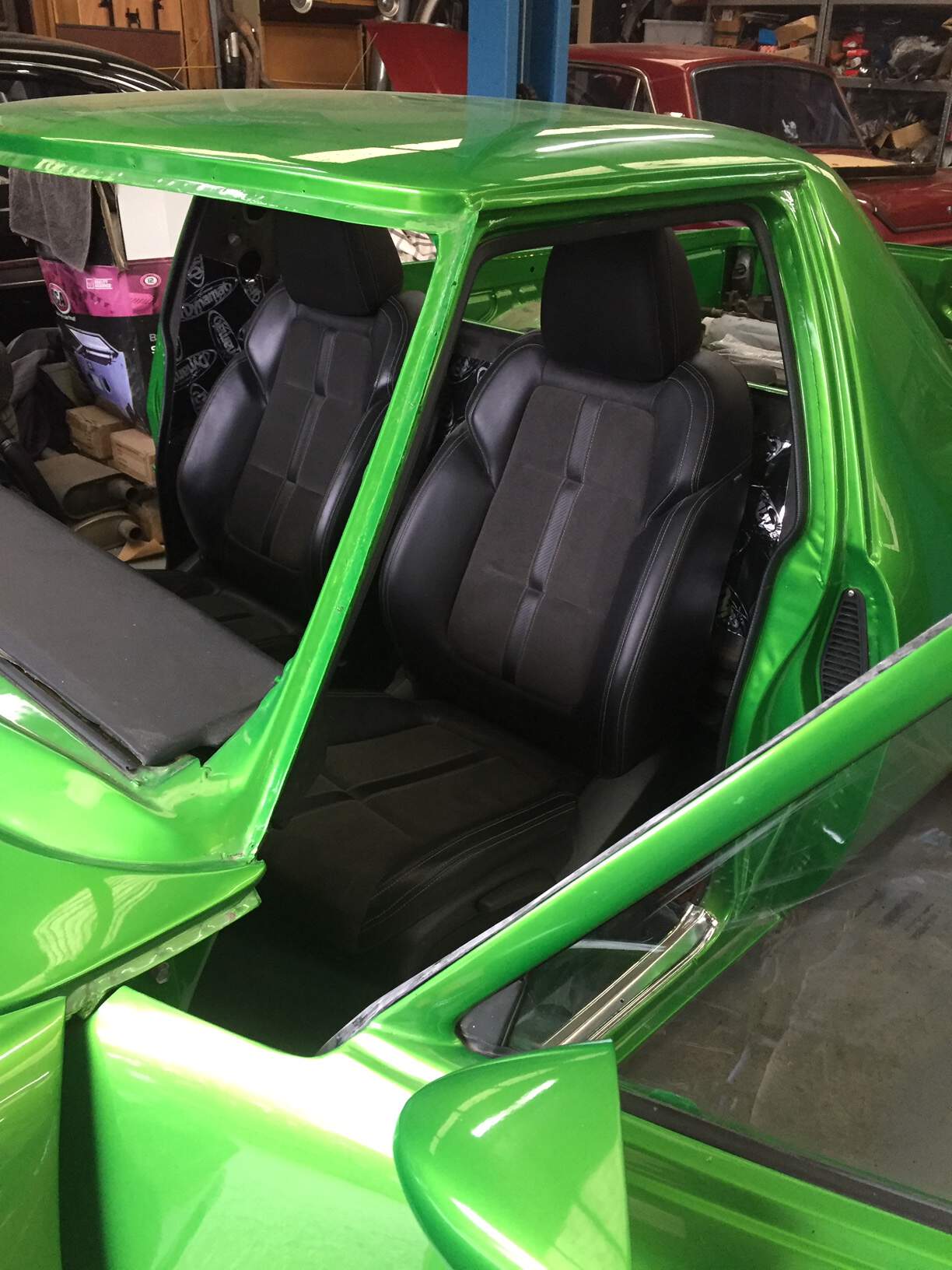

Got all the seat mount plates completed and used a whole mega dynamat kit on the floor, inner rear panel, roof and inner doors.
installed the carpet kit and wired in the seat controls.
bolted new seats in and am very happy with how much nicer they are than the repo "race seats"😜

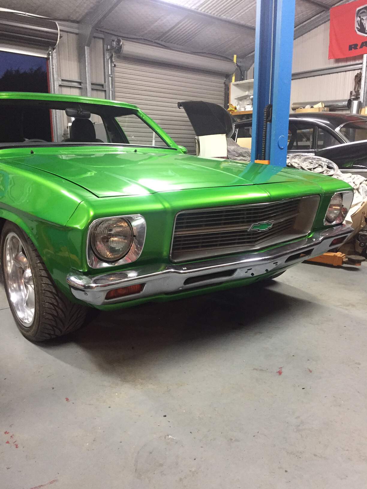

Got  all the front assembled and looking nice and clean, removed the Holden badge and Chevroleted it :cheers:
Very cool kiwi. Nice matching green bowtie to go with it.

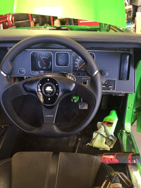

Put all the dash back in and did a carbon fibre sticker job on the dash and hand brake, just to tidy it up a bit
Fiddly work but worth it:cheers:

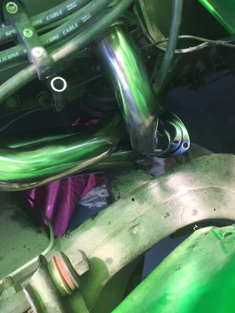

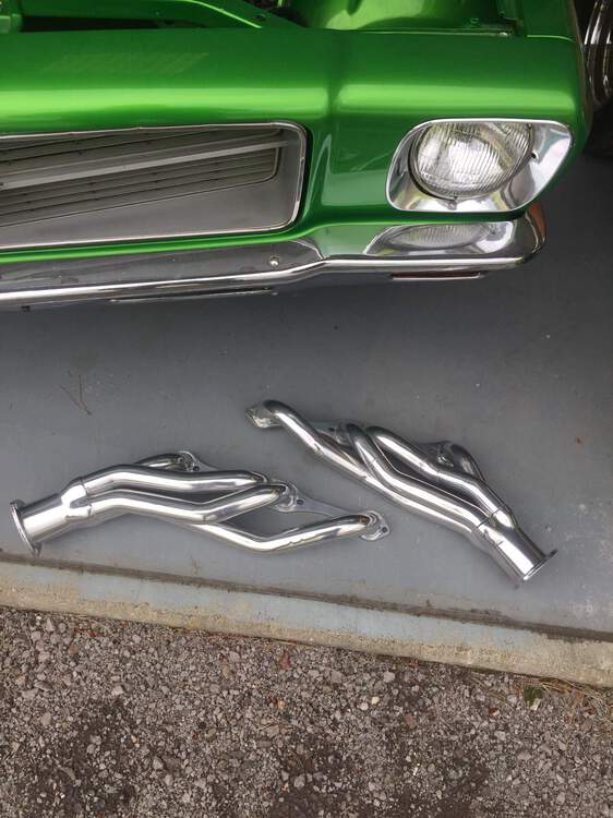

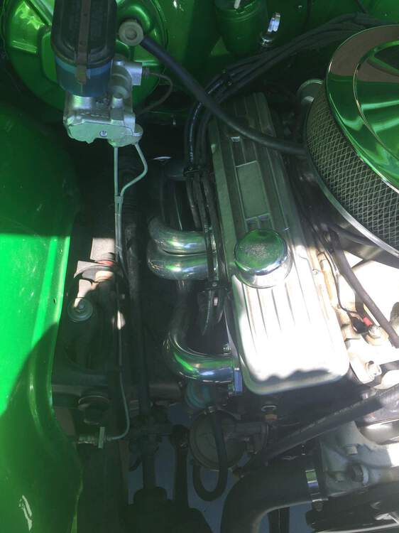

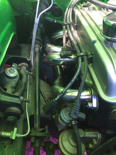

after working all saturday, i managed to get 2 hours on sunday to try a new set of shorty headers i bought, they are to suit a camaro and they are the closest i could find that will give me the ground clearance i need, all the full length headers i have tried ( 3 set) are all too low to the ground, as i am running super low springs and castlemaine 2 inch dropped spindles.
So shortys are the way to go... BUT 🙄
Right hand side was a perfect fit even with my right hand steering !👍😜 but the left side with all its room is hitting on the from suspension mount, i looked at it for about an hour and humed and herred , and i know from here the only way to fix this issue is to bite the bullet and chop it up and start from scratch :stars:
