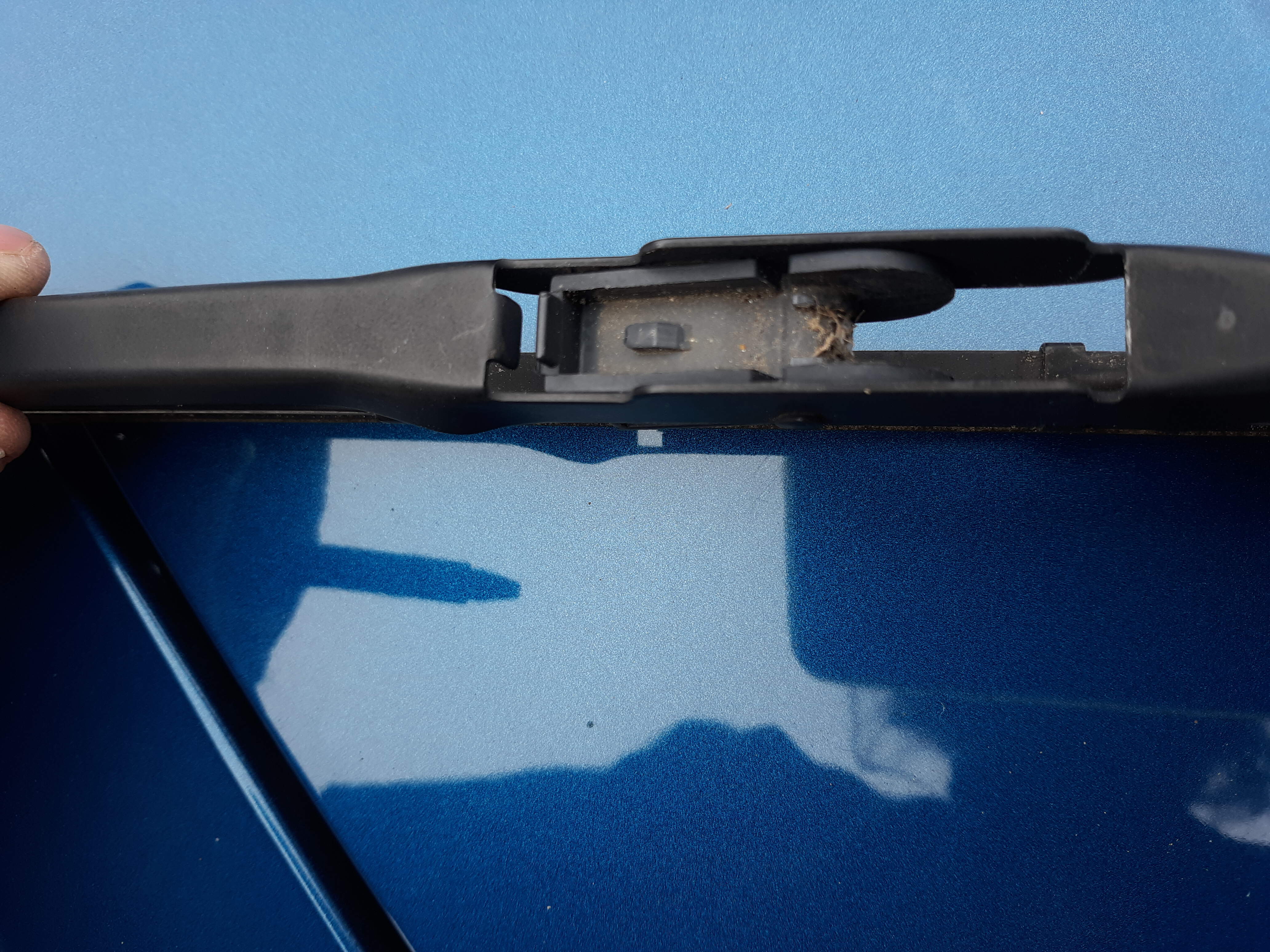

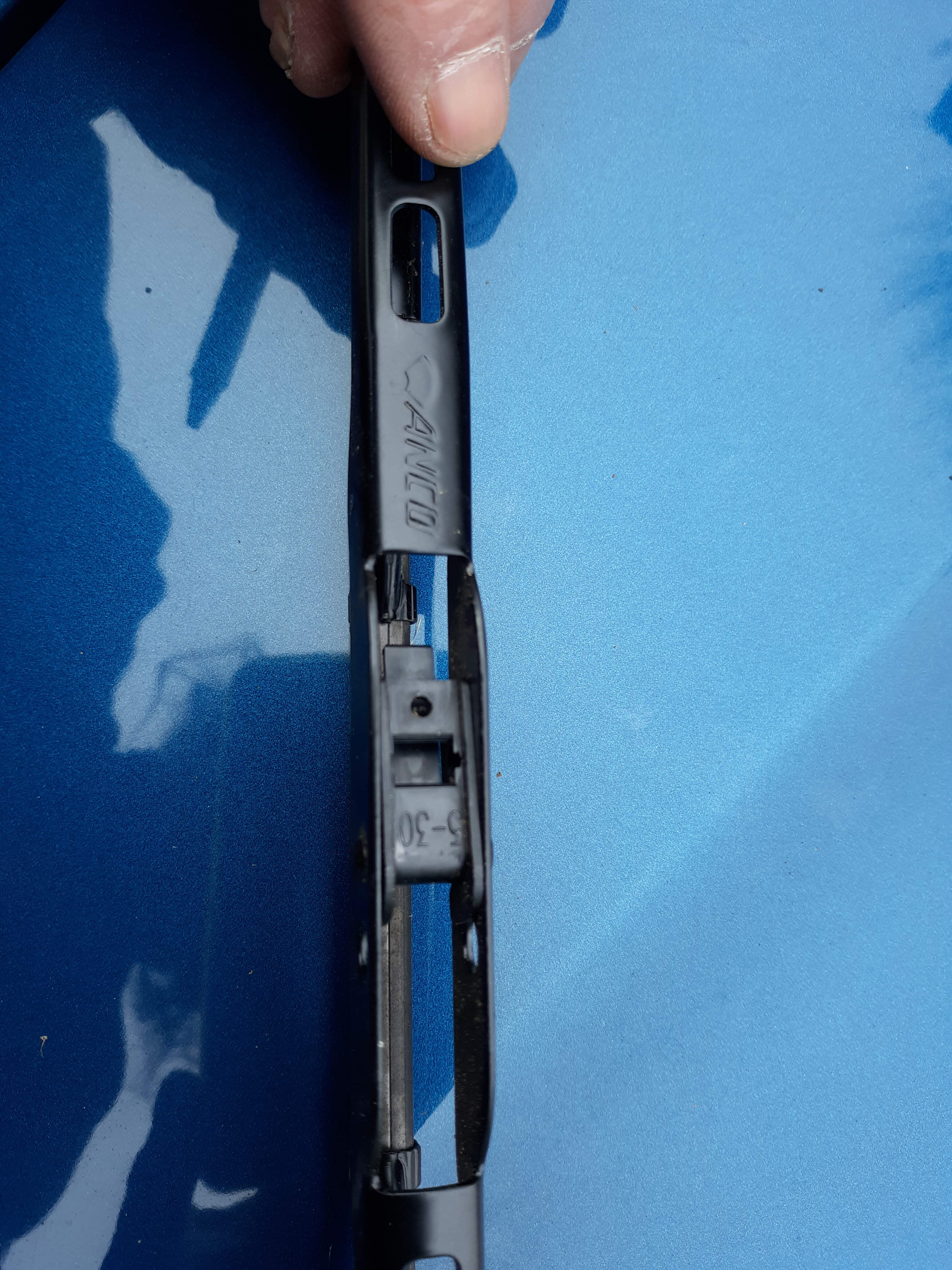

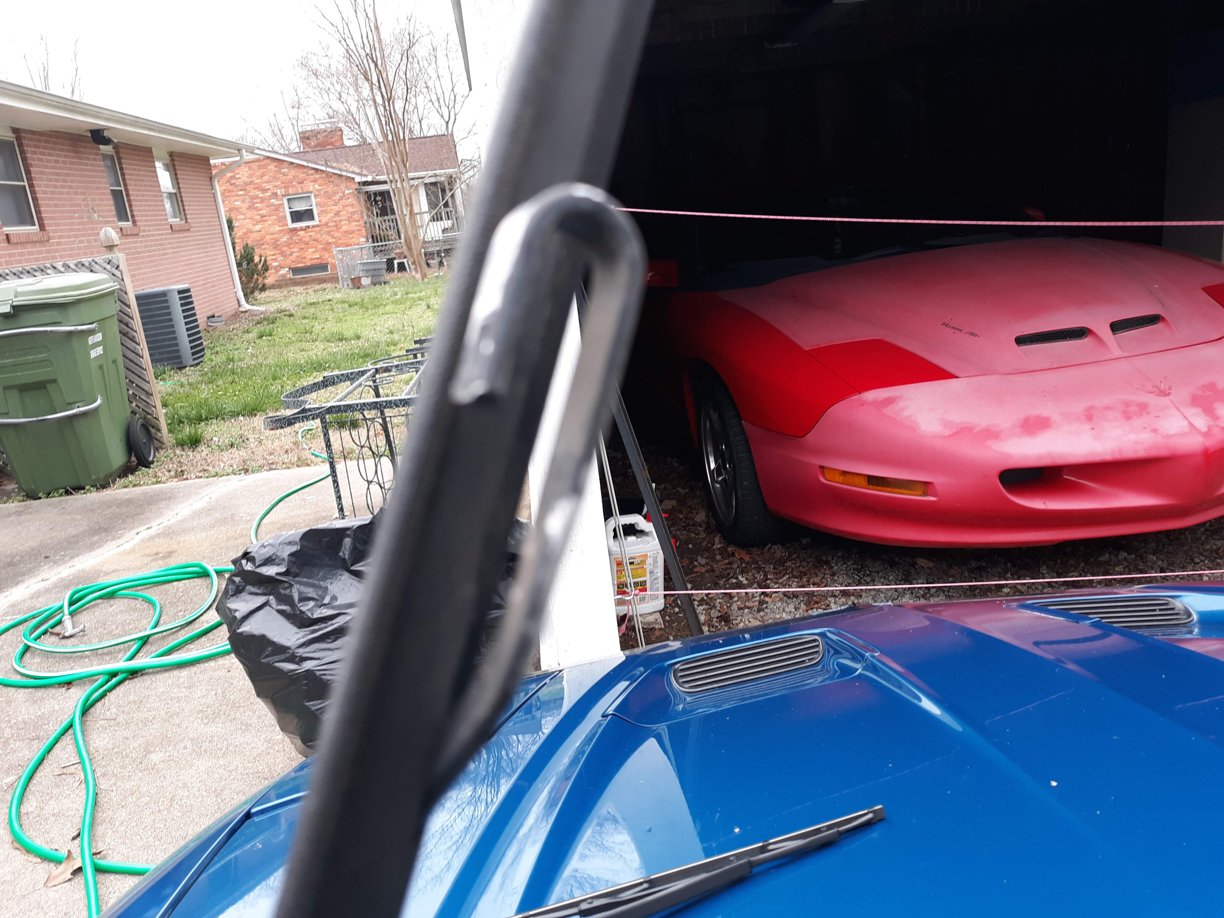

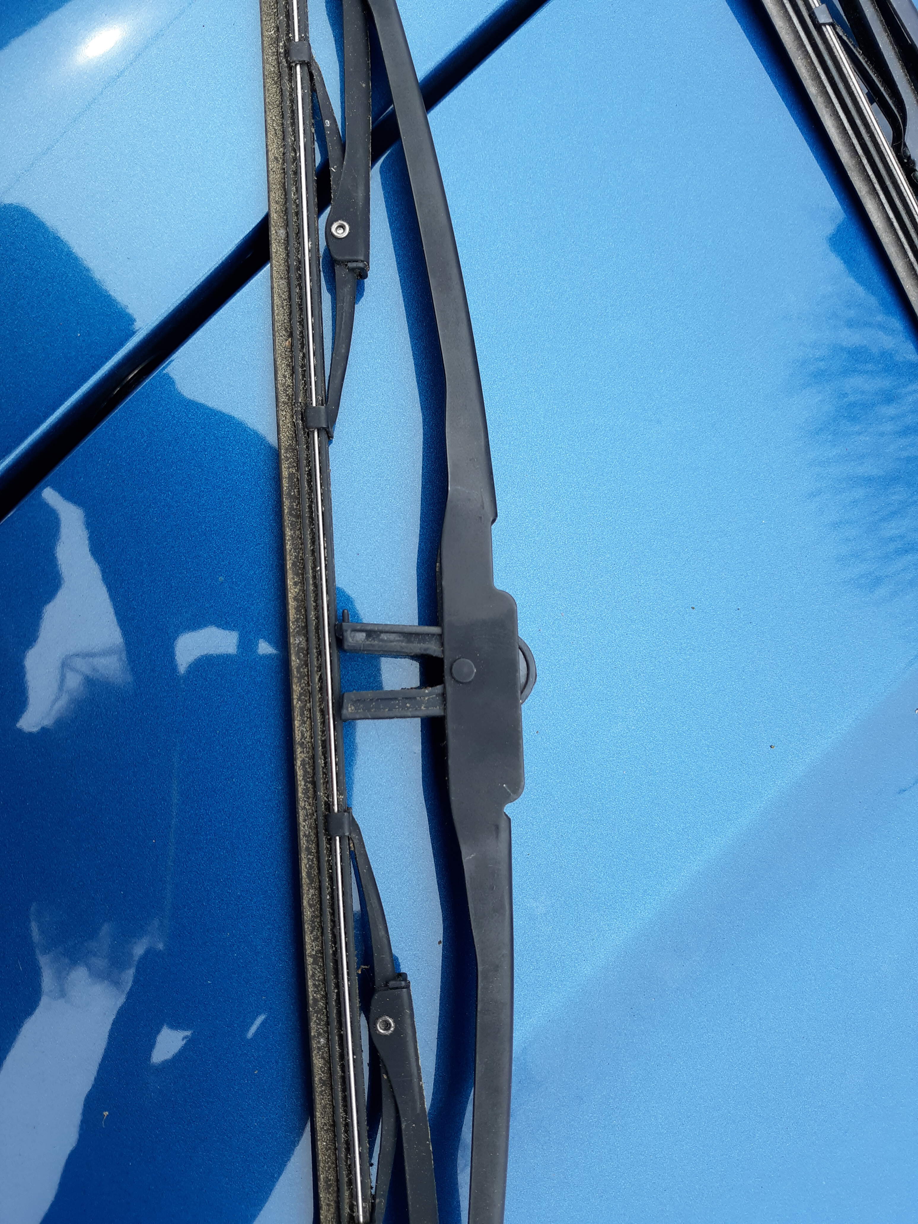

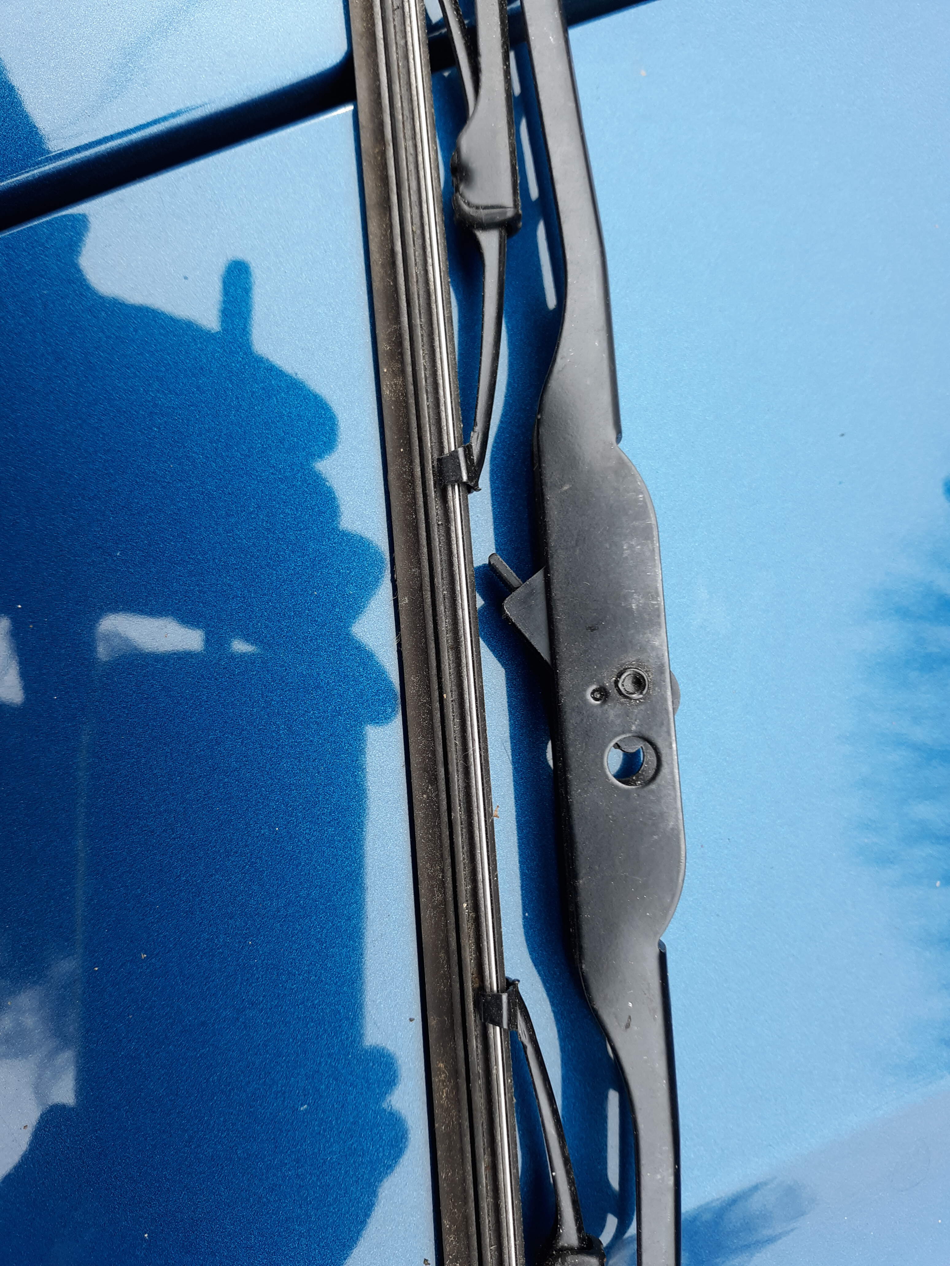

The main issue is the wiper arms on the early 4th gen F bodies are a reverse J hook design whereas the later model F cars..98 to 02 are a standard J hook design....The actual blades ( rubber part )themselves are the same....24 inch...and will interchange with each other....So in the future I can just get the later model ones and just swap out the blades....from the new ones to the old ones....
The first photo shows the reverse J hook design which the J part is up instead of facing the other way..J part down like the newer models..The next two photos are the blades for the earlier models...The last 2 photos are blades from the later models...and will not work on the earlier models..
