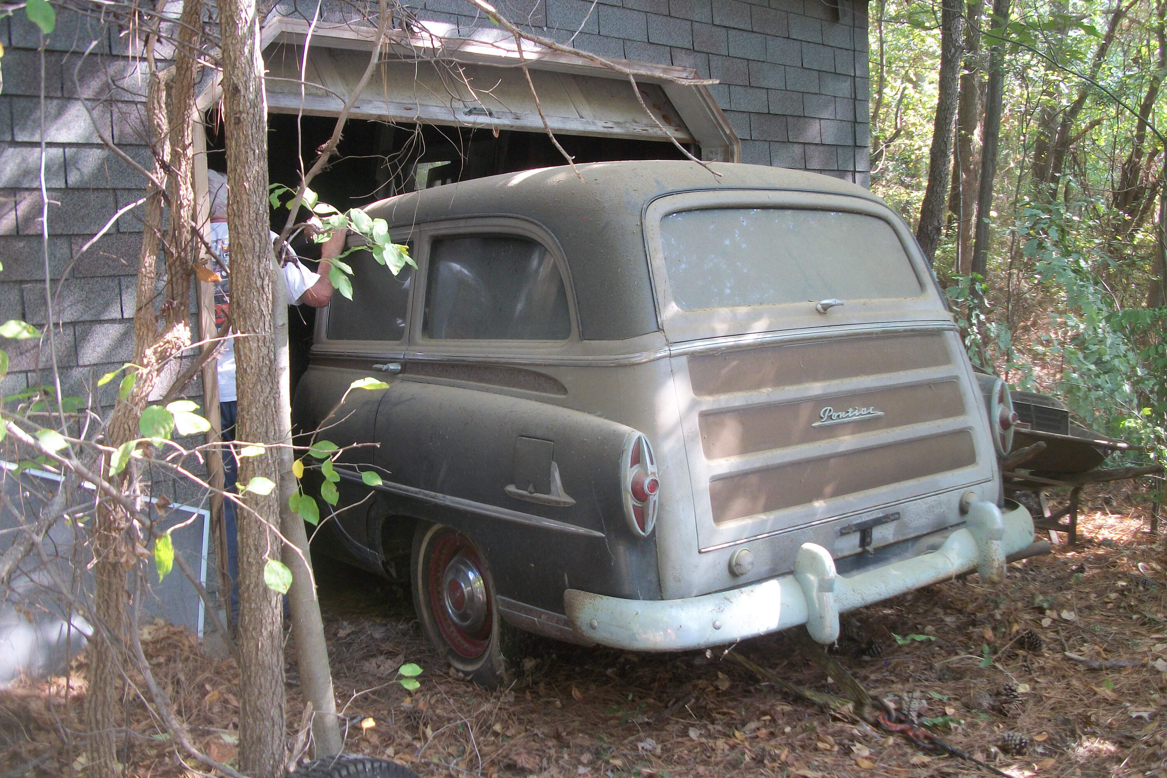

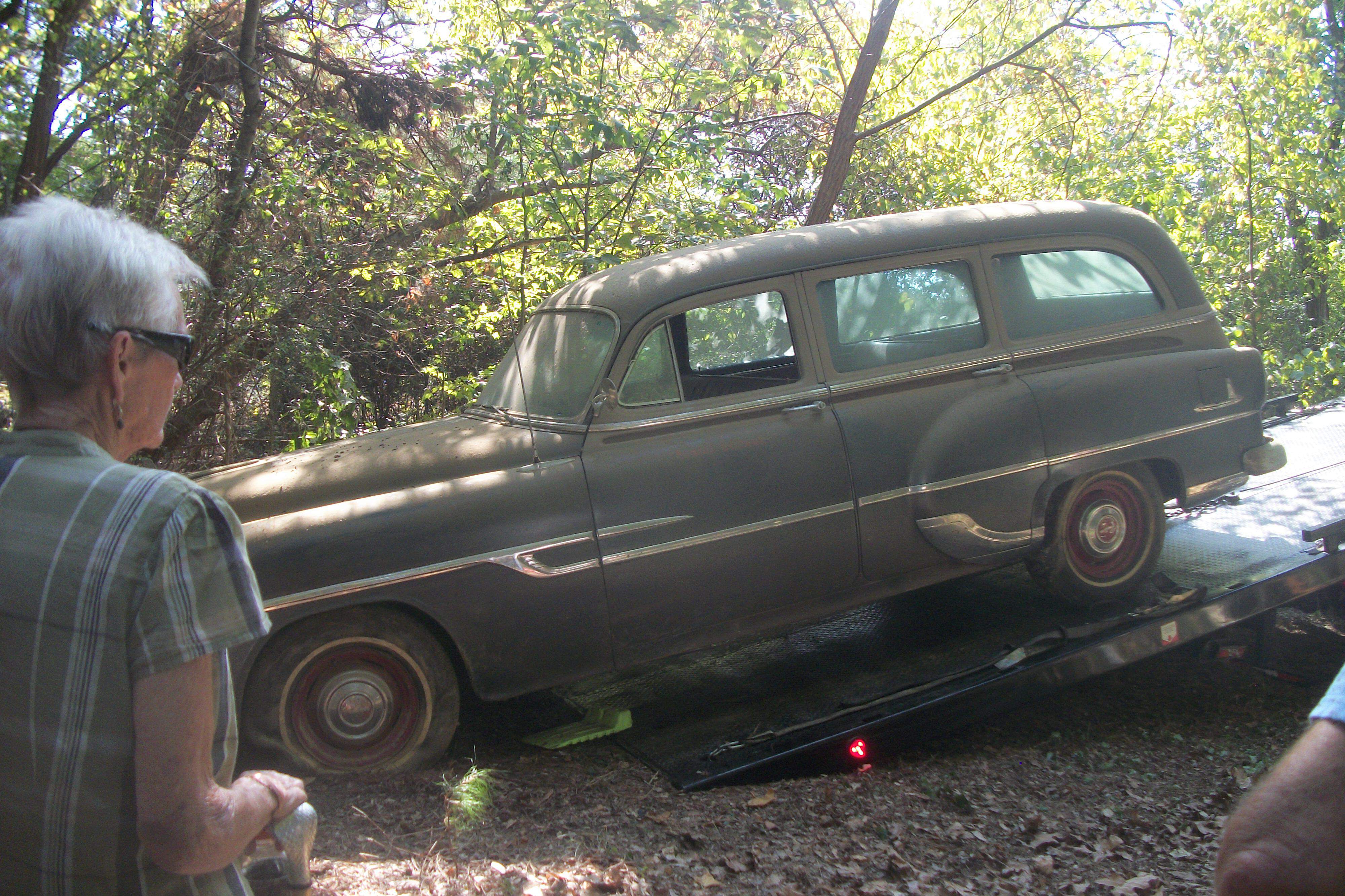

I have just been left a 1953 Pontiac Chieftain wagon that has been in a barn for about 25 years, we hauled it out and the straight 8 is locked up, will a 53 Pontiac 6 bolt in ?  The 6 had a 3 speed and mine has an automatic. We have tried to free up the 8 but have had no luck.

Awesome ride....WOW.   I would love to work on that project.
WOW WEE! Now that is COOL 😎 Welcome aboard and thanks for saving that Ol Pontiac 👍
