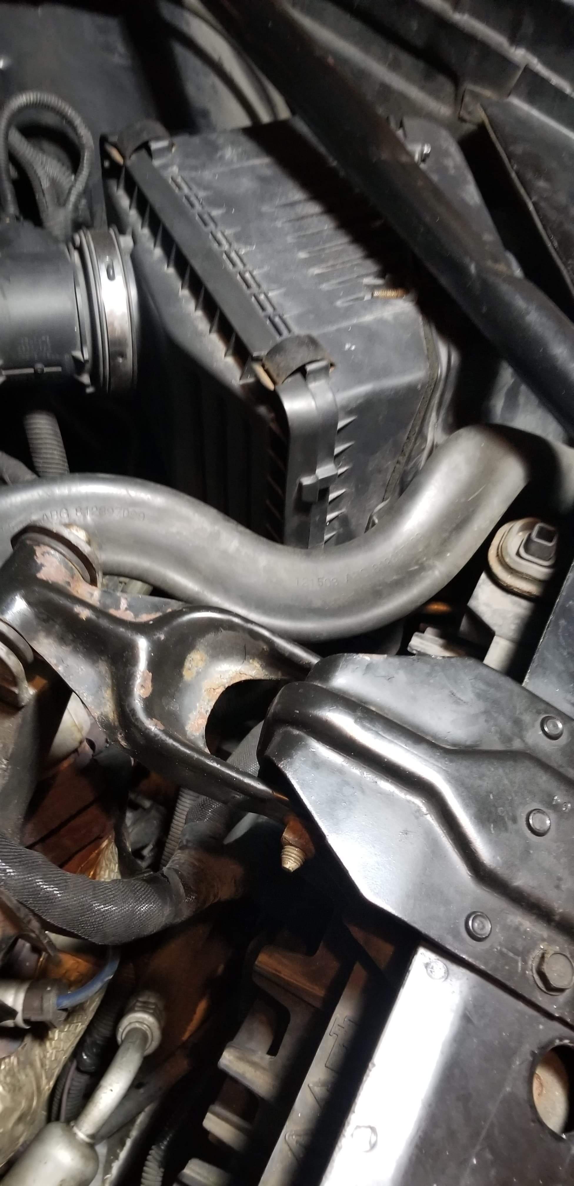

As far as a thermostat goes, and the radiator hose being sucked closed..
He said the thermostat was stuck open, so he just removed it and it would be fine to run for a few weeks since its cold out. Is that true?  Today when I ran the car for a few minutes to get the video, the hose wasnt sucked closed.. did the issue resolve itself or do I need to run and drive the car to see if it happens again?

I would still think that the radiator cap is causing the collapsed up radiator hose. If you loosen the cap to the first click and drive the car and the hose doesn’t collapse it’s probably the cap. Also the fact that you said the reservoir was dry indicates the cap isn’t working, and not allowing the fluid to transfer back and forth.
