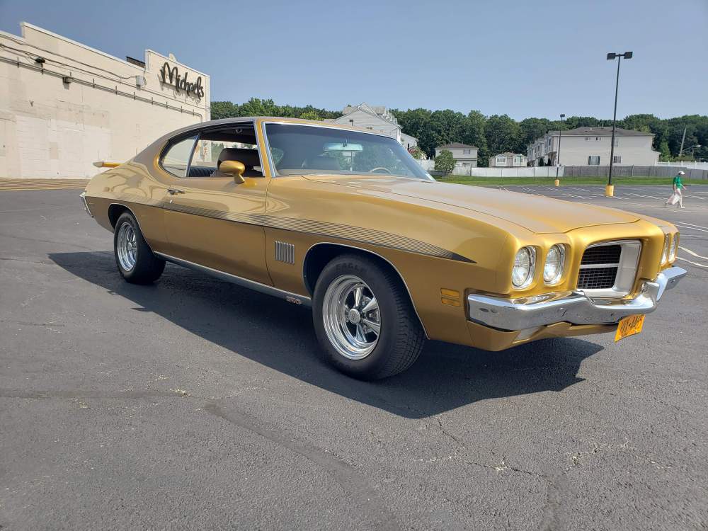

Thanks for sharing a picture of your ride. It reminds me of my older brother's first car, a '71 Lemans Quezal Gold, 350/350TH PS pB no air AM radio bench seat car. Sadly, he didn't take very good care of it either.
