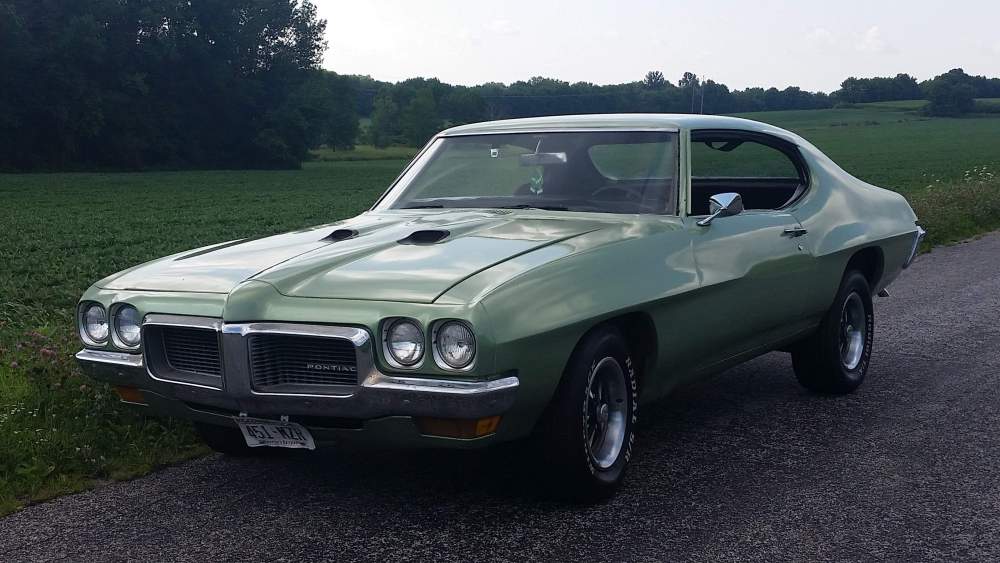

I've got a 1970 T-37 Tempest, which i recently learned through PHS is nowhere near original, so ive decided to swap the motor from a 350 2v to a 455, the 455 i purchased came with a TH400 attached, but is from a 1970 bonneville. The T-37 as of now has a TH350, So I guess my question would be what would need to be changed, if anything, to put the bonneville TH400 into the Tempest or would the TH350 handle the stock 455?
