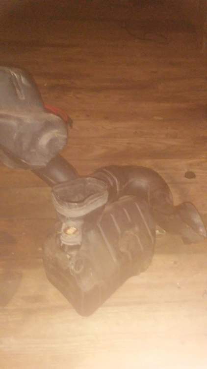

Talking about cai stuff.....( I just added 25hp to the car by removing this crap in 15mins or less). Look at this crappy piping stuff. Like forreal who makes this stuff haha.  I have a feeling by removing this from the fender well i will get better MPG. What you think two lane and frosty????  The air box still leads to cool air side btw
Edited by Lynn5907
Sadly the OEMs do. They are in a constant struggle between the EPA (for overall vehicle emissions and MPG), vehicle performance, under hood packaging (e.g. any spare space in the engine compartment once the basic engine/transmission/suspension is installed),  under hood noise that might transfer to the cabin, hood clearance, time, and cost. This struggle does not lead to "pretty" designs most of the time.
CAI manufacturers have the luxury of taking an OEM air intake design and improving upon it without the deadlines that producing an overall car requires. If it takes six months or ten months to develop a new CAI for (say) the 2019 Chevy Camaro ZL-1 - so be it. GM and other OE manufacturers don't have much luxury to beautify many of their designs. CAIs do.
Well put. Was not even think of that side of story. Will say my MPG went up 2-4 MPG on HW. Also seems to respond to my input just a tad smoother as well. Crazy thing I when in there to find a leak for the windshield washer rez. Seen that n was like hell na.
