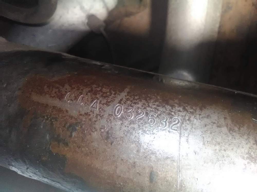

I have  rear end with numbers cca0326B2 was wondering if someone could give me any info on it thanks allIMG_20180808_105226.thumb.jpg.8298e6f698a5b96f8ab601acecc5042e.jpg
Still working on the "CCA" portion.
0326B2 means it was built on March 26, 1969 (03-26), Buffalo plant, 2nd shift (B-2)

The other number came from the passenger side tube of rear end CCA0326B2
