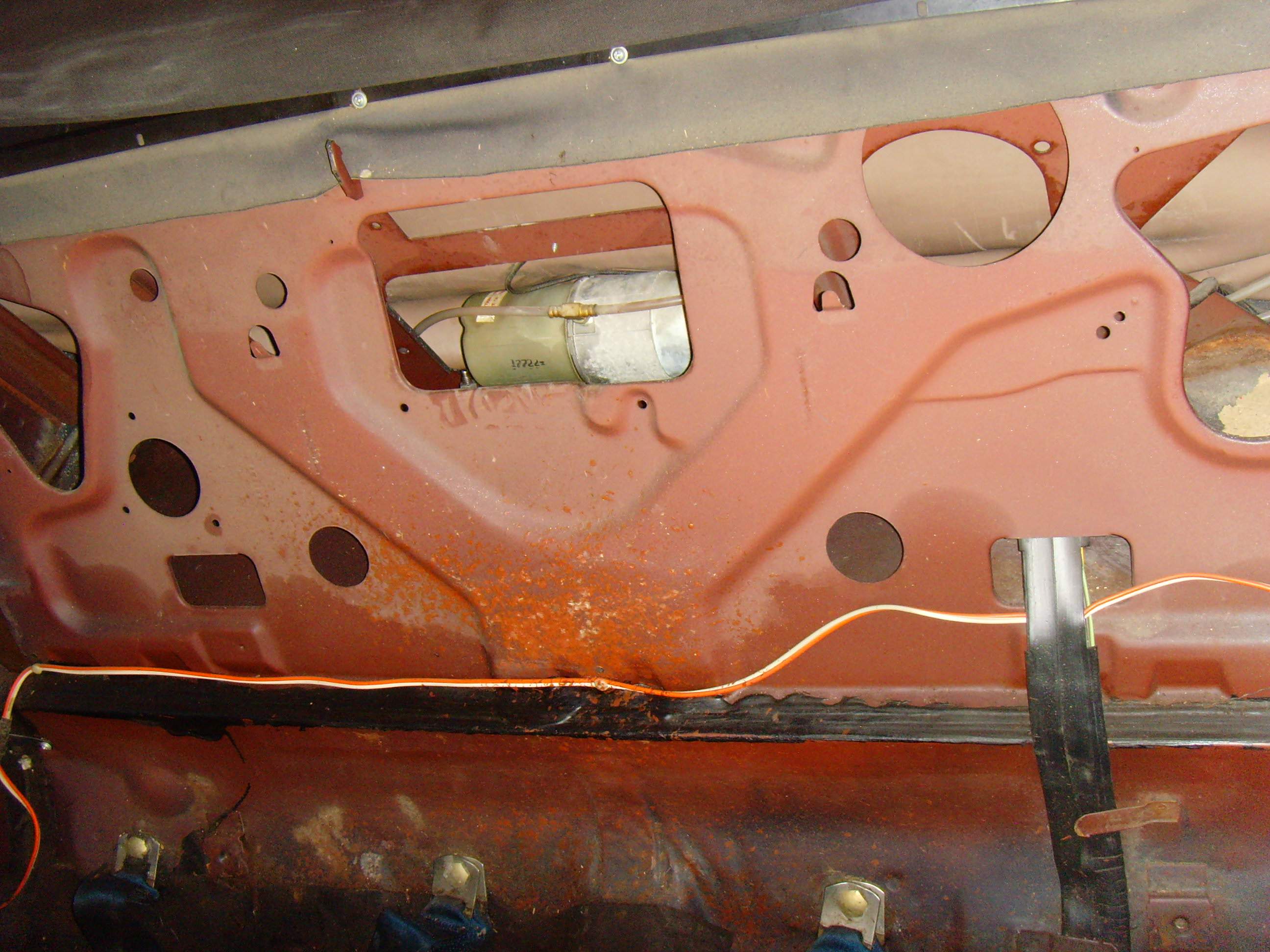

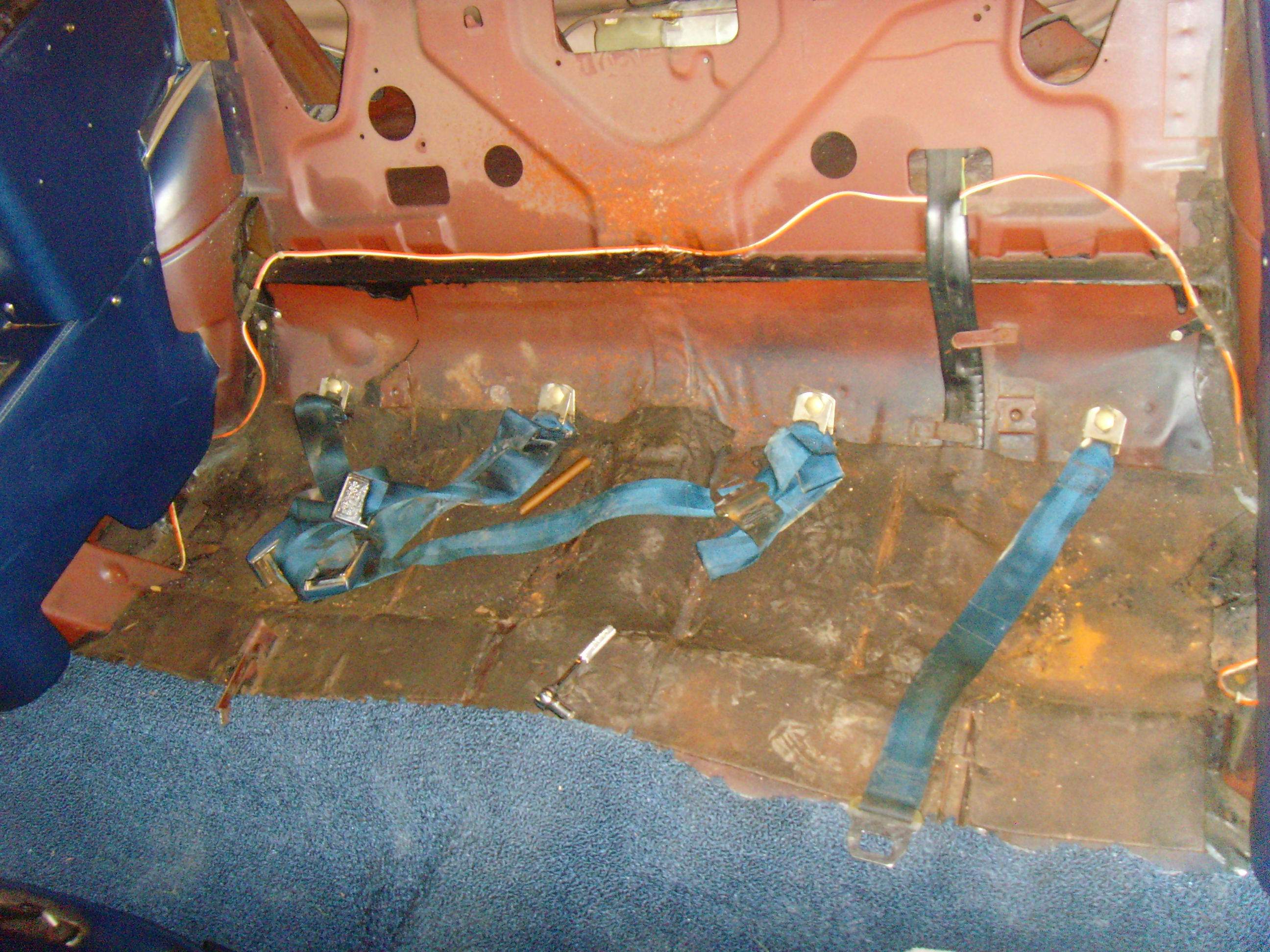

Did a little more research on why the top will go down, but not up & it seems the general opinion is that the switch is bad. I pulled the rear seat completely & no leaks that I can see. Should I try a new switch, or do you have any other suggestions?
Thanks
Sometimes it takes a moment or two to build pressure for it to go up. You should not have to pull the plug in order to do this.
Still check under your back seat for fluid leaks.
Now lets assume for the moment that you have no leaks, then you might have an electrical problem. Its possible that either the switch or the motor is failing. You can test the motor by disconnecting the switch underneath the dash. Just disconnect the red/green connection. That provides current to the motor for either up or down. Apply power to either the red or green circuit going back to the motor with a 12V source like a power probe. Test both circuits. If you hear the motor run both ways, then you know the motor is fine and the problem is most likely with the switch.

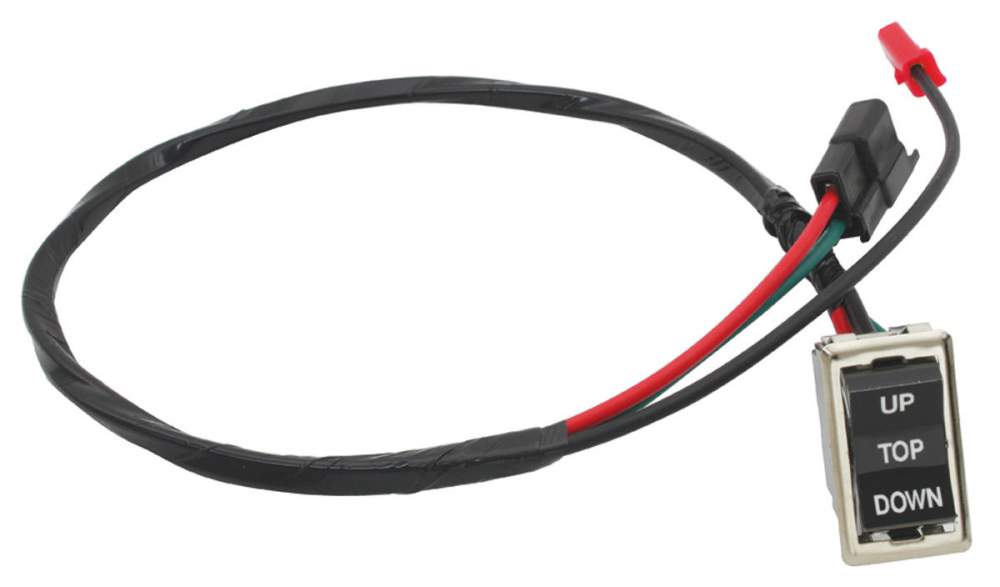

I tried reversing the wires from the switch to see if I could use the down button to make it go up & nothing. My co-worker's Dad is coming to check it out. (Me & electricity don't get along). He used to work at a Pontiac dealer in the 60's & 70's, so he should know what he's doing. I talked to him & he is 90% sure it is the switch, though.
If that is the case, how do I remove the switch?
That's the fun part. It's tough. The switch is held in with a retaining clip that is on the front of the dash and clips or screws in (I can't remember which) on the back side.
You will need to remove the air ducts under the dash in order to squeeze your hand up between the steering column and the dash to feel behind the switch (expect to scrape your hand once or twice too). You should be able to determine by feel if it is screwed or clipped into the dash. Obviously you need to remove the retaining clip by whatever means necessary. Next follow the wires around to the two connectors -  the two-wire motor connector and single-ground wire and disconnect them. With the switch clip removed and the switch free from the dash, pull the switch out towards you into the passenger compartment.
Install the new switch in the reverse order. The new switch should come with a new retaining clip.
Before installing the switch for good, double check the electrical connections first and make sure they fit fine and everything works properly first by testing the new switch and see if the top goes up and down.
If this procedure doesn't work getting the switch out, then you have the pleasure of taking the dash apart.
I can lay on the floor a look up under the dash. I can see where the remote is. It looks like it is clipped in. (I cannot see any screws). It doesn't look like I have to remove any duct work. I can follow all the wires from the remote. I looks like my only problem will be figuring out how to get the rear clip off.
I bought a 3-way toggle switch, just to see if I can wire it up to see if I can work the top with that, so that I know for sure it's the switch before I remove it. I probably won't get to it till later next week. Going for a long weekend vacation. Then I a selling at a local car show next weekend. Busy week coming up. I will keep you up to date when a get a chance to work on it.
hooked up the toggle switch, did the same thing the original switch was doing. Motor works going down, but not up. I even tried reversing the wires & did not make a difference. My co-workers Dad never showed up.

Got the new switch, put it in & it works, but I can only push the switch  for approx. 20 seconds or it keeps blowing fuses. I do hear the motor both ways. would you say that something is stopping the top from going up, maybe bound up somewhere?   I even tried a 30 amp fuse, but it blew that as well. Thanks for any help.
