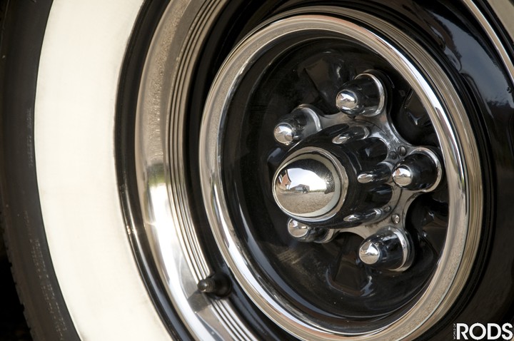

Leaning toward stock. I did consider Chrome with baby moons but not to sure . probably just steel wheels I can look for period correct full hubcaps
If you're sticking with stock steelies, spider hubcaps with chrome trim rings is a classic custom look.
