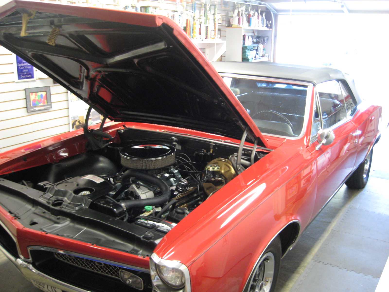

We did add a catch can just to be sure we were not loosing Fl and did have to go back in to correctly clearance the WP divider plate.
Keep driving/enjoying her, but keep an eye on it.
Cheers
