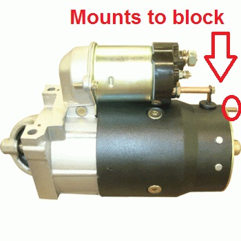

ok here is a silly thought could the starter be overheating due to the headers on the motor? I know some of my questions seem really silly to some but I am learning, hehe and thank you for not abusing me to bad....
Yes, Pontiac engines can have heat soak issues. You can fab up or purchase a heat shield for it. Some guys will purchase a hi-torque mini-starter rather than use a stock replacement because of the wrap around nature of Pontiac headers to the starter. Check around to see if anyone in your area has a hi-torque for a Pontiac, otherwise Jegs or Summit will have what you need. I sold my hi-torque starter to Indymanjoe. He loves it.
This is just a generic starter from a parts store(the new one). I doubt it is a heavy duty starter. I should probably order one from OPGI or Summit? Any recommendations on a particular brand or company to buy one from?
The car didn't shake it just sounded like a metal on metal sound when I tried to crank it. And looked underneath and found that the starter was broken.
I would just check with your local parts counter and ask them if they have a heavy duty starter rather than the generic one. A lot of places still carry them or that is the only one for Pontiacs that they do carry. Use OPGI or Summit as a last resort for a stock heavy duty replacement, the weight will be murder on shipping costs.
I know the Chevys are prone to the heat soak of the starter motor with headers. This could be the issue as well for the Pontiac. I know a couple people who have adapted the heat shield off of a 73-87 GM truck for their GTOs
I have had heat soak issues with Lucy in the past. A heat shield definitely a good idea and rather inexpensive insurance, especially with the wrap around nature of headers on Pontiacs around the starter.
Good morning notallthere, I tired to start the Pontiac this morning and it crank and started no problem. That might be the problem. I appreciate the advice. Ill check out and see if any junk yards have it. Ill look around and see if we have any laying also.
That is typical of a Pontiac when it cools down, it starts with no issue. When it gets hot and then it starts hard or won't start at all until it is cool enough.
