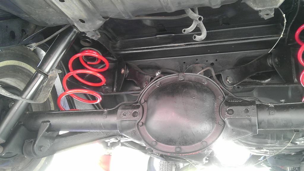

Here is the ad and the pics in the ad:
1971 Pontiac LeMans sport 400 freshly restored. It has a rebuilt/built 400 motor with tons of billet accessories and power. Rebuilt 400 trans/B&M shifter/ MSD ignition. All rebuilt suspension and brakes, also has front and rear drop springs, front sway bar, and power dick brakes. Long tube headers with 3" inch exhaust, Centerline wheels front:15x8 rear:15x10 with BFG's. Body is straight with absolutely no rust and has been freshly painted white( the right way, car was completely stripped for body work,paint,and restoration) . Bumpers, handles, and all the moldings were powder coated to match the paint. New interior with bucket seats and 4-point harnesses. The car is really clean and has a really aggressive look,stance,and sound. It is the best classic muscle car you will get even near this price. It is an original California LeMans sport with 400 motor and trans, a/c and heat, and power disk brake car. Have the sheet that shows the car's factory options and from Fremont,Ca. Sacrifice at 12,500 obo, call or text for more info or pics (909)630-2127

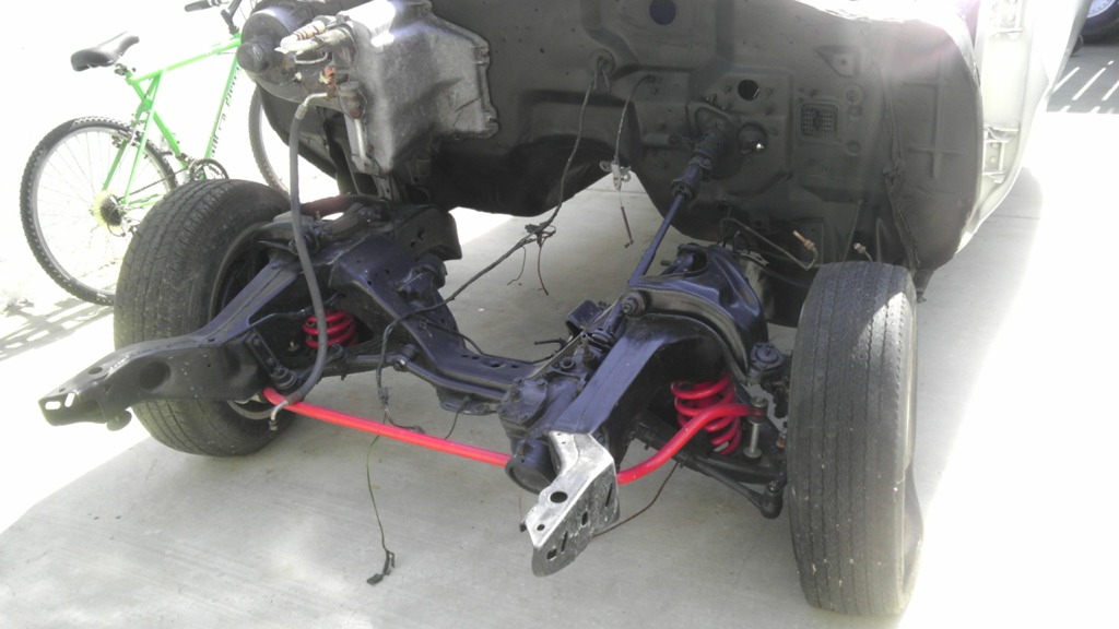

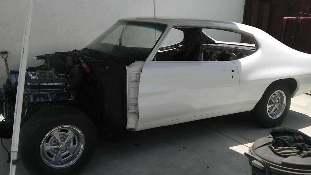

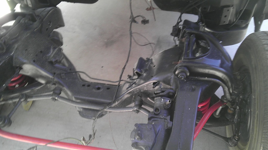

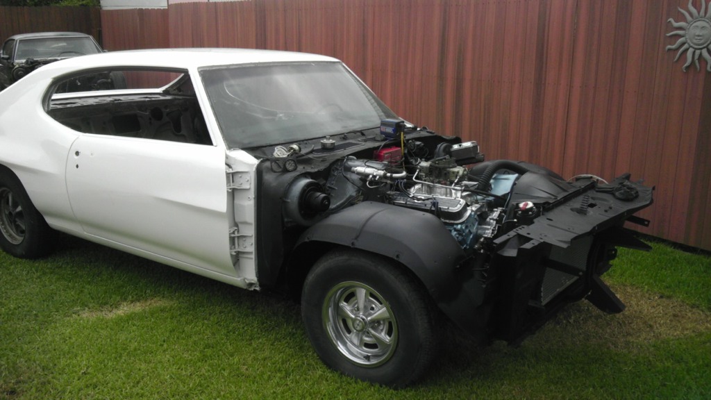

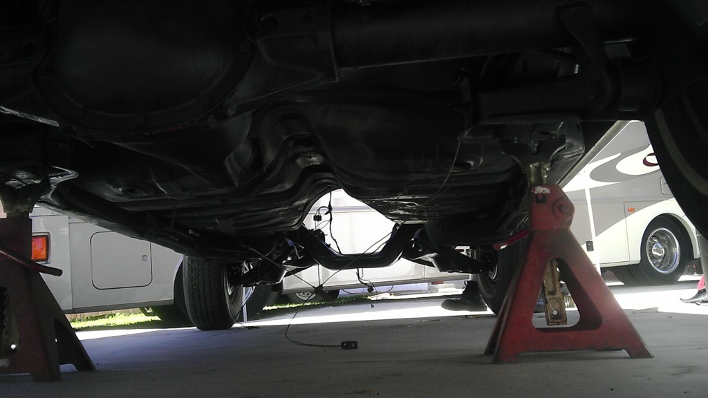

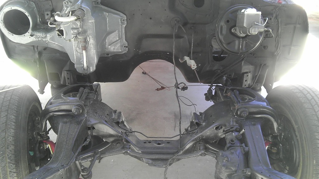

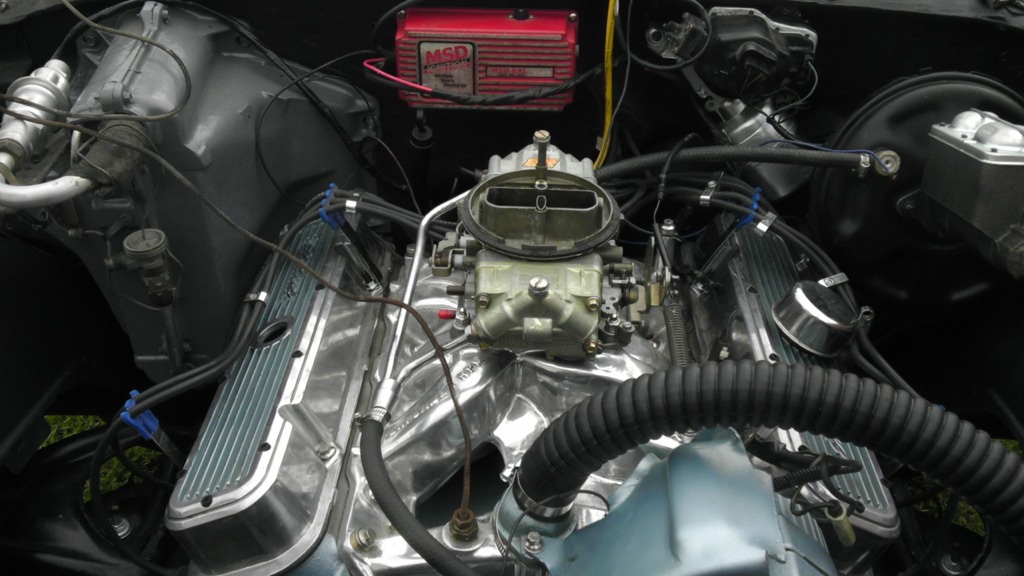

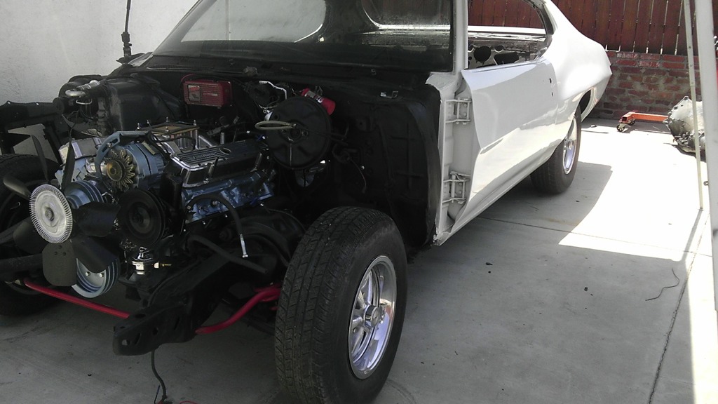

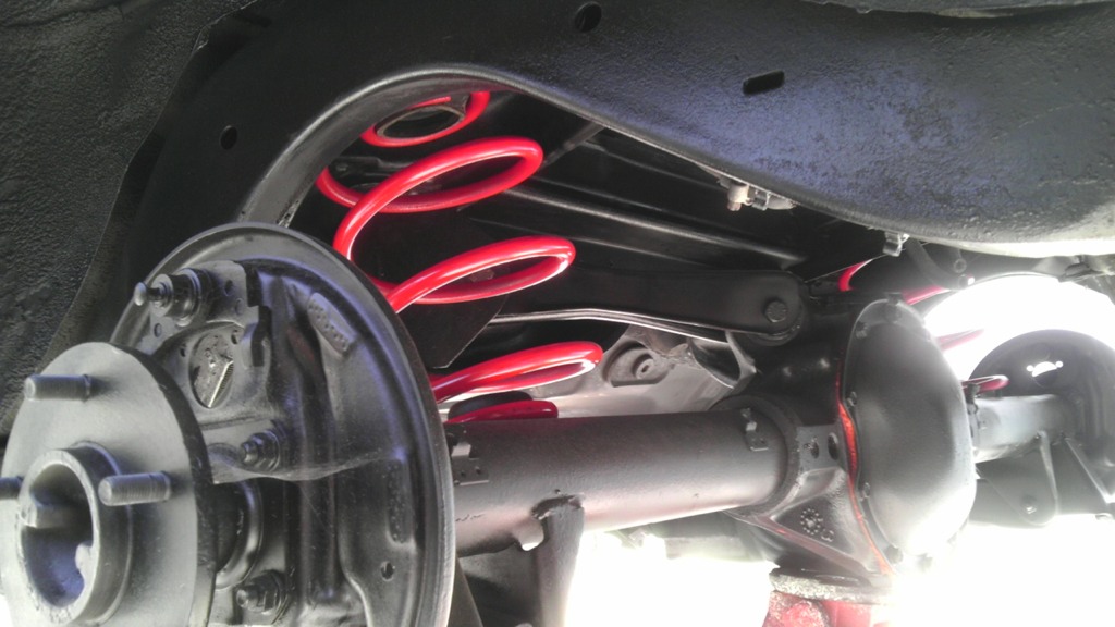

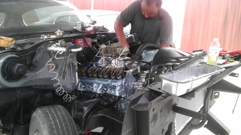

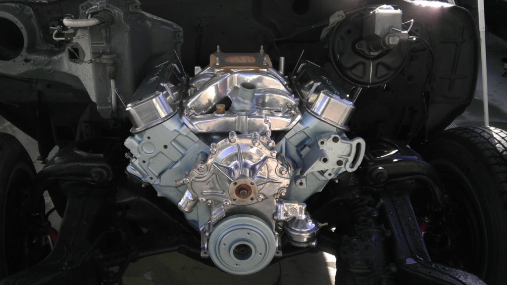

Here are the pics he sent me of the restoration.
Not a bad looking car but in person would tell you more.

I figured as much, I plan on taking a look at it for sure.
