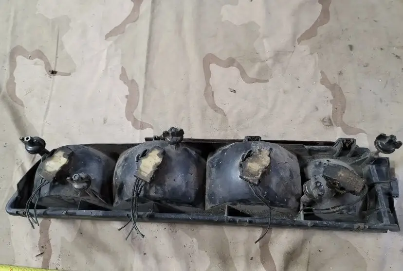

We all here that one. $$$ Pretty strange about the extra tailights. I'm of no help here. Do the mounting studs still line up?

There are 2 odd lights on the "blacked out" (T/A specific) tail lights compared to the red regular Firebird tail light assemblies. The extra sockets are same as side marker sockets (various part numbers by mfg'r), bulbs are 194's. The T/A assemblies have the same studs for mounting.
The car is incomplete, doesn't have a battery so I don't know if the little 194 (5w?) bulbs will look odd against the other 1157's.
These aren't my pictures, btw. Upper is regular firebird, lower is T/A.
