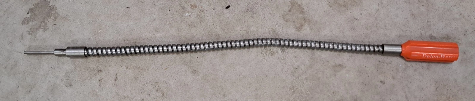

Delco-Remy mechanical/flexible points adjusting tool.
APB: Forever Pontiac Forum Contributors
My 421 Super Duty still has mechanical breaker points.
Setting the Dwell to 30 with only an Allen wrench is difficult, and fraught with shocking danger.
Full Disclosure: I had a bid on the one OEM tool pictured, but I was out bid on E-Bay.
A day and a half on the internet searching for a suitable solution to this vexing problem has yielded zippo!

Could you use an Allen wrench socket connected to an extension and a rubber coated socket while wearing mechanics gloves? Say a 1/4” drive?
What about a 1/4" drive flex extension? I would think it would work and should cost more than $10- $15.
Thats what i was thinking too cheers
I have always used an Allen wrench, with rounded ends to help hit the hole and never had a problem. It is 2025 and you could simply drop in a Petronix module and be done with all the points related issues. It's what I run in my 421.
JUSTA6: PERTRONIX is Planned, which version do you recommend and use on your 421 ??
Clutch Cargo
