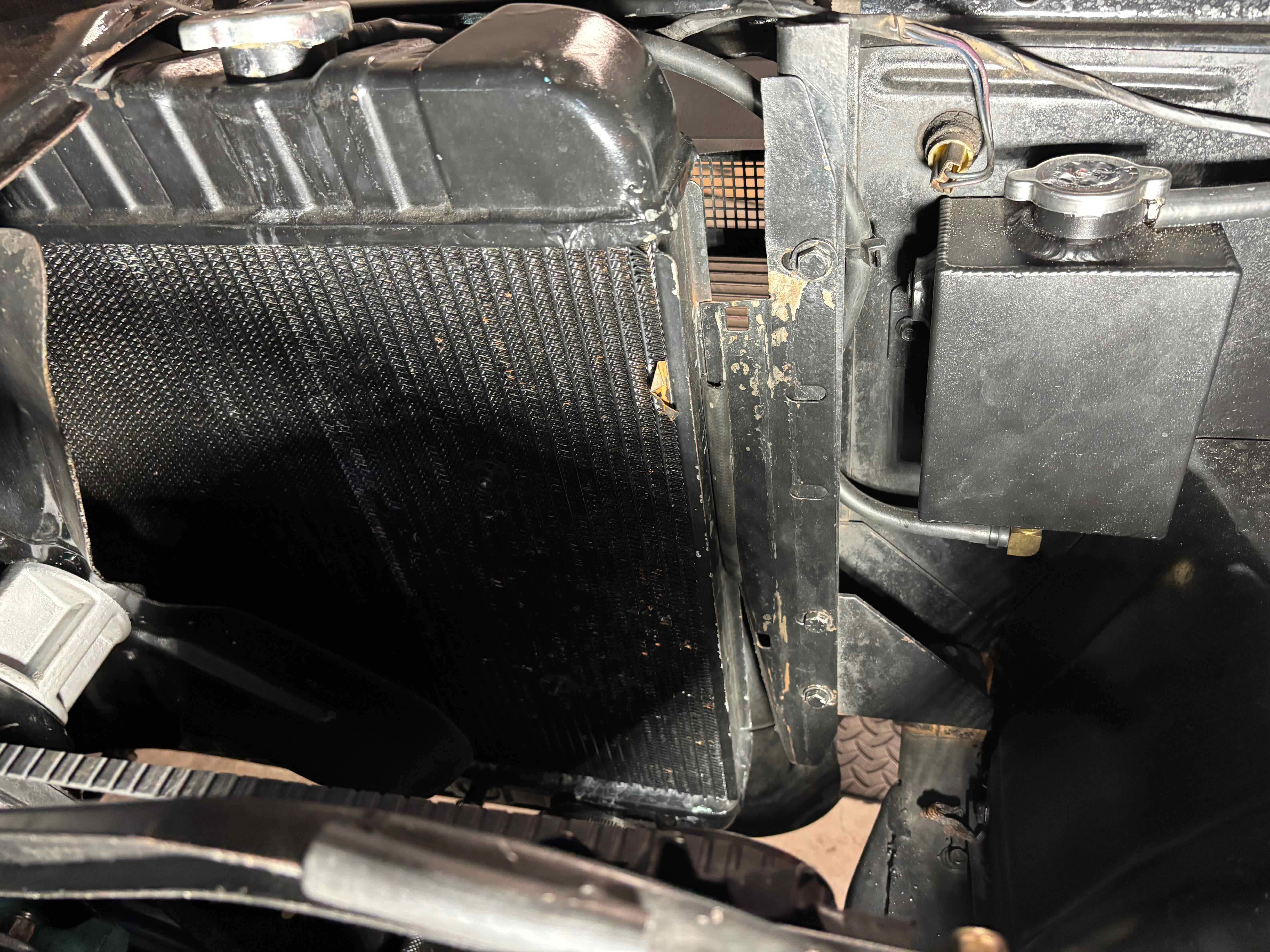

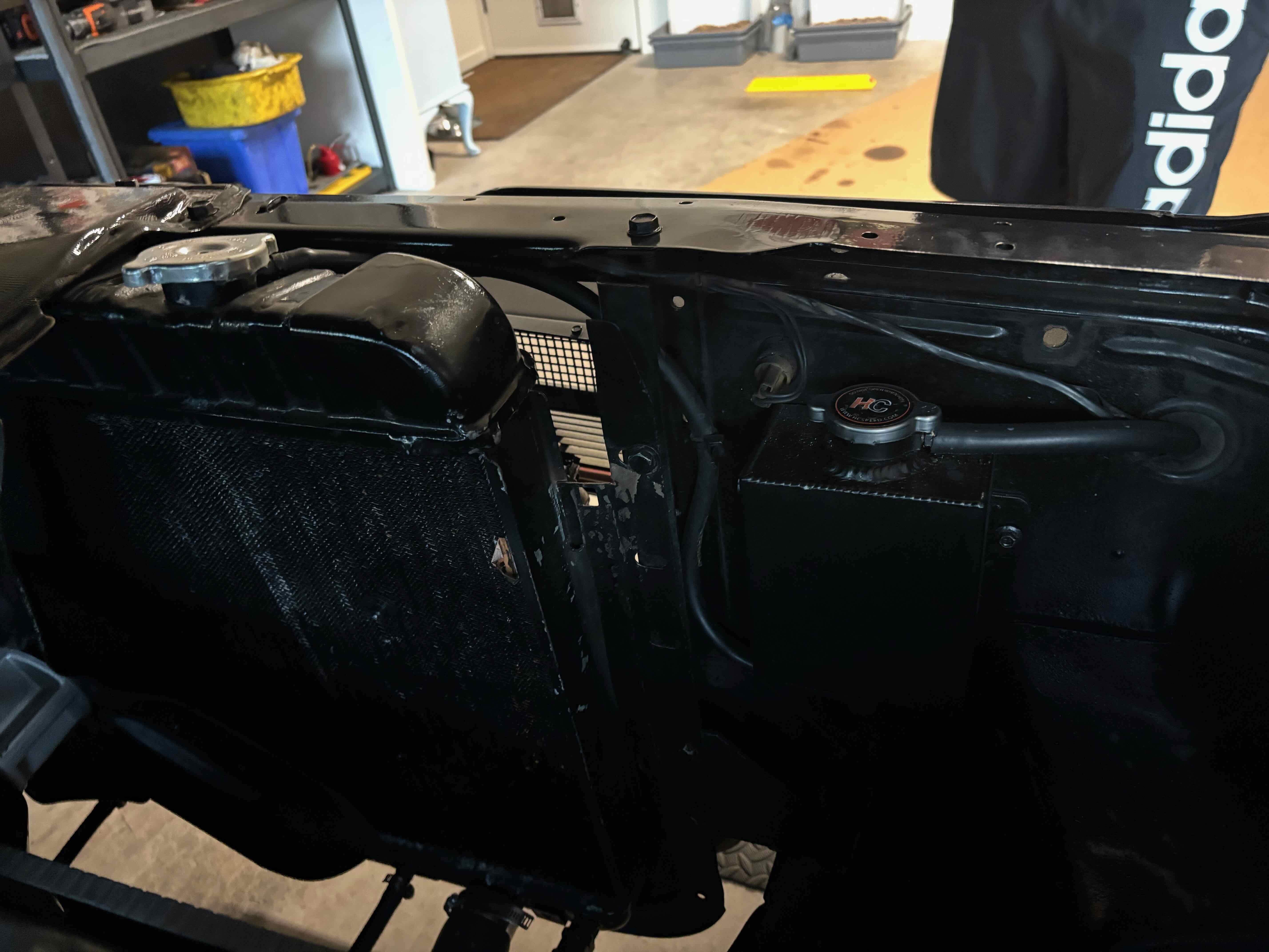

1. Built a coolant recovery system for the car. Bought a black aluminium tank from eBay, and with a handful of fittings, some hose and a bit of imagination, success was mine! Coolant loss is now negligible (add a bout a cupful every few thousand miles, unlike prior when I was going through about ½ litre every few drives 👏

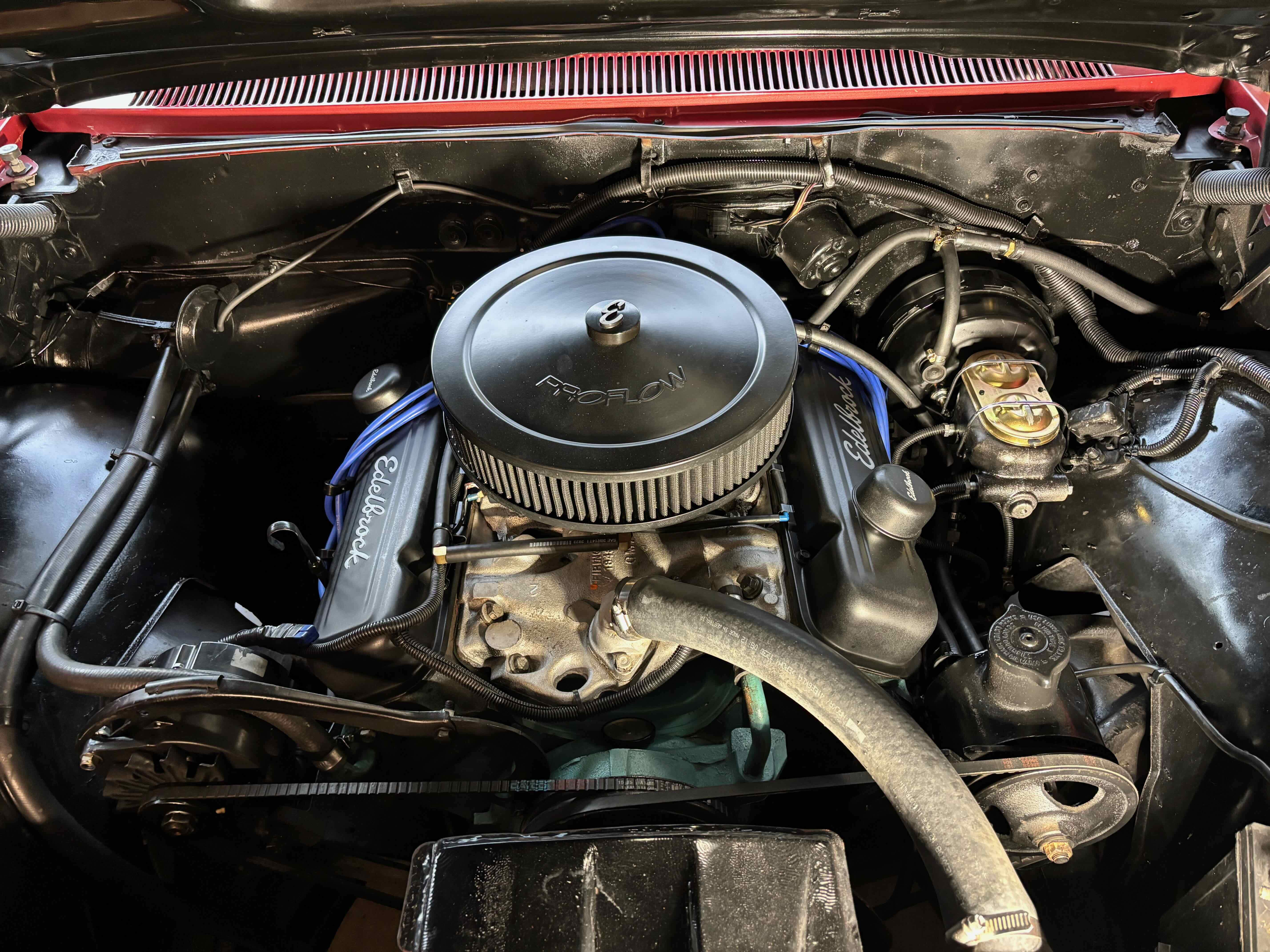

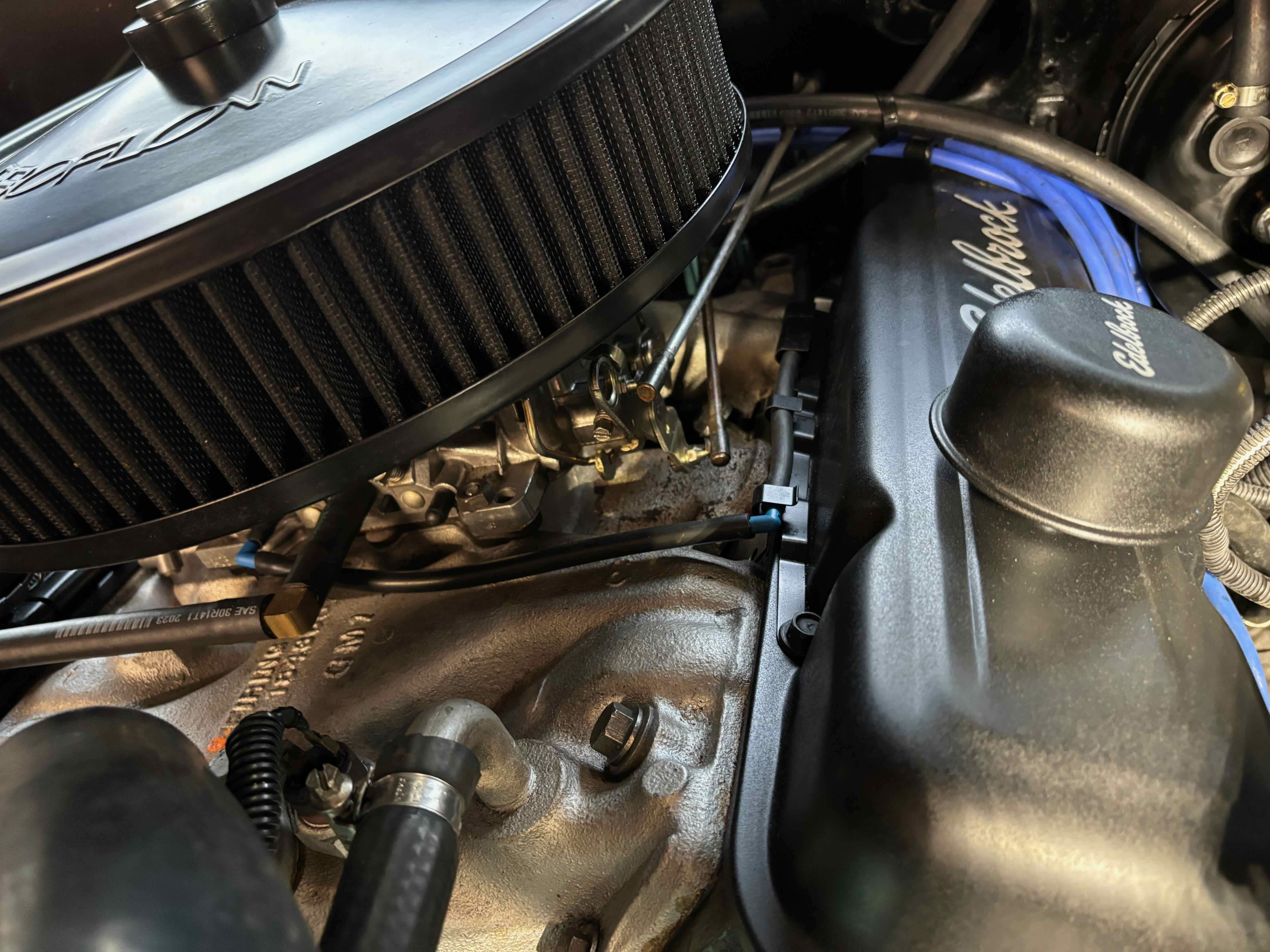

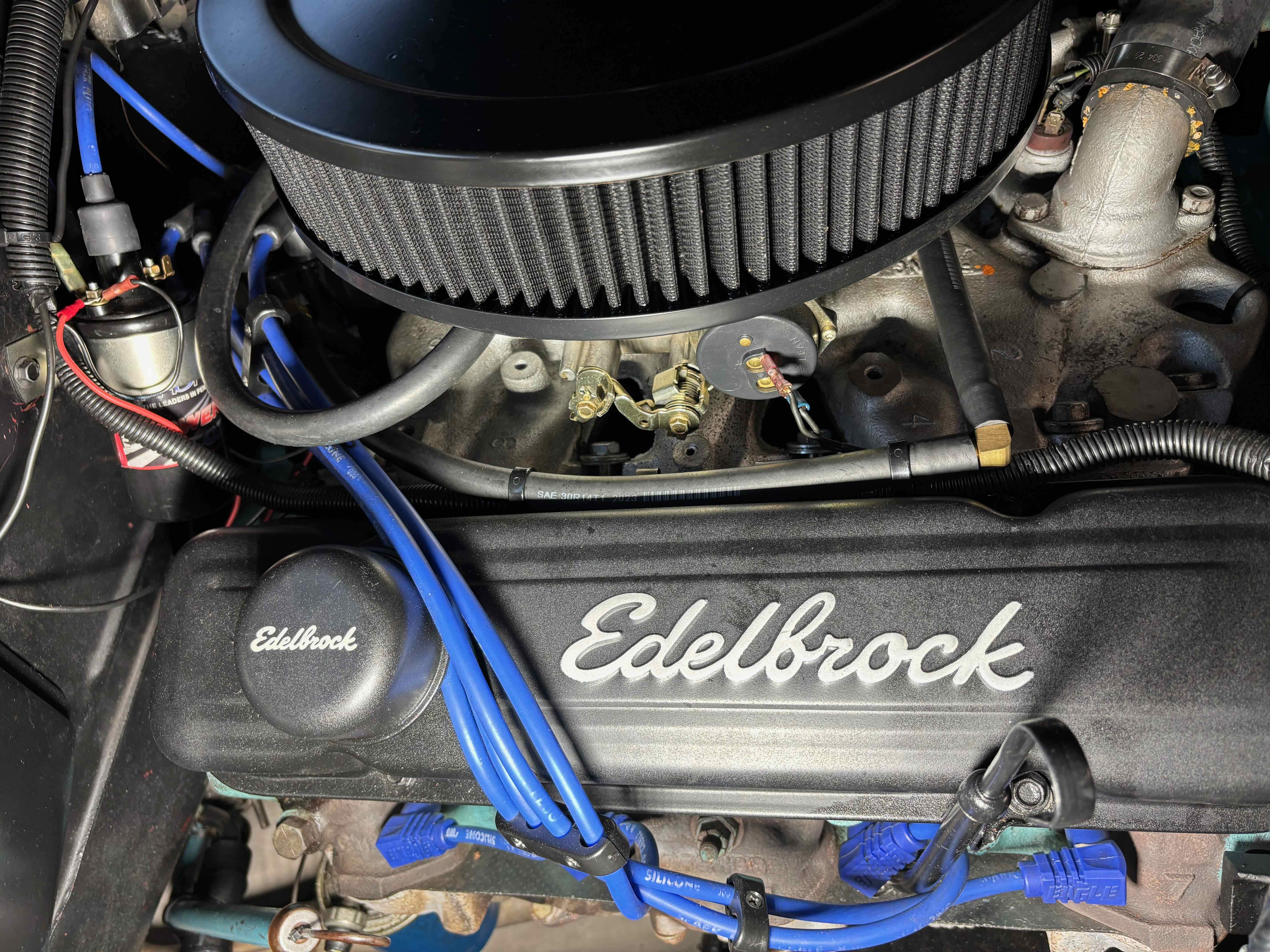

2. Put together a home made pcv system - fantastic. No more oil seepage from the filler caps, no more oil vapours, no more oily smells in the car, especially when cruising on a hot day 🤙

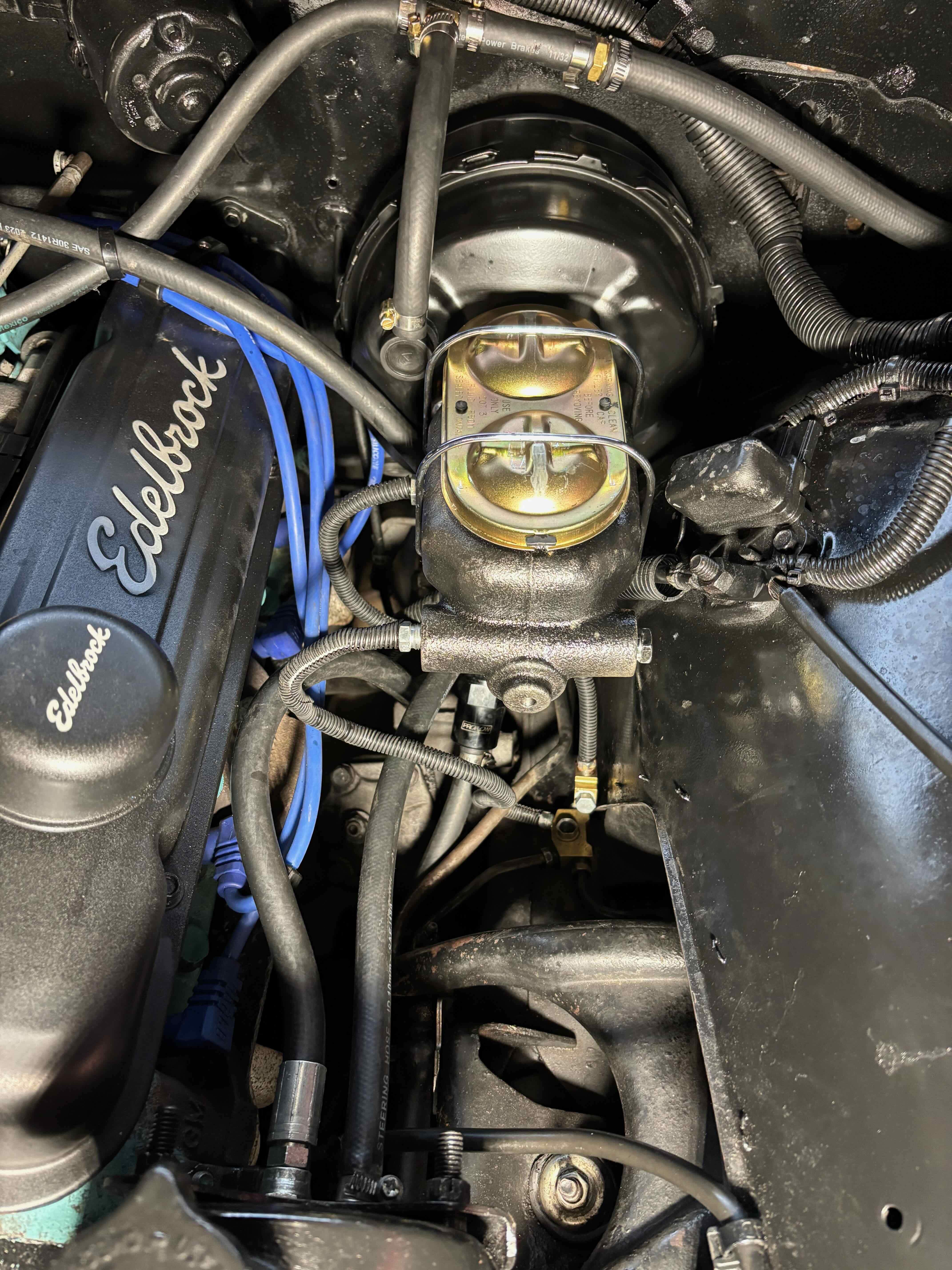

3. Finally (it's taken me almost 12 months to get this done, for a few reasons), had a dual master cylinder and booster upgrade fitted. What a difference - the car stops a lot better with much less pedal effort, and when you stomp on it - damn it pulls up. May not stop like discs, but I'm very happy with the outcome. And, I now have some redundancy in case of any issues. When driving around normally, the car takes hardly any more effort to pull up than most modern cars, which is very surprising 😎

Update - adjusted the brakes today and took it out for a proper test, as by the mechanic who installed the gear. Decided to leave my usual passenger at home for the experience. She's never been a fan of my BLAT approach to braking on a motorcycle - pretty sure she'll hate it in a 2 ton car 😁
Damn, it stops hard! With an whole lot less effort too. @fitzy, you should get yours done...especially if you foot is still floppy 🤣
